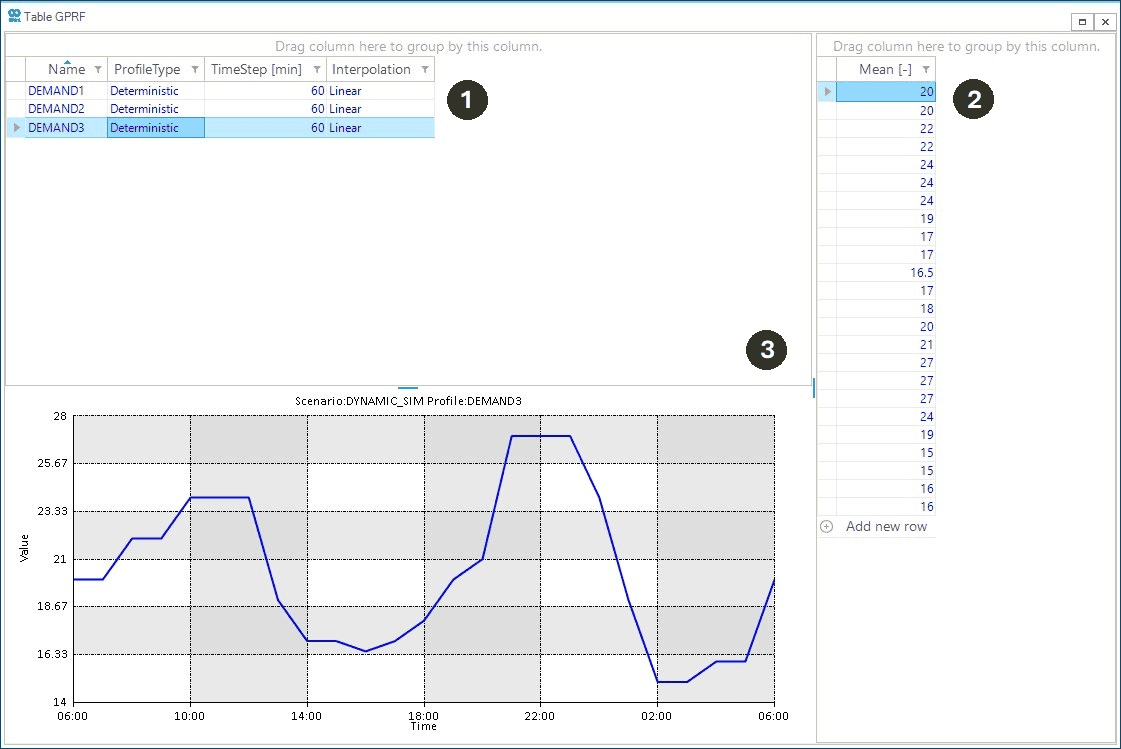

Let’s start by opening the profile table by going to the scenario tab and selecting GPRF. The profile table is divided into three main sections, as shown in Figure 1:
  • Profile description table (❶): this section allows the user to see and edit the properties of the profiles. You can edit the profile name, type, and time step. Additionally, you can directly create and delete profiles for the scenario file.
  • Profile data table (❷): this section displays the time series data points of the currently selected profile (highlighted in light blue in the profile description table). Here you can directly edit the profile by changing, adding, or removing any cell of the profile data series. The column Mean must be filled to define the profile’s data points. Here the term "Mean" does not imply the concept of average, because you are using deterministic profiles. So, it is just a name for the column. The column Deviation (available by default but hidden in Figure 1) is only used for stochastic profiles.
  • Profile chart window (❸): this section plots the values of the profile data points against the scenario time window to visualize the dynamic behavior of the currently selected profile.
bt01 step07 01
Figure 1. Profile for the object GDEM.DEMAND3 in the profile table.

We will now create the profile shown in Figure 1. Go to the profile description table, right-click in any empty spot and select Create Profile. A new profile will appear, and you can now edit the profile properties. You will use the default properties for all your profiles but edit the profile’s name. So for your first profile change the value in the Name column to DEMAND1.
2.1. Enter and visualize profile data
By default, you will notice that when a new profile is created, you have only two data points set to a value of 1. Now, you can edit the profile data points in the profile data table (❷ in Figure 1). Under the column Mean, enter the corresponding data points for the DEMAND1 provided in Table 1.
You can edit profile data points manually by selecting the desired cell, then overwriting the value and pressing Enter to save the new value in the cell. Press Down to select the following row and repeat the process. However, once you add new data points to the profile data series pressing Enter will automatically jump to the following cell.

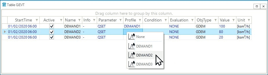

3. Assign profiles to events
Move back or reopen the event table. You can select the tab "Map1: GNET" from the map window or the scenario tab by clicking on GEVT. Now you can associate events with profiles. Hoover the cursor over an empty column Profile cell and right-click. From the context menu, select the appropriate profile for the event, like in Figure 2. Proceed to match all events with the associated demand profiles.
bt01 step07 02
Figure 2. Assign profiles to events in the event table of the scenario.
