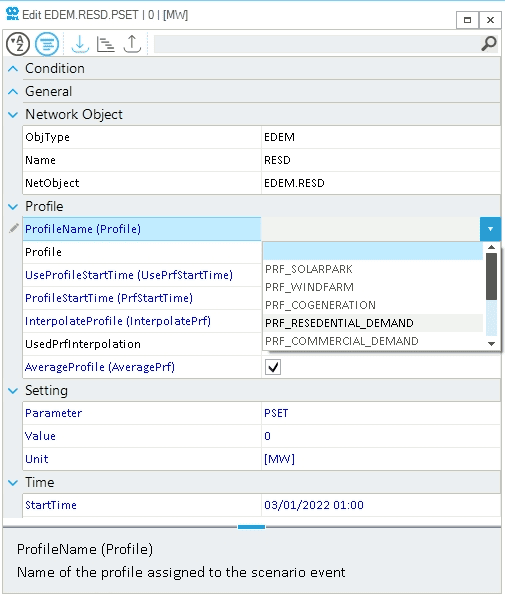

1. Assign a profile using the property editor
Profiles can be assigned only in scenario mode. In addition, a profile can be connected to any event characterized by a value during the event’s creation or later. In the first case, immediately after the creation of an event, the property editor pops out. Click on ▼ to access the drop-down menu of the ProfileName property and select the profile as shown in Figure 1.
assign profile event 00
Figure 1. Assign a profile using the property editor.
Similar to network objects, the event property editor viewed on the right-hand side of the screen by selecting an event via the model explorer or the event table. If the property editor is closed, right-click on an event to open the context menu and select Open Editor.
