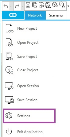

The data provider can be accessed by opening the application menu. Click on home button 00 as shown in Figure 1, and go to Settings  Data Provider.
connect weather data 00
Figure 1. Data provider settings.

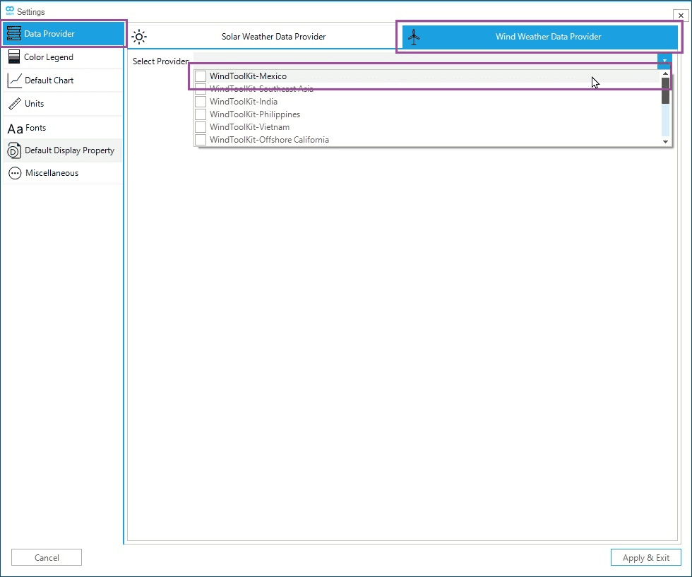

The data provider window allows selecting one or multiple data provider(s) for solar and wind. Use ▼ to see the list of data providers. Check the data provider(s) that will be used in the project (they can be modified at any time) as shown in Figure 2 for wind. While for NSRDB and WIND Toolkit a registration to the NREL webpage is required, for PVGIS no registration is necessary.
connect weather data 01
Figure 2. Select the data provider.

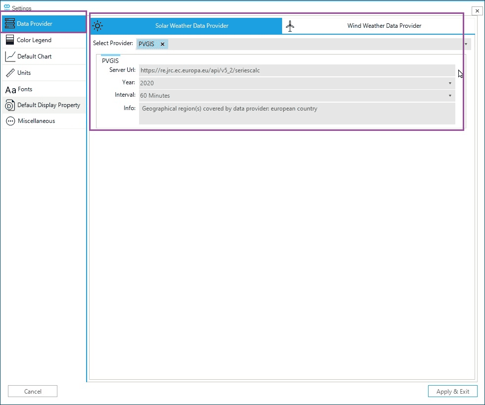

Select the PVGIS data provider under the solar weather data provider section. Check and modify — if needed — the value of the Server Url field. For the default API entry points you may check the file "DataProviderURL.txt" in the installation folder …​\encoord\SAInt-v3\DataImport\Others. Customize the other properties based on the project needs.
connect weather data 02
Figure 3. Edit the data provider options for solar weather data.

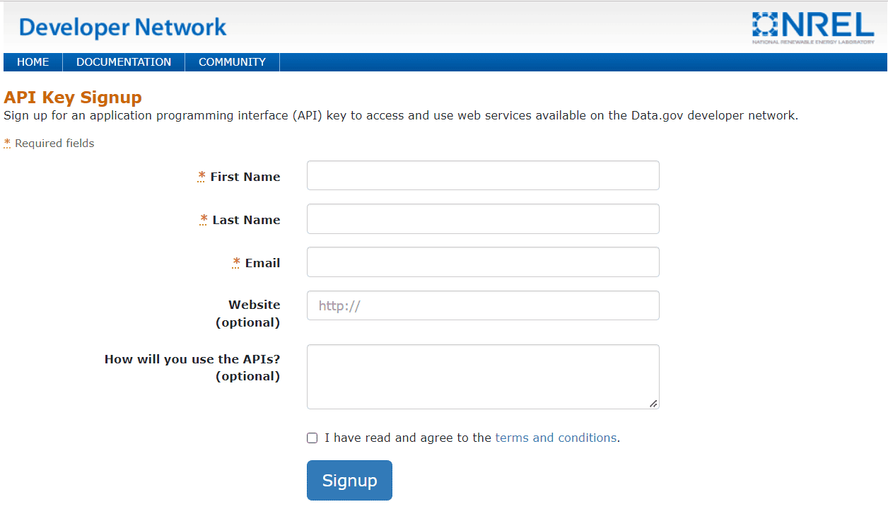

Differently than PVGIS data provider, login credentials are required for NSRDB and WIND Toolkit. The same credentials work for both providers. The login credentials can be requested at the following website https://developer.nrel.gov/. At this link, click on API Key to access the signup page, as illustrated in Figure 4. Complete the registration to receive via email the credentials (API Key, etc.).
connect weather data 03
Figure 4. Request an API Key on NREL website for NSRDB and WIND Toolkit.

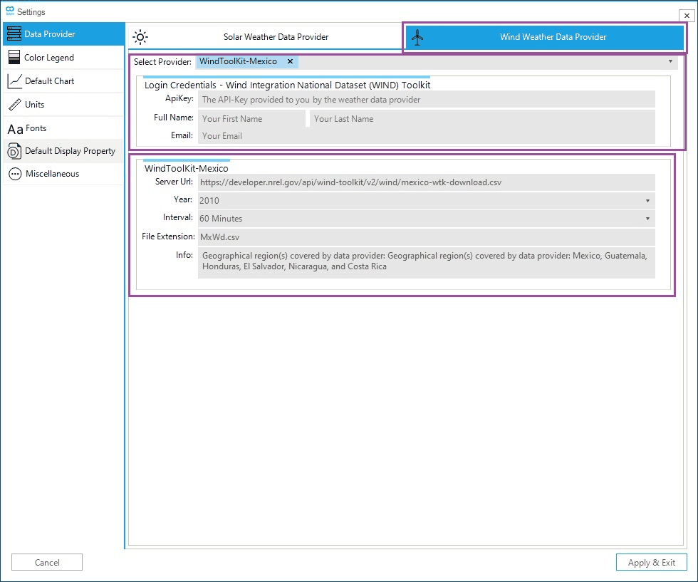

Select any data provider from NSRDB or WIND Toolkit under either solar or wind weather data provider sections. Fill in the login credentials that you received via email. Check and modify — if needed — the value of the Server Url field. For the default API entry points you may check the file "DataProviderURL.txt" in the installation folder …​\encoord\SAInt-v3\DataImport\Others. Finally customize the year and interval,and click on apply to save the configuration.
connect weather data 04
Figure 5. Edit the data provider fields for wind weather data.
