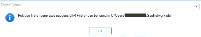

Start the import procedure with (Figure 1). SAInt prompts for the location of the file in shapefile format to be used (i.e., the *.shp file), and, after the selection, it asks for the name and location where to save the resulting *.plg file. A message informs the user of the outcome of the import. When successful, a pop-up reports the path of the newly written SAInt polygon file (Figure 2). Otherwise, a more informative error message is provided. Please, note that SAInt focuses the import on catching the geometry of polygons. Polygons' attributes in the *.dbf file of the shapefile are simply merged as an alphanumeric string and associated with the Info property of the polygon. It is recommended to simplify the *.dbf file so that only one or two fields are available. Finally, remember to check that the units of measure for XY-Coordinates in are matching the units used in the shapefile containing the data.

GasNetwork.plg file.|
