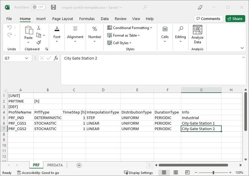

Use the PRF sheet to define the profile properties. Each row represents a single profile. The optional properties of the profile can be filled out as shown in Figure 1. In this example, up to three profiles are defined, but there is no restriction on the number of profiles defined in the Excel sheet.

Use the PRFDATA sheet to define the profile data series of the previously created profiles. The first row indicates the ProfileName(s), the second row explains the type of data points (Mean or Deviation), and the subsequent rows are a collection of temporally equidistant data points. The Mean column must always be defined, while the Deviation is used only for stochastic profile types (PrflType) as shown in Figure 2.
| ProfileName(s) should be equal to those defined in the PRF sheet but written in square brackets ([ ]). |

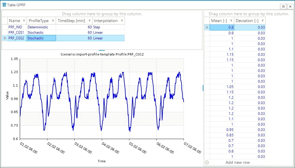

After selecting the desired file, the profile is imported into SAInt and can be viewed and edited via the profile table, as shown in Figure 4. Open the profile table by selecting GPRF to visualize and/or edit the profiles.
| At this stage, the profile is imported but not assigned to a scenario event. Thus it will not be considered in the simulation. |
