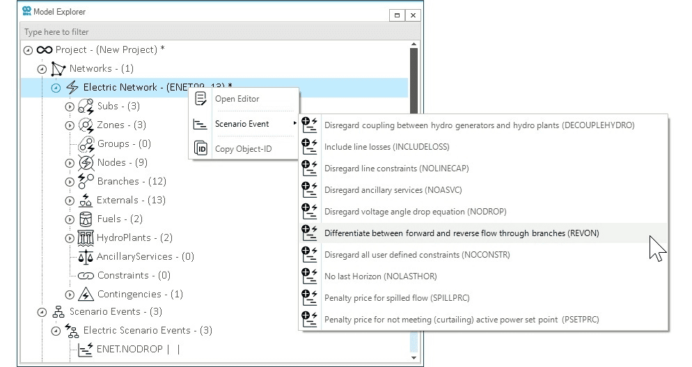

1. Create an event using the model explorer
It is necessary to have opened a network and scenario. Go to the model explorer, and right-click on the desired object. From the context menu, select Scenario Event to access the list of events available for the object, as shown in Figure 1. In this example, the network event differentiate between forward and reverse flow through branches REVON
is selected.

3. Create events for multiple objects
An event can simultaneously be created for multiple objects, as long as the objects are of the same type. This can be done by selecting multiple objects while holding Ctrl (or Shift for adjacent objects) in the model explorer. After having selected the objects, right-click and select the events that should be applied to the chosen objects as shown in Figure 3. For each object an event is created.

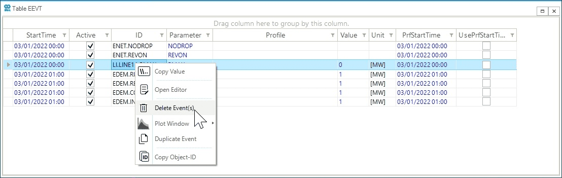

4. Delete an event
Events can be deleted in SAInt using the event table (EEVT). To delete one or multiple events, first select the event(s), then right-click and choose Delete Event(s) as shown in Figure 4.
