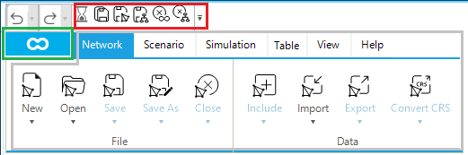

1. Quick access bar
The quick access bar is shown in Figure 2. It contains the buttons of frequently used GUI functions. By default, the quick access bar is located in the top left corner of the GUI. It can be customized by selecting and deselecting the different functions from the context menu. Table 1 describes the quick access bar functions.
| Icon | Options | Description |
Undo |
The bent arrow undoes the last change to a property of an object. The downward arrow lists the recent changes. Only properties of objects can be modified. |
Redo |
The bent arrow redoes the last change to a property of an object. The downward arrow lists the recent changes. Only properties of objects can be modified. |
Execute Scenario(s) |
Shortcut to execute the loaded scenarios. |
Save All Open Network(s) and scenario(s) |
Shortcut to save both active networks and scenarios. |
Save All Open Network(s) |
Shortcut to save all loaded networks. |
Save All Open Scenario(s) |
Shortcut to save all scenarios active in the model. |
Close Current Project |
Shortcut to close the current project. |
Close All Open Scenario(s) |
Shortcut to close all scenarios active in the model. |
Customization |
Shows the list of available options. Checked options are displayed in the quick access bar. The position of the quick bar can be customized by selecting above or below the ribbon bar. |
Multiple changes can be modified at once from Undo and Redo, by selecting a sequence of consecutive changes with the mouse from the drop-down list. The changes are highlighted in light orange. |

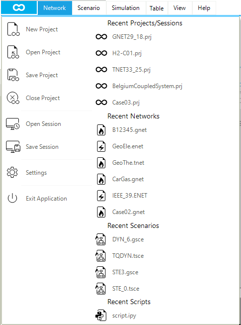

2. Application menu
The application menu is accessible from the button at the top-left corner of the GUI. It is divided into two columns, as shown in Figure 3. The first column contains all the project and session-related options, including access to the GUI settings and file version converter. The second column allows the user to access the recent projects, sessions, networks, scenarios, and IronPython scripts.
A project file represents a hierarchical collection of models, profile files, sessions, IronPython scripts, and polygons. Profiles, IronPython scripts, and polygons allow to manage specific aspects at the project level. A model is a child object of a project, and it is a collection of a network, scenarios, state files, solution files, profiles, project file, map file, log files, and model-related IronPython scripts. In releases prior to 3.4, SAInt had also vertex files and labels files. These objects have been moved to the map file and the project file. At this level, profiles and scripts allow to manage model-related aspects, compared to project-related aspects. Finally, a session represents a snapshot of a project containing the state of the tabs available in the map window area of the dock panel and the state of the loaded scenarios. A session preserves the opened windows (e.g., chart windows, map view windows, etc.), tables, and scripts active at the time of saving the session. A specific session can be saved and reopened at a later stage. The position and arrangement of the command line window, the log window, the model explorer, and the property editor are not saved in a session.
The application menu options of the first column are described in Table 2.
New Project |
Create a new project and close the currently opened project. |
Open Project |
Open a previously saved project. A project file has the extension |
Save Project |
Save the currently opened project to a project file ( |
Close Project |
Close the opened project and the associated networks and scenarios. |
Open Session |
Open a previously saved session file. A session file has the file extension |
Save Session |
Save the current session to a session file ( |
File Version Converter |
Convert the network and scenario files from SAInt 2.0 to the latest SAInt version. |
Settings |
Open the general settings to be used in the active project. The settings window allows one to select and set up meteorological data provider, legends colors, default charts, units, fonts, and miscellaneous aspects for the GUI and the solver. |
Exit Application |
Option to exit SAInt. If unsaved changes are pending, the user is asked to save the opened model before closing. |

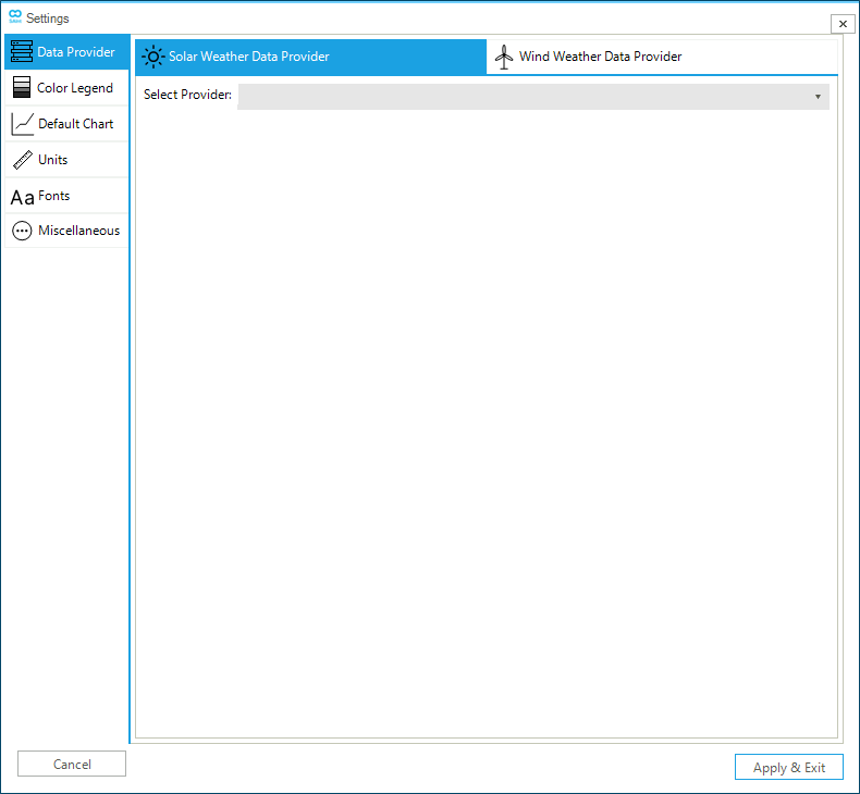

Data provider |
Option to select and set the connection properties for the meteorological data provider. |

2.1.1. Data provider
The Data provider tab allows the user to select and set the solar and wind weather provider to retrieve data useful to develop an electric network model. For each data provider, the user can specify — if needed — login credentials, server URL, and search criteria (e.g., year, geographic location, time granularity, etc.). Data providers and criteria can be updated or modified at any time by the user. See the section "Integrating Weather Resource Data" for details on the data provider or go to the How-To guide "Connect to Weather Resource Data Providers".

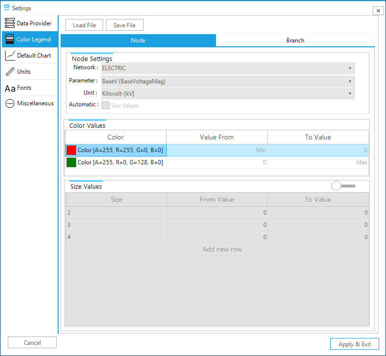

2.1.2. Color legend
The Color legend tab allows the user to edit and customize the legends used to display branches and nodes properties in the map window.

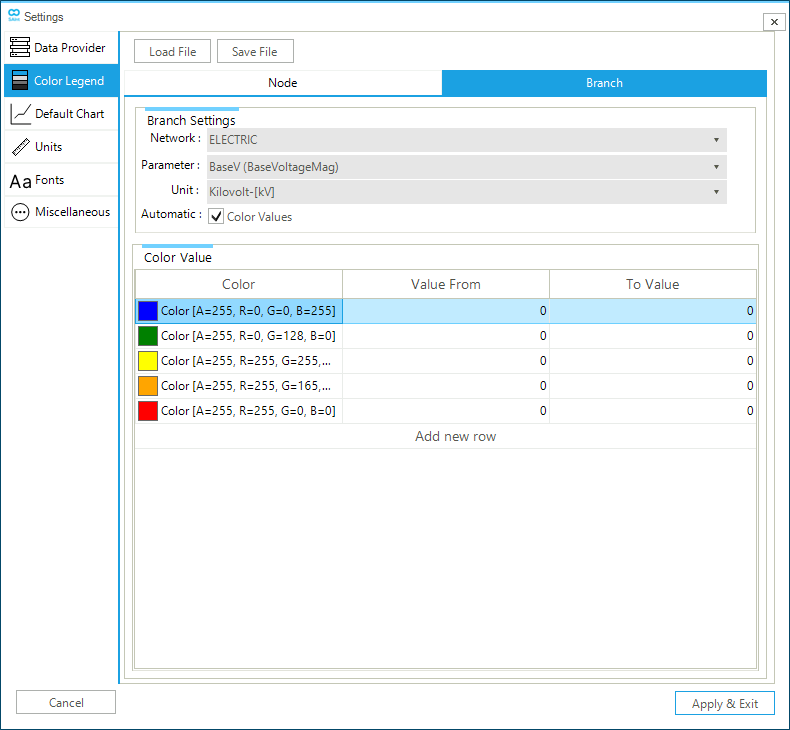

In the case of branches, Figure 5 shows how the legend can be customized per network, parameter, and unit of measure. The options Color, Value From, and To Value allow to obtain a categorized legend, where each class is defined in terms of the range of the values of the parameter, and color. The number of classes can be changed using the option "Add new row". In the example of the figure, the base voltage magnitude, in kilovolts at the branch level, is categorized into 5 classes. Ranges for each class are automatically define as the option Automatic is checked (by default). The blue class starts at minimum value. The red class ends at the maximum value. The remaining breaks are defined by calculating four equally spaced intervals.
The user can customize the following options of the branch legend settings:
- Network
Option to specify which type of network to customize (i.e., available values are gas, electric, and hubs, while liquid and heat networks will be available in future releases).
- Parameter
Option to select a specific parameter from a drop-down menu based on the selected network type.
- Unit
Option to select the unit of measure from the drop-down menu for the specified parameter.
- Automatic
Option to let SAInt automatically assigns the color range to the parameter. Untick the option to enforce the user-specified categories.

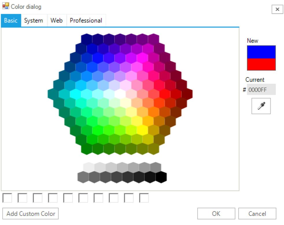

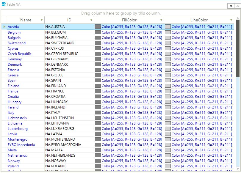

- Color Value
The user can customize color and class range. The
Colorcolumn defines the RGB of the parameter that applies for the intervalValue From—To Value. In addition, new ranges can be added using the Add new row. The color dialog window (Figure 7) is accessible via … located on the right side of theColorcell.
In the case of nodes, Figure 6 shows how the legend can be customized per network, parameter, and unit of measure. The fill color of the nodes can be personalized for results divided into the negative region (i.e., the minimum value and zero excluded), and the positive region (from zero excluded to the maximum). Values equal to zero are represented in a white. If both extreme are in the same region, only one color is visible. The size of the nodes is personalized using a user defined number of classes with their own ranges. The number of classes can be changed. In the example of the figure, only the color is active. No sizing of the nodes is selected as the sliding bar on the right of the "Size Values" entry is not active.
As in the case of the branch legend, the user can customize the following options of the node legend settings:
- Network
- Parameter
- Unit
- Automatic
- Color Value
Colorcolumn defines the RGB of the parameter that applies for the intervalValue From—To Value. - Size Values
The user can specify the number of classes for the different sizes and the range of valid values for each class with the interval

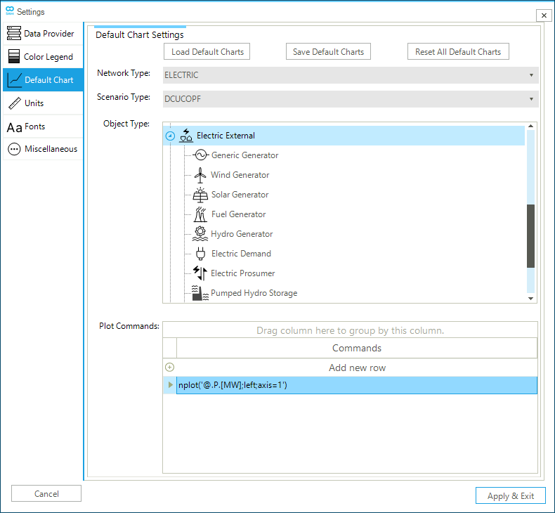

Color column of the settings tab Color Legend.2.1.3. Default chart
The Default Chart tab allows the user to customize the "default charts" produced by SAInt for the different network objects. Figure 8 shows an example of electric externals in a DCUCOPF scenario of an electric network. Please, note that only a parent object can be customized in terms of properties, units, axis, color, and so on in the chart. A child object inherits the graphical properties from its parent object, and so its own chart’s properties cannot be modified. A customized default charts configuration file can be saved for future use or loaded from a previous project. After customization, the user can also reset all specified properties to the installation defaults. The plot commands section displays the function used to generate the default plot.
The user can select the following options of the default chart settings:
- Load default charts
Option to load a saved default chart file with
*.dfcextension. - Save default charts
Option to save the customized default chart configuration to a file with
*.dfcextension. - Reset all default charts
Option to reset all plots to the SAINt installation default configuration.
- Network type
Option to specify which type of network to customize (i.e., available values are gas and electric, while liquid and heat networks will be available in future releases).
- Scenario type
Option to filter the type of objects to customize based on the selected scenario type available from the drop-down menu.
- Object type
The option lists, in a hierarchical tree form, the parent and child objects based on the network and scenario selected.
- Plot commands
Option to edit the script for the default plot of the specified parent object.
Default charts are displayed when selecting from the objects' context menu. |

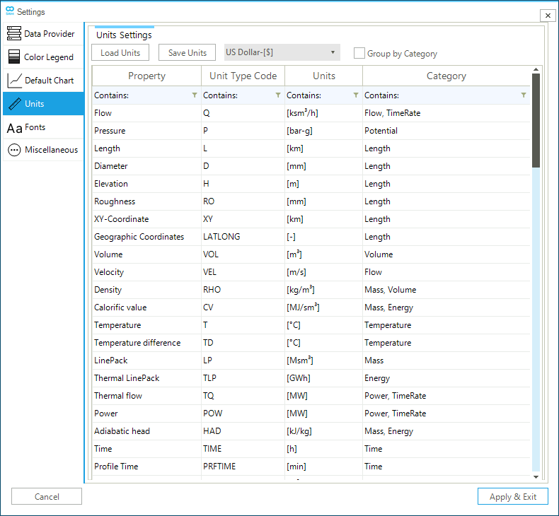

2.1.4. Units
The Units tab allows the user to specify the currency and the units of measure for all properties of parameters and quantities estimated in SAInt. As shown in the example of Figure 9, objects' properties are listed along with their SAInt code, and the unit of measure, which is accessible from a drop-down list ▼. Properties can be grouped to facilitate management operations. The settings can be saved to an external units file, or loaded from an external units file. SAInt centralizes the management of units of measure in the units tab, but it allows to use of alternative units in charts or simulation scenarios, and it takes care of a correct units conversion. For a step-by-step explanation of the use of the unit settings go to the How-To guide "Change Units of Measure and Currency".
Once the units of measure are set, they are valid for all projects, till the next change. Unit settings are a property of the software installation and not of a SAInt project or model. The user should pay attention when moving a project from one computer to another, because the local machine settings for the units may be different, and SAInt will automatically perform all necessary conversions.
The user can select the following options from the units settings:
- Load units
Option to load a saved units configuration file with
*.unitsextension. - Save units
Option to save specific units settings to a file with
*.unitsextension. - Group by category
Option to group properties by category.
- Currency change
The user can set a currency value in the GUI by choosing from the list of currencies (i.e., US dollar, British Pound, and Euro). The default value is US dollar.
- Units
The user can select from a drop-down menu a specific unit of measure for each one of the available properties.
Templates for the most common settings for the units of measure complying with the International System and the Imperial system are available in the directory Units under .\encoord\SAInt-v3\Settings.
When creating a new project, it is recommended to define a custom unit configuration or to select one of the predefined configurations available in |

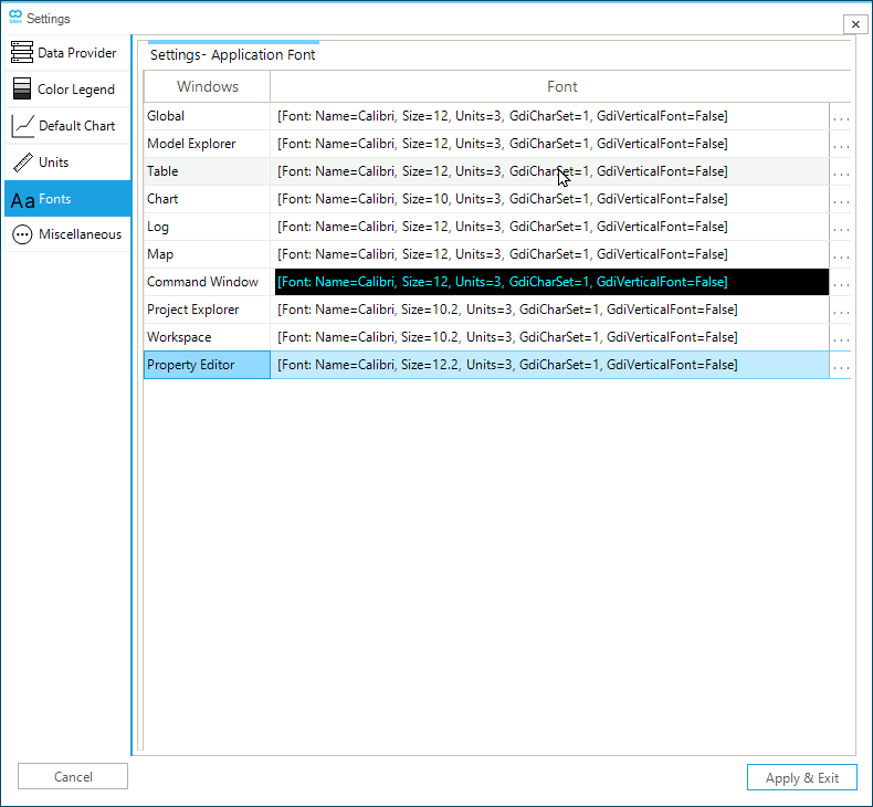

2.1.5. Fonts

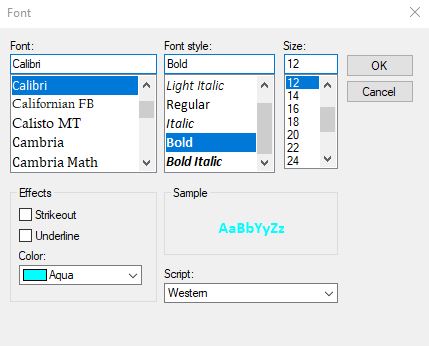

The Fonts tab allows to personalize font properties for all parts of the GUI. As showed in Figure 10, the user can change fonts in the Command Window, the Map Window, the Log Window, the Project and Model Explorer, Workspace, tables, charts, and globally.
The font dialog box is accessible via … on the right side of the font column. The dialog box allows customizing the font family, the font style, the font size, effects, color, and script. A preview is shown in the sample section. The font color is used only to modify the Command Window.

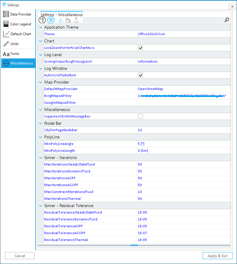

2.1.6. Miscellaneous
The miscellaneous tab allows editing the properties related to the node bar, imported polylines from a shapefile, solver iterations, solver residual tolerance, and other properties, as shown in Figure 12.
The user can modify the following options of the miscellaneous tab:
- Theme
Change the look and feel of the GUI by applying different application themes.
- LockZoomForVerticalChartAxis
Lock the zoom on the vertical axis in newly created charts.
- SynergiImportLogFileLogLevel
Option to set the minimum log level for the Synergi import log file by using the ▼ button. Possible log levels, from the more to the less detailed, are verbose, debug, information, warning, error, and fatal.
- AutoScrolltoBottom
Option to activate or deactivate the auto-scroll to the bottom of the log window when a new row is added.
- DefaultMapProvider
Option to select the default map provider to use in the Map Window for the base map. A drop-down list provides the valid options. The user can specify a different provider for each map view using the Base Map Layer Settings" of the layer window, and must save a session to be able to restore the choice.
- BingMapsAPIKey
Insert the user’s API key for the Bing Maps provider.
- GoogleMapsAPIKey
Insert the user’s API key for the Google Maps provider.
- SuppressOkInfoMessageBox
Option to show or not informative boxes that require the user to only press Ok.
- ObjPerPageNodeBar
Option to set the maximum number of objects on each page of the node bar in the map window.
- MinPolyLineAngle
Option to set the minimum angle between two neighboring vertices of a segment of an imported shapefile to identify vertices to remove for reducing and simplifying the complexity of a polyline.
- MinPolyLineLength
Option to set the minimum distance between two consecutive vertices of a segment of an imported shapefile to identify vertices to remove for reducing and simplifying the complexity of a polyline.
- MaxIterationsSteadyStateFluid
Option to set the default maximum number of iteration steps used for new steady state scenarios for fluid networks.
- MaxIterationsDynamicFluid
Option to set the default maximum number of iteration steps used for new dynamic scenarios for fluid networks.
- MaxIterationsACPF
Option to set the default maximum number of iteration steps used for new AC-power flow scenarios.
- MaxIterationsACOPF
Option to set the default maximum number of iteration steps used for new AC-optimal power flow scenarios.
- MaxConstraintIterationsFluid
Option to set the default maximum number of constraint iteration steps used for new steady state and dynamic scenarios for fluid networks.
- MaxIterationsThermal
Option to set the default maximum number of iteration steps used for new thermal scenarios.
- ResidualToleranceSteadyStateFluid
Option to set the default residual tolerance used for new steady state scenarios for fluid networks.
- ResidualToleranceDynamicFluid
Option to set the default residual tolerance used for new dynamic scenarios for fluid networks.
- ResidualToleranceACPF
Option to set the default residual tolerance used for new AC-power flow scenarios.
- ResidualToleranceACOPF
Option to set the default residual tolerance used for new AC-optimal power flow scenarios.
- ResidualToleranceThermal
Option to set the default residual tolerance used for new thermal scenarios.

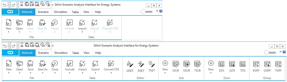

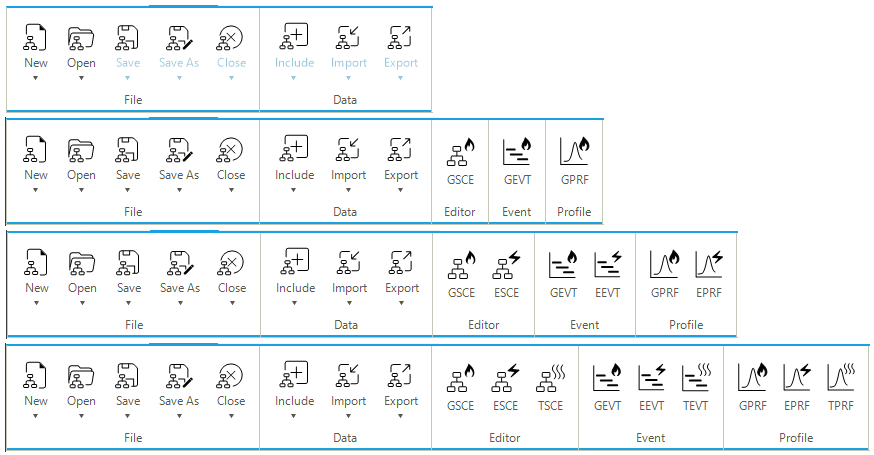

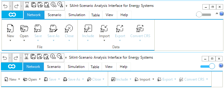

The Ribbon tabs part of the ribbon bar consists of six tabs (Figure 13 top): network, scenario, simulation, table, view, and help. Each tab is composed of several panels (e.g., for the Network tab we have the panel File and Data). Each panel contains different menu items or options (e.g., the Data panel of the Network tab has the following options: New, Open, Save, Save As, and Close). By using the button ▼ in each option, the user can open a drop-down containing different specific functions. The ribbon tab can be minimized by using the option.
3.1. Network tab
The Network tab of the ribbon bar allows the user to access an extended set of network-related functions. It is composed of up to six panels, depending on the number and type of networks loaded. (Figure 14) shows the case of a project where there is no loaded network (the top part with the two panels File and Data), and the case of a project where a hub, an electric, and a gas network are loaded (the bottom part with six panels: File, Data, Editor, Sub, Zone, and Group). A detailed description of the panels and the available options is provided in the following sections of the reference guide.
3.1.1. File panel
The File panel of the Network tab allows the user to create, open, save, copy, and close any network file available in the active project. Table 4 describes in detail the options available in the File panel.

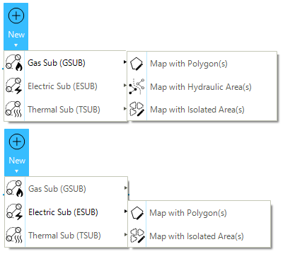

New |
Option to create a new prototype network with default property values. The network is a placeholder for the user’s data. From the drop-down menu ▼ the user can select the type of network (i.e., a gas network, an electric network, or a hub system) and if the type of coordinate type (i.e., Cartesian system or geographci system). |
Open |
Option to open a saved SAInt network or Hub system. Use the drop-down menu ▼ to select the type of network. |

Close |
Option to close the active network. |
To quickly make a copy of a network, use the button Save As. |

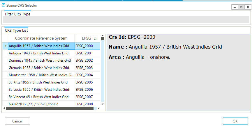

Convert CRS |
Option to convert the network data CRS to SAInt default geographic CRS to disply a network on a base map. |

The "convert" option is designed so that the user can convert the coordinate reference system (CRS) of the active network in a Cartesian map view to SAInt’s default CRS. The conversion procedure opens the network on a new geographic map view and closes the Cartesian one.
By selecting Convert CRS the user can choose among the available active networks. Figure 16 shows the window where the user can choose the CRS of the active network (i.e., the CRS of the displayed network in the Cartesian map view). The coordinates will be transformed to the CRS EPSG:4326 (i.e., WGS84). The user can select the desired CRS from the available list or filter and select by entering a string or the EPSG code in the "Filter CRS Type" field.
Sections "Coordinate Reference Systems" and "Map view" provide more details on how SAInt handles coordinates and coordinate reference systems. |

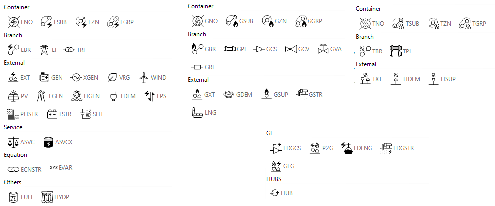

3.1.3. Editor panel
The "editor panel" of the Network tab gives access to the property editor for the networks available in a project in the GUI. The network property editor contains input and output properties such as the number of nodes, type of network, etc. The available items in the editor panel depend on the type of networks in the active project (e.g., the *.gnet editor is not visible if no gas network is loaded). Table 6 describes in detail the options available in the editor panel.
ENET |
Option to open an electric network editor. |
GNET |
Option to open a gas network editor. |
TNET |
Option to open a thermal network editor. |
HUBS |
Option to open a hub system editor. |
3.1.4. "Sub" panel
The "Sub" panel of the network tab allows the user to create new sub-system in any network of the active project in the GUI, or to open a table in the dock panel describing sub-systems. The available items in the "Sub" panel depends of the type of networks in the active project (e.g., the *.GSUB table is not visible if no gas network is loaded). Table 7 describes in detail the options available in the "Sub" panel.
New |
Option to create new subs based on different options. |
ESUB |
Option to open a table with a list of electric subs. |
GSUB |
Option to open a table with a list of gas subs. |
TSUB |
Option to open a table with a list of thermal subs. |
The "New" option is designed so that the user can create a new sub-system in a network by using polygons or properties of the network (Figure 17). The New option allows the user to:
- Map with polygon(s)
Create a new sub-system based on polygon(s) included in the network.
- Map with hydraulic area(s)
Create a new sub-system based on the hydraulic area(s) of the active gas network. This option is available for gas and thermal networks.
- Map with isolated area(s)
Create a new sub-system based on the isolated area(s) of the active network.

3.2. Scenario tab
The Scenario tab of the ribbon bar allows the user to access an extended set of scenario-related functions. It is composed of up to five panels, depending on if a scenario is active and on the type of scenario in the project. (Figure 18) shows the case of a project where there is no scenario active (the top part with the two panels File and Data), a case of a scenario for a dynamic gas model (second from top with the five panels File, Data, Editor, Event, and Profile), a case of a scenario for a dynamic gas and quasi-dynamic electric coupled models (third from top), and a case with (quasi-)dynamic gas, electric and thermal models. A detailed description of the panels and the available options is provided in the following sections of the reference guide.
The Profile panel is available only for QuasiDynamic and Dynamic scenarios. |
3.2.1. File panel
The File panel of the Scenario tab, similarly to the File panel of the Network tab, allows the user to create, open, save, copy, and close any scenario file available in the active project. Table 10 describes in detail the options available in the File panel.
New |
Option to create a new scenario for the active network using a dedicated Scenario Dialog window. |
Open |
Option to open an existing scenario for the active network. The user can select the scenario from the ones available in the Scenario Dialog window. |
Save |
Option to save the current scenario for the active network. |
Save As |
Option to save and copies the current scenario letting the user changing its name. |
Close |
Option to close the current scenario for the active network. |

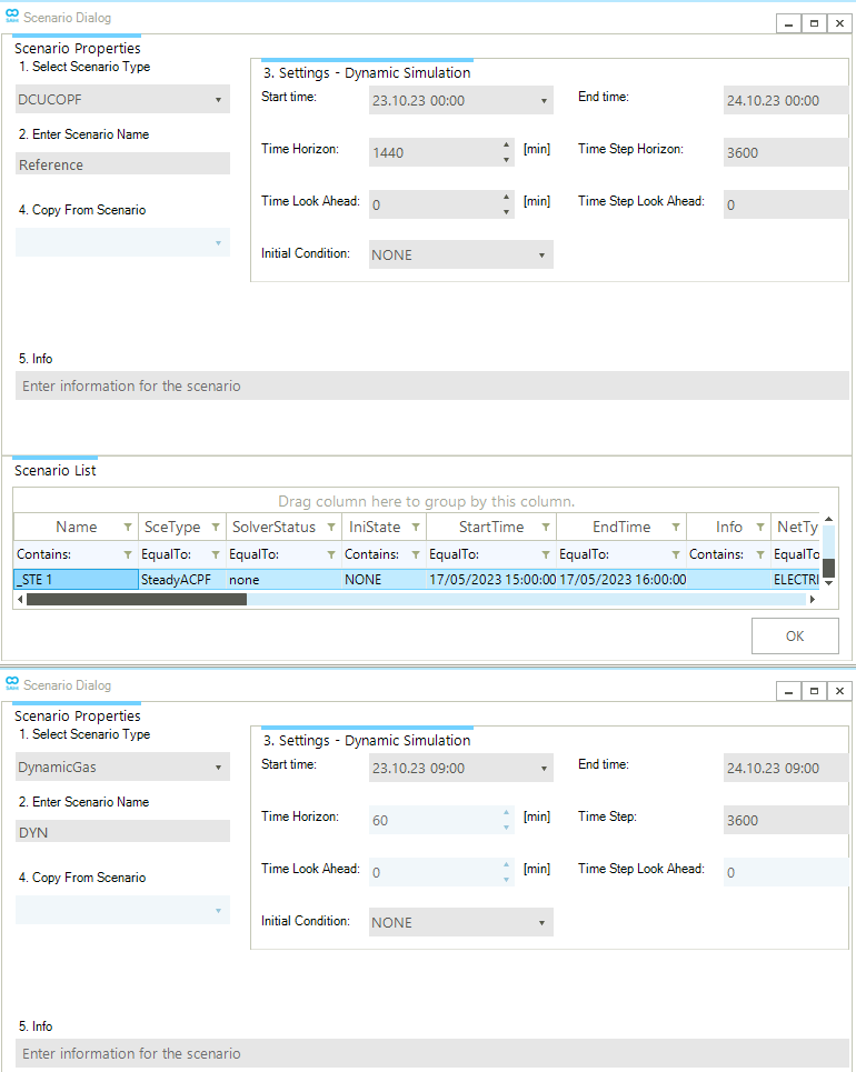

3.2.2. Dialog window
The Dialog window of the Scenario tab allows the user to define all necessary scenario properties or to select an existing scenario from the ones available in the active project. Figure 19 shows an example of a Scenario Dialog window for an electric DCUCOPF scenario (top) and an example of the scenario properties section for a dynamic gas scenario (bottom). In the example of the electric DCUCOPF scenario, it is possible to see that a SteadyACPF scenario has been already created, and it is available in the scenario list section. The scenario properties change according to the scenario type.
The Scenario Dialog window is designed so that the user can define or review the main properties of a simulation scenario. The list of options is the following:
- Select scenario type
Option to select the scenario type among the available type for the chosen network (e.g., DCUCOPF, SteadyACPF, DynamicGas, etc.).
- Enter scenario name
Option to specify the name of the scenario to load or create.
- Copy from scenario
Option to copy a scenario, and transfer the associated events and profiles, to the new scenario. This option is available only when using the button Save As from the File panel.
- Start time
Define the start time of the scenario expressed as date and time. Date and time can be selected from a drop-down menu or typed manually with the format dd.mm.yyyy hh:mm (e.g., based on the format day.month.year hours:minutes like in the case 21.01.1973 18:30 which is January 21 1973 at half past six in the afternoon).
- End time
Option to define the end time of the scenario expressed as date and time. The date and time can be selected from a drop-down menu or typed manually.
- Time horizon
The time horizon is a fraction of the scenario time window considered for an optimization or solution step in dynamic scenarios. It is expressed in seconds. For example, a time horizon of 600 seconds indicates that an optimization or solution step is set for every 10 minutes.
- Time step horizon
An integer time step in minutes indicating a fraction of the scenario time window used for discretizing the scenario time window into distinct time points which are calculated for the simulation variables. The option is valid only for DCUCOPF scenarios.
- Time look ahead
It is a time duration added to the time interval considered in the consecutive optimization for DCUCOPF scenarios.
- Time step look ahead
The "integer time step look ahead" is a fraction of the scenario time look ahead used for discretizing the scenario time look ahead into distinct time points which are calculated for the variables. Valid for DCUCOPF scenarios.
- Initial condition
Option to set the initial scenario conditions for a quasi-dynamic or dynamic scenario. It can be the solution to a steady state scenario or the terminal state of a quasi-dynamic or dynamic scenario.
- Info
Option to add a comment or description for the scenario.
- Scenario list
Option to list all existing scenarios linked to the active network.
Before 3.4 release, scenarios had a Comment option instead of Info. However, comments are no longer supported, i.e., the comments will not be mapped to the new Info option. |
3.2.3. Data panel
The Data panel of the Scenario tab contains buttons to include, import, or export scenario events, profile, result, and network state to and from SAInt. The user can include available data in SAInt format in the active model, import external data in different formats, or export SAInt data and scenario-related information to native or exchange formats. Table 11 describes in detail the options available in the Data panel.
Include |
Option to include native SAInt data for loading a scenario file ( |
Import |
Option to import template files related to the scenario (e.g., event, profile, etc.). |
Export |
Option to export data to external files related to the scenario (e.g., to Excel, SAInt native, etc.). |

3.2.4. Editor panel
The Editor panel of the Scenario tab allows the user to access the property editor for the active scenario in the GUI. The user can use the property editor to modify all aspects of a steady state or dynamic scenario such as simulation start and end time, time step, initial state, solver type, look ahead, etc. The type of buttons shown on the panel depends on the type of active network. Table 12 describes in detail the options available in the scenario Editor panel.
GSCE |
Option to open a gas scenario in the property editor. |
ESCE |
Option to open an electric scenario in the property editor. |
TSCE |
Option to open a thermal scenario in the property editor. |
3.2.5. Event panel
The Event panel of the Scenario tab allows the suer to access the scenario events table in the GUI. The user can use the table to manage all events of the active scenario. Table 13 describes in detail the options available in the scenario Event panel.
See the How-To guide Create a scenario event in SAInt-GUI for a step-by-step description on managing events.
GEVT |
Option to open a table with a list of events for the active gas scenario. |
EEVT |
Option to open a table with a list of events for the active electric scenario. |
TEVT |
Option to open a table with a list of events for the active thermal scenario. |
3.2.6. Profile panel
The Profile panel of the Scenario tab allows the user to access the scenario profiles window in the SAInt-GUI. The user can use the profile window to manage profiles saved in the active network. The type of buttons shown on the panel depends on the type of active networks. Table 14 describes in detail the options available in the Scenario Profile panel.
See the How-To guide "Create a Profile in SAInt-GUI" and the guide "Assign a Profile to an Existing Event" for a step-by-step description on creating and assigning profiles.
GPRF |
Option to open the table with a list of profiles for the active gas scenario. |
EPRF |
Option to open the table with a list of profiles for the active electric scenario. |
TPRF |
Option to open the table with a list of profiles for the active thermal scenario. |

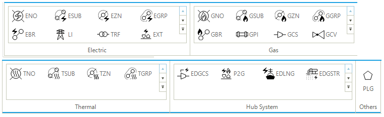

3.4.1. Table panel by type of network
The Electric, Gas, thermal, and Hub System panels of the Table tab allow to access properties and results in tabular form for all network objects in the active project. Use ▼ and ▲ to navigate through the section. Figure 22 shows the expanded form of the three panels after clicking on the drop-down button. By selecting an object in the list, a new table is available in the dock panel of the GUI.

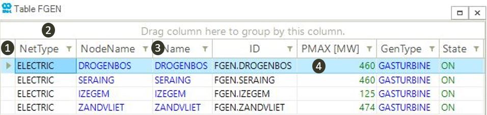

Figure 23 shows, as an example, the result of selecting the FGEN object from the Electric panel. All generators in the active electric network are displayed along with user selected input and output properties. Properties are color coded following this convention:
- Black
Read-only properties of an object. These properties are derived (e.g.,
NetType). - Blue
Editable network properties of an object. These are input properties (e.g.,
Name). - Red
Scenario result properties of an unsolved or failed scenario (e.g.,
P). - Green
Scenario result properties of a successfully solved scenario (e.g.,
P).
The user can navigate the tabular form of results and properties using three main context menus:
- Global context menu
This menu is available by right-clicking at ❶ or ❷ in the generated table (see example of Figure 23). It allows to perform three different sets of tasks: to toggle on or off an extra header and/or tail row in the table for filters, search, or summary tools; to modify, reset and update the available columns in the tables; to export the table to an external file in different formats.
- Column context menu
This menu is available by right-clicking on any column name (e.g., right-click at ❸), and it allows the user to add, remove, modify, and style columns in the table.
- Row context menu
This menu is available by right-clicking on any cell of a row of the table (e.g., right-click at ❹), and it allows the user to access functions to perform a variety of tasks on the object described by the row. The user can, for example, access the object in the property editor, locate and zoom to it in the map view, and add events to the object.

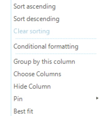

The Column context menu is the same for all column header cells in a table (Figure 25). It provides access to the following set of options:
- Sort ascending
Option to sort the selected column in ascending order.
- Sort descending
Option to sort the selected column in descending order.
- Clear sorting
Option to clear any sorting from the selected column.
- Conditional formatting
Option to open a window where the user can set the rules for formatting the content of the columns based on specific rules. See later on for more details.
- Group by this column
Option to group the entire table based on a selected column. The table can also be grouped by pressing the left mouse button and dragging the selected column above the table headers. The table can be ungrouped by dragging the grouped column back to the header row. Multiple cascading groups can be created.
- Choose columns
Option to open a window with all the possible column entries for the current table. The user can add the column entries by double-clicking on the column entry names.
- Hide column
Option to hide the selected column in the table.
- Pin
Option to unpin or pin to the left or right side of a table the selected column.
- Best fit
Option to adjust all columns width.

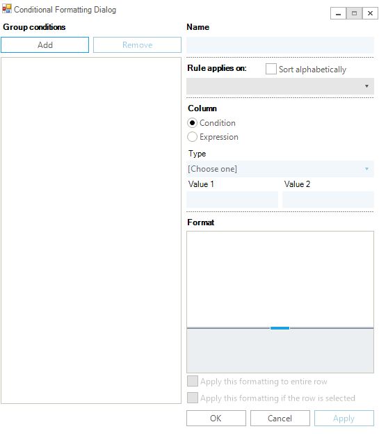

Conditional formatting allows the user to selectively format and style the content of rows and cells based on specific conditions and expressions (Figure 26). Multiple rules can be defined or removed from a table. Each rule must have a unique name, and must apply to a certain column. Rules must be developed based on predefined conditions (e.g., equal, greater, between value one and value two) or user defined expressions and involved up to two reference values. The user can format multiple aspects like the font used in cells and rows, the text alignment, the font color or the background color.

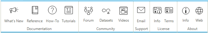

3.6. Help tab
The Help tab of the ribbon bar allows the user to access SAInt’s community, documentation material and the support team in encoord (Figure 30). The Help tab has five panels: documentation, community, support, license, and about.
The first time the user opens SAInt, the Help tab and the button "What’s New" are highlighted in the documentation panel. The user is invited to click on the "What’s New" button to access section three of the "Welcome" page summarizing the major changes to the new release of SAInt. At the end of the section, the user has also a shortcut to the full release notes. The highlight option is only available the first time SAInt is launched.
3.6.1. Documentation panel
The Documentation panel collects functions related to the local copy of SAInt documentation. The learn more menu option may not be yet available in this release. In general, the documentation is quickly accessible by pressing the keyboard key F1 in any SAInt window or over any SAInt graphical element. This action will redirect the user to the specific topic for that element inside the reference guide. The full list of options is available in Table 21.
What’s New |
Option to navigate to the "What’s New" section of the documentation. It contains information on all new features and functionalities included in the present release of SAInt. |
Reference |
Option to navigate to the Reference section of the documentation. It provides the user with an overview of SAInt and contains information on different components (e.g., GUI, API, scenarios etc.) of the present release of SAInt. |
How-to |
Option to navigate to the how-to guides section of the documentation. It provides the user with step-by-step instructions to complete a specific task (e.g., how to add an external to a node etc.) using SAInt. The how-to guides are divided into generic, electric, gas, and combined sections and are updated every new release of SAInt. |
Tutorial |
Option to navigate to the tutorial section of the documentation. It contains set of tutorials related to address a problem (e.g., create a gas network, create a DCUCOPF scenario, executing a DynamicGas simulation etc.) in SAInt. The tutorials are updated with the new releases of SAInt. |
3.6.2. Community
The community panel allows access to the online forum, where the users meet to discuss SAInt and of how to use SAInt to solve their challenges. The community can also take advantage of open-source model-ready datasets to speed up research and problem-solving in integrated planning and energy system modelling. Some video guides are also accessible to complement SAInt’s documentation. Table 22 summarizes the available functionalities.
Forum |
Option to open the online community forum to meet other SAInt users. |
Dataset |
Option to access the forum page where download model ready datasets for SAInt. |
Videos |
Option to navigate to online video resources on th euse of SAInt. |
3.6.3. Support panel
The Support panel allows the user to contact the encoord’s support team. The full list of options is available in Table 23.
Option to open a pre-filled email that will be send to encoord’s support team. |
Another option to provide feedback to encoord is by sending an exception email. A window will pop up if SAInt detects an error, in which the user can describe the details of the issue. This email contains the exception details and the SAInt version. The encoord support team will collect the error details and contact the user with a solution. |
3.6.4. License panel
The license panel of the Help tab allows to check and read all necessary information and terms of the license of SAInt. Through this panel is also possible to request the renewal of an existing license. The full list of options is available in Table 24.
Info |
Option to open the |
Terms |
Option to open a document containing the software license agreement. |
3.6.5. About panel
The about panel of the help tab shows the version of SAInt in use, and provides the link to encoord website. The full list of options is available in Table 25.
Info |
Option to open a splash screen showing the installed SAInt version. The splash screen can be closed by clicking on it. |
Web |
Option to open the encoord website in the default browser. |

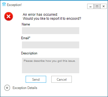

3.6.6. Exception window
SAInt offers the user the option to share technical data directly with the "Customer Support Service" of encoord by means of the "Exception!" window, a pop-up window triggered whenever an action is throwing an error in the expected behavior of SAInt-GUI. The "Exception!" window asks the user to provide a valid e-mail and optionally to specify the name and a short description of the event leading to the exception (Figure 31). The technical details of the exception are available for inspection and are shared with the "Customer Support Service".
An error triggered by a Python script using the API or by an IronPython script in the GUI is handled by SAInt respectively by logging the Python exception messages to an external log file or by using a pop-up window with information of the IronPython script problem.
