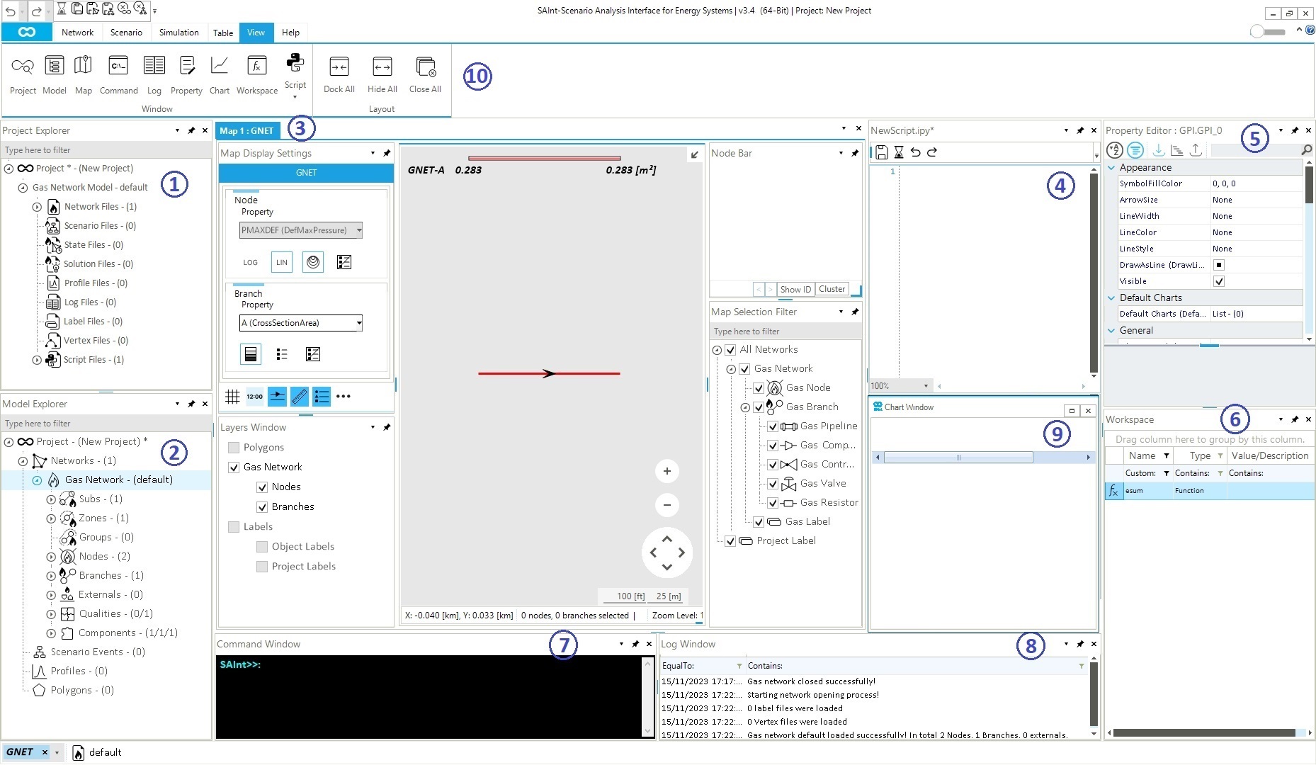

The section describes the controls and options included in the dock panel of SAInt-GUI. The dock panel consists of (Figure 1):
the project explorer (1): to manage all the file resources related to the active project.
the model explorer (2): to access objects and model-related data of the networks in the project.
the map window (3): to display a network, scenarios, and results in tabular form.

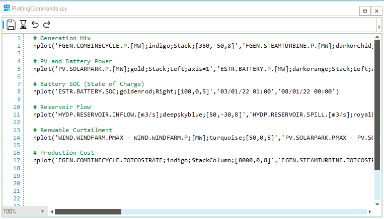

the script editor (4): to develop scripts in IronPython to interact with the model and the results.

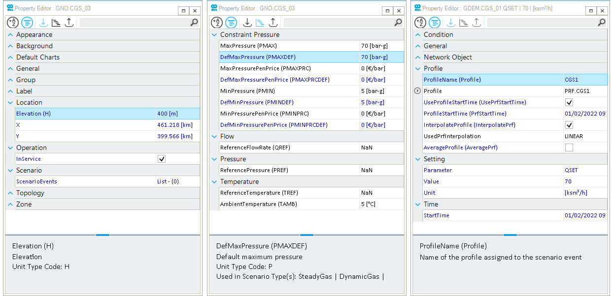

the property editor (5): to display the full set of properties of a selected object.

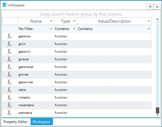

the workspace (6): to have a list of functions to be used in the command window or in an IronPython script.

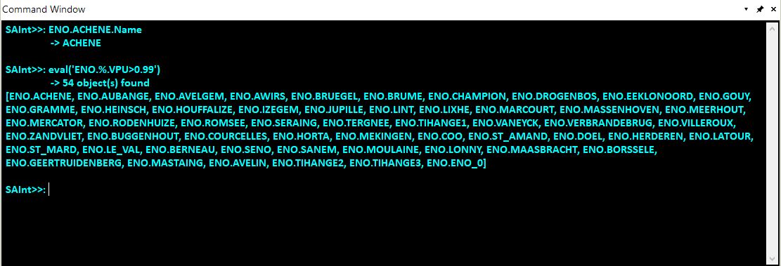

the command window (7): to interact with SAInt core using a command line interface.

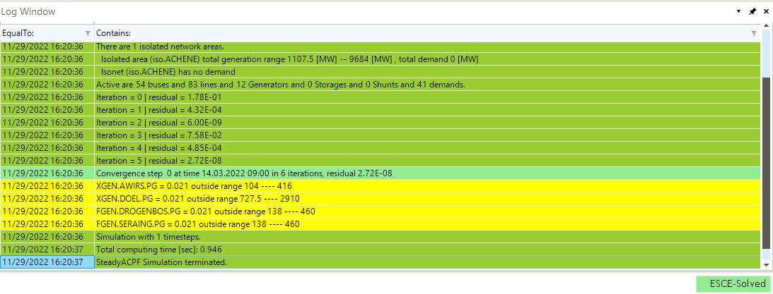

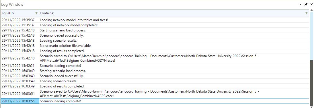

log window (8): to record and log actions performed by SAInt and simulation or optimization messages.

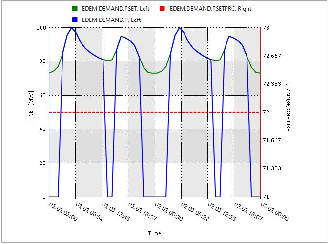

the chart window (9): to display charts of properties and results.
The elements of the dock panel can be controlled either at the element level or from the entry View of the ribbon bar (see number 10 in Figure 1).

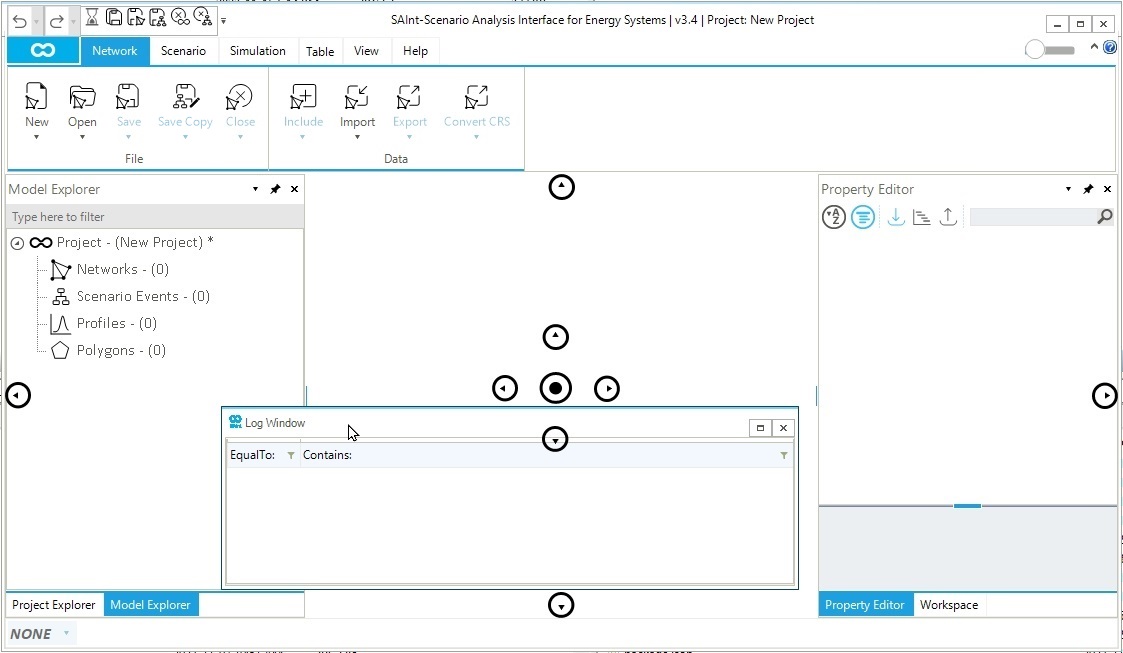

The SAInt graphical user interface is highly customizable. The user can activate, remove, dock, or re-arrange windows based on the specific needs of a project. The tab "View" in the ribbon bar allows users to interact with the different windows and modify the general layout easily. If a window is closed, the user can open it again from the tab View menu. Each window contains a title bar (at the top) and the main dock area. On the right side of the title bar, three buttons allow for closing the window (right-most x-shaped icon), auto-hiding the window (middle pin-shaped icon) and modifying the state of the window (left-most triangle-shaped icon) from dockable to floating or tabbed. In the case of the map window, the triangle-shaped icon provides a list of the available tab views.
The user can interact with the windows by using the mouse on the title bar and:
- by holding the left button pressed
The selected window can be dragged to a new position. SAInt shows marks on the other windows to suggest docking actions and positions, like in Figure 2. The window can also be positioned on a different screen to take advantage of a multi-screen layout.

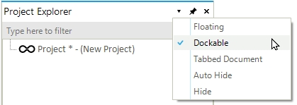

- by left-clicking
The user can change the docking mode of each window to floating, dockable, hide, auto-hide, or tabbed document, as shown in Figure 3. The docking modes can be selected by using the downward arrow button (located on the right of the title bar) or right-clicking on the title bar. The available options are:
Floating: Pops out the selected window in a floating state. The user can then drag the floating window to the desired location.
Dockable: Docks the selected window to its default location on the SAInt-GUI.
Hide: Hides the selected window from the SAInt-GUI. The user can re-open the hidden window from the view tab.
Auto-hide: Auto-hides the selected window in the SAInt-GUI. The user can hover and click on the icon of the hidden window to dock it.
Tabbed: Makes a new tab for the selected window.

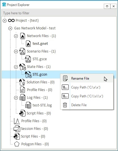

2. Project explorer
The project explorer is accessible from the project explorer tab located on the left-most window of SAInt-GUI. It gives an overview of the files available in the current project directory. Figure 4 shows an example of a gas network named "test". The project explorer has a hierarchical structure, starting from the parent entry, which indicates the current project’s name in brackets. The file types included and listed in the project explorer are:
Networks: The project explorer reports an entry for each network included in the project. This entry has a second nested level reporting: the name of the specific network, the list of scenarios for the network, the list of state and solution files for the solved scenarios, the list of profile files, the list of logs recorded after a scenario execution, and the list of script files available.
Profile files: The entry lists all the profile files in the "project" directory, which is the folder where the project file is saved.
Polygon: The entry lists all the SAInt format polygon files in the "project" directory.
Log: The entry lists all the log files in the "project" directory.
Script: The entry lists all the script files in IronPython in the "project" directory.

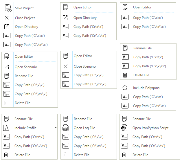

When right-clicking on a child of an entry, a context menu opens with a set of options allowing the user to (1) open the file with the property editor, (2) copy the path using Windows or Unix style, (3) rename the file or (4) delete the file. When a file is deleted, it is not moved to the operating system trash bin but removed from the files system. Please, remember that SAInt does not provide for an undo capability. Be careful with what you delete.
The entries in the hierarchical list can be expanded or collapsed by clicking on the triangle to the left of the entry name.
The active scenario and networks are indicated by using a bold font.
Below the title bar of the project explorer window, there is a gray text box providing searching and filtering functionalities for the files reported in the hierarchy of items.
The file extension for a project file is |
The entries in the project explorer have different options accessible from their context menu. Figure 5 shows examples of the context menu for different items. Other possible options are also available when the entry is active and loaded in a session. The most common operation is to copy the path to the file of the entry, load it in the active session, or delete it from the hard drive.

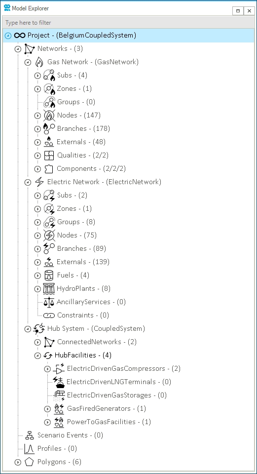

The model explorer is structured to show (see the example in Figure 6):
Networks: the entry provides a list of networks included in the project, and for each network, a list of subs, zones, groups, nodes, branches, or network specific objects (e.g., qualities for gas systems or fuels for electric systems). When a hub is included in the model, the entry reports the list of networks participating in the hub system and the list of hub facilities.
Scenario Events: the entry lists the events of the active scenario for each network.
Profiles: the entry lists the profiles used in dynamic simulations for each active scenario.
Polygons: the polygons loaded with the project are listed.
Clicking on the triangle to the left of a parent object name will expand or collapse the child objects.
The presence of an asterisk next to the entry name indicates that the object has not been saved yet.
The number next to a parent object’s name (e.g., branches (147) under "Gas Network" in Figure 6), indicates the total number of associated child objects. However, the numbers next to the qualities and components for a gas network give the following information:
Qualities - (1/1): The first number indicates the number of qualities assigned to gas supplies in the network, while the second indicates the number of assignable qualities.
DEFAULT - (1/1): The first number indicates the number of components with %-Mol > 0, while the second number indicates the number of components included in the supply qualities defined in the network (In this example, the defined supply quality is DEFAULT).
Components - (1/1/1): The first number indicates the number of components (e.g., methane, hydrogen) with %-Mol > 0 in at least one assignable quality, while the second number indicates the number of components with %-Mol > 0 in at least one quality assigned to a gas supply. The third number indicates the total number of available components.

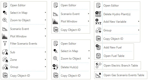

3.1. Context menu in the model explorer

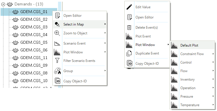

The model explorer allows quick access to object properties or functions by context menus. Right-clicking on an object (parent or child) opens the context menu. The content of the context menu depends on the type of object selected. Figure 7 shows some examples of context menus for network and scenario objects. In some cases, only one option is available, like "Open XXX Table", where XXX is the parent object container of simple objects (see examples at the bottom-right corner of the figure). In other cases, the context menu allows the user to add, remove, and modify the object and its properties. In many cases, it is possible to select the object in the map view, zoom to the object in the map view, open the property editor, or copy the object identification code. Figure 7 displays an example of a context menu for a generic generator (network mode).
The context menus are different when scenarios are loaded compared to the ones when only networks are loaded. |
The more common context menu options for network objects, except those specific to a single network object type, are described below.

Furthermore, there are set of object-specific context menus with different entries based on the node, branch, or object type. Check the following for details.

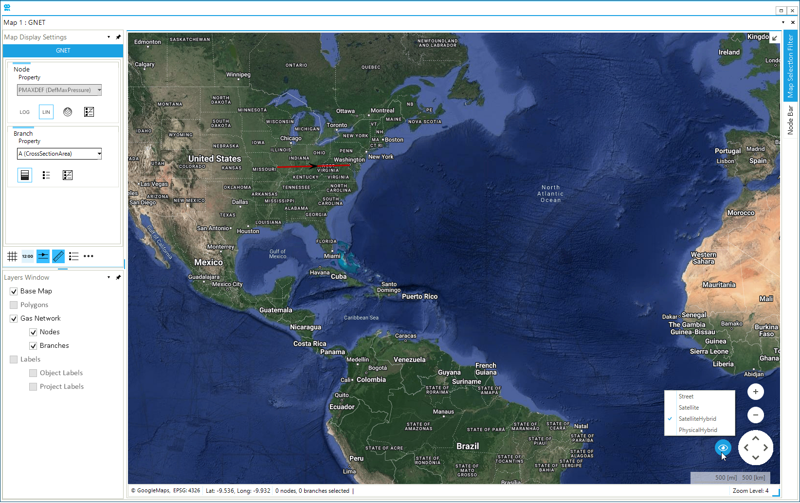

4. Map window

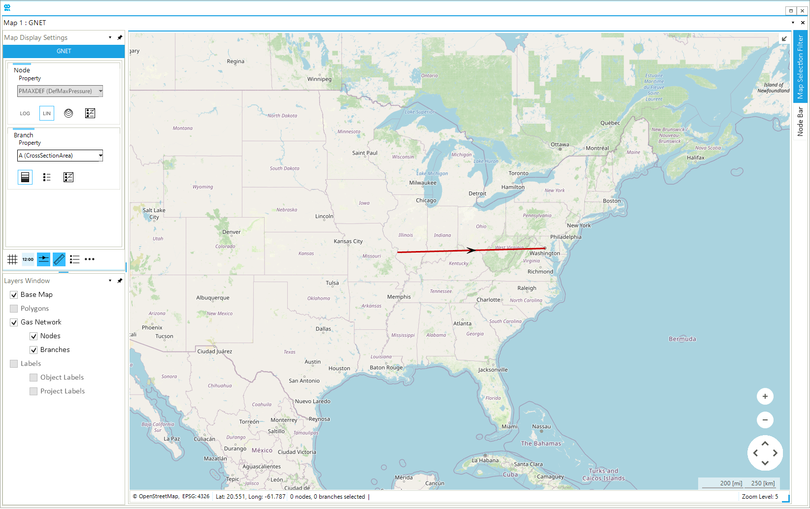

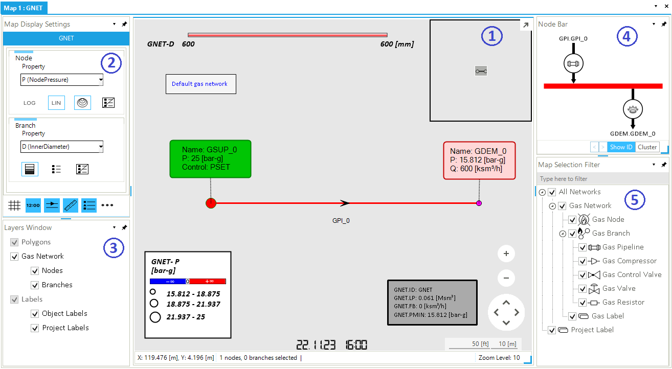

The "Map Window" is a core visualization component of SAint-GUI used to picture the geometric layout of a network, describe the topological relationships among objects, provide a geographic context with a base map, visualize property differences across a network, or show animations of solutions obtained from executing a scenario. Figure 8 shows an example of a map window where a default gas network is shown. In the example, the pipeline has a color-coded legend based on the size of the inner diameter (D) and the nodes' color and size are based on the pressure (P). Labels are used to report properties of the objects. The node bar shows details of node GNO_1 (i.e., the one on the right).
A "map window" is made of multiple parts playing a different role. We have (Figure 8):
the Map View (1): the main element of a map window is the "map view", which is the area where a network is displayed along with legends for nodes and branches, labels, zooming and panning controls, polygons, and a base map, whenever a geographic view is selected.

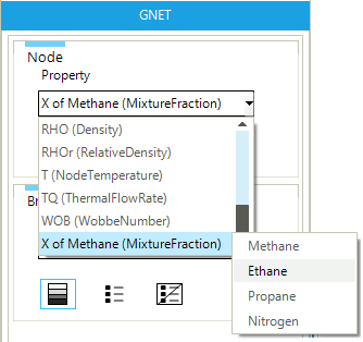

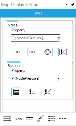

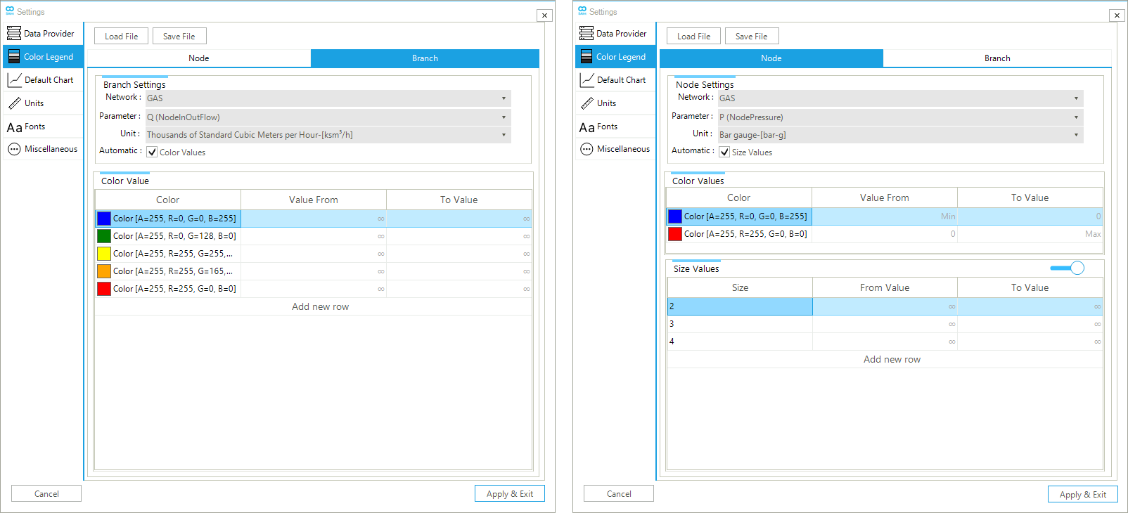

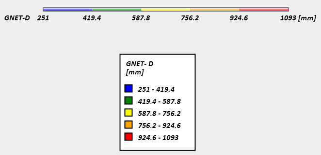

the Map Display Settings (2): all controls and settings for the legends of nodes' and branches' properties or results are accessible through the "Map Display Settings" window.

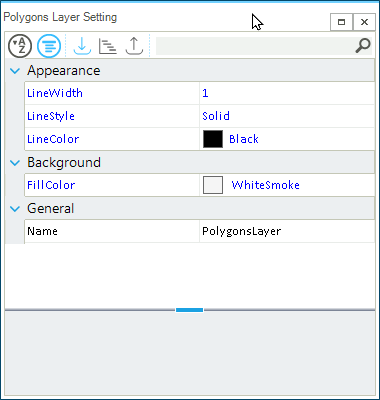

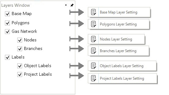

the Layers Window (3): the visibility of all graphical objects, like labels or polygons, and of all model objects, like branches and nodes, can be turned on/off or personalized using layers.

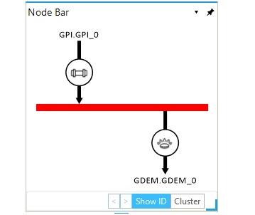

the Node Bar (4): it allows to see and access externals and branches connected to a selected node.

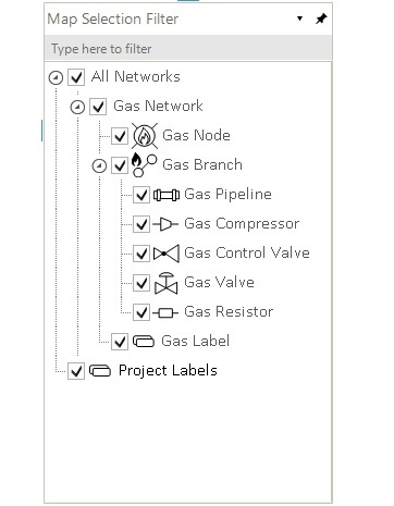

the Map Selection Filter (5): you can restrict the selection of model components or labels by turning on or off the associated type in the "Map Selection Filter".
By default, the map window is located at the center of the dock panel. When creating a new project, one map window is available, with an instance of a map view and one of the other four parts. The user can add multiple map windows in the same project, and each has its own set of parts and settings.

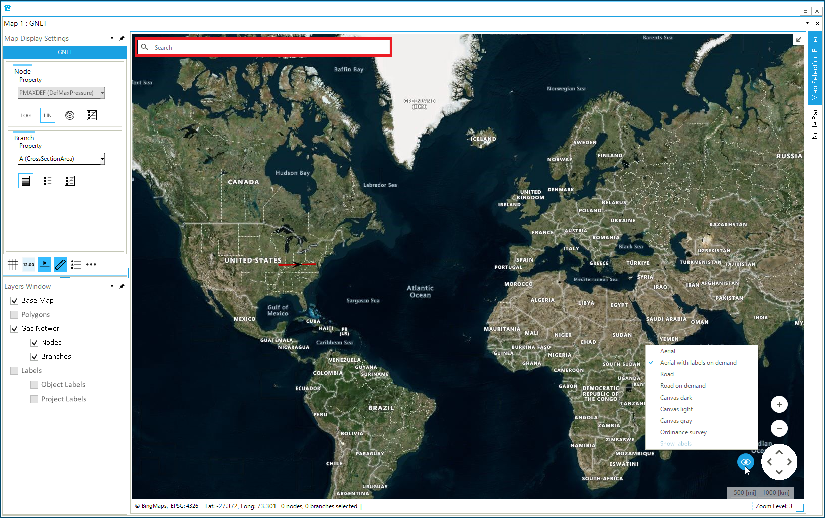

The geographic map view supports the use of a "base map". The default base map is for now taken from the open-source project OpenStreetMap. However, users can choose from two other base maps (BingMaps and GoogleMaps) and specify the preferred map service provider and the associated login credentials.
By default, SAInt provides the user with OpenStreetMap as a map service provider. OpenStreetMap is free to use under an open license. Google Maps and Bing Maps are not open-license services. They provide a variety of subscription plans for different types of users. Both map service providers offer a "free" plan for "Non-profit" and "Education" organizations. To obtain an API key, consult the web page "Getting a Bing Maps Key" or "Getting started with Google Maps Platform" (and click on "Get Started"). |

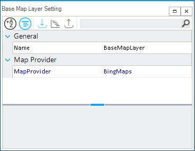

4.1.2. Base map types

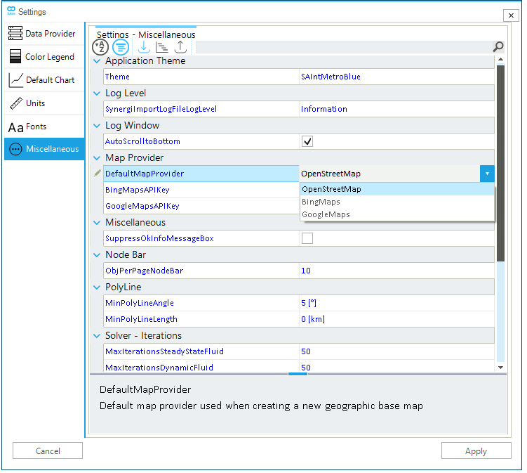

SAInt allows the user to specify a "base map" provider to display a base map layer in a geographic map. There are three main "base map" providers available in SAInt: OpenStreetMap, BingMaps, and GoogleMaps.
To select a "base map" provider, the user can access the miscellaneous tab in the main SAInt settings window and choose a provider from a drop-down list, as shown in Figure 9. Alternatively, right-click on the entry "Base Map" of the layer window and select "Base Map Layer Settings". In the new window, it is possible to set the desired base map provider for the active map view. Each map view can have its own map provider. The user can save such choice in a session. Whenever a session is reloaded in SAInt, the settings for the base map provider for each map view are reset to the user’s selection. The option is for now valid only for the map provider and not for the type of map (i.e., aerial or base gray).
To use "BingMaps" or "GoogleMaps", the user must provide a specific API key under the properties BingMapsAPIKey and GoogleMapsAPIKey. Only with a valid API key SAInt will be able to retrieve tile images from the BingMaps and Google Maps services. The use of these services is outside the agreement signed when purchasing SAInt. The user must choose among the available plans offered by Google or Microsoft and assess possible costs associated with the service. The obtain an API key start by checking the following links:
Google Map Tiles API Key: Getting started with Google Maps Platform.
Bing Maps Key: Getting a Bing Maps Key.
The OpenStreetMap is the default base map used in SAInt. It is based on the OpenStreetMap community-driven and open data project. This service provider does not require the user to cover additional costs for the service. The OpenStreamMap includes only one display style.
The BingMaps base map includes a searching box (Figure 11), which enables to search for locations using the BingMaps Locations API. In addition, the user can switch between different view styles using the view button displayed next to the "zoom in and out" and "panning" buttons on the map window, as shown in Figure 11.
The GoogleMaps base map enables users to switch from one view style to another using the view button. The available options are: street, satellite, satellite hybrid, and physical hybrid, as shown in Figure 12.
SAInt uses a local cache directory to store tiles of any of the available base map service providers. The cache allows to speed up the rendering of a map view and saves data by reducing billable transactions with a commercial service provider. The cache does not affect any search carried out using the "searching box" with BingMaps. |

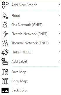

4.1.4. Background context menu
The user can access the background context menu of the map view by right-clicking on any map area with no network objects or objects selected. Figure 13 shows the background context menu for a map view where a gas, and electric, and a thermal network are loaded at the same time without scenarios.
The exact content of the context menu depends on the type of network, type of map view, and solved scenario active. Table 1 provides an overview of the main options.
| Options | Network mode | Scenario mode |
Add new branch |
Adds new (network) branch |
Flood |
Floods the subs, zones, groups, isolated areas, or hydraulic areas. |
Gas network (GNET) |
Opens the gas network editor and remove redundant vertices. |
Opens the gas network editor, remove redundant vertices, create a new plot in a plot window, or create network-level events and profiles. |
Electric network (ENET) |
Opens the electric network editor, remove redundant vertices, fuel, hydro plant, or ancillary service to the network. |
Thermal network (TNET) |
Opens the thermal network editor and remove redundant vertices. |
Add Label |
Add a new object or project label. |
Save map |
Saves the current map to a *.png file. |
Copy map |
Copies the map in its current state as an image. |
Back color |
Opens the color dialog window to change the color of the background of the map view. |

The "Map Display Settings" is the component of the map window controlling how network properties and results are visualized at the node or branch level. The user can specify the property of interest and define how the legend looks based on the personalization of colors, class intervals, type of scale (i.e., linear or logarithmic), size, and position in the map view. Figure 15 shows an example of the map display settings for a gas network where the calculated pressure at the nodes of a gas network uses a linear scale and a range defined by the global maximum and minimum. Branches describe the changes in the node inflow and outflow using the global maximum and minimum. The flow direction may be indicated by an arrow (i.e., third icon from left at the bottom).
A blue box around an icon or a blue background indicates that the option is selected or turned on. |
The "Branch" and the "Node" sections of the map display settings window are available when at least one network is active in current project. When multiple networks are loaded, a tab for each network type is available in the map display settings window. The properties in the drop-down list under "Node" and "Branch" differ based on the network and on the loaded solution.
The branch section provides three options:
- Show the global maximum and minimum in the branch legend
icon
: The option fixes the use of the global maximum and minimum from the entire network for the selected property. Alternatively, the extremes are calculated based on the values of only the displayed branches. By selecting this feature, the branch legend values will not change based on the values of the selected zoomed area. - Switch to a single symbol in the branch legend
icon
: The option switches between a bar legend and a patch legend for each class defined in the minimum and maximum numerical interval for the selected property (Figure 16). - Hide the branch legend
icon
: The option removes any type of active legend and displays all branches using the default network symbology (i.e., lines with black segments and all other facilities with the their reference symbol).
The node section provides four options:
- Logarithmic scaling of the node legend
icon
: The scale used to represent values is set to a logarithmic scale with base 10. - Linear scaling of the node legend
icon
: The scale used to represent values is set to a linear scale between the minimum and the maximum of the nodes displayed in the map window or the global extremes in the entire network. - Show the global maximum and minimum in the node legend
icon
: The option fixes the use of the global maximum and minimum from the entire network for the selected property. Alternatively, the extremes are calculated based on the values of only the displayed nodes. By selecting this feature, the node legend values will not change based on the values of the selected zoomed area. - Hide the node legend
icon
: The option removes any type of active legend and displays all nodes using the default network symbology (i.e., white dots with color-coded stroke).
The node section of the map display settings changes the fill color and the size of the nodes, but not the stroke color (i.e., the border color). The stroke color is fixed and uses the convention of "green" for a node with only external injecting energy in the system, "red" for a node with only external extracting energy from the system, and "orange" when both types of external are present. The stroke width and teh default node size can be changed from the context menu of the entry "Nodes" of the "Layers Window".
Branch and node legends display the default properties on the first load, and the user defaults (i.e., the user’s last selected properties) after. This applies to both network and scenario, and defaults are different for each scenario type. |
The branch legend limits are defined by the minimum and maximum values for the selected property. If the minimum and maximum are equal, SAInt uses only one color and one class. |

: It opens the "general settings" section for the branch or node legend. Figure 17 shows the branch (left) and the node (right) tab of the general settings where the user can define the network, parameter, and unit of measure of interest.
From the tab "Branch", the user can:
select to automatically assign class intervals and colors to represent the parameter (i.e., tick the option "Automatic" for color values);
add new intervals to better divide the range minimum - maximum of the parameter;
change the color of any of the classes to better indicate a property;
manually specify the "Value From" and "To Value" for each class. The option "Automatic" must be unchecked. The "Value From" of the first class and the "To Value" or the last class are fixed to the absolute minimum and maximum respectively.
From the tab "Node", the user can:
select to automatically assign size intervals and change colors to represent the parameter (i.e., tick the option "Automatic" for size values);
decide to specify the size of the symbol, the number of size classes, and the range for each size with the "From Value"and "To Value" options. The "Value From" of the first class and the "To Value" or the last class are fixed to the absolute minimum and maximum respectively. The slide bar in the sub-window for size classes must be set to the right;
add new size classes to better divide the range minimum - maximum of the parameter. The slide bar in the sub-window for size classes must be set to the right.;
change the color of the classes to better indicate the positive and negative values of the selected property.

4.3. Layers window
Graphical objects, like labels, or modeling objects, like nodes, are displayed on a map view using layers, similar to raster or vector image editing software. A layer groups objects of the same type and provides a single entry point to common graphical properties.
Layers are accessible from the Layers Window and depend on the type of map window (i.e., Cartesian or geographic), the number of networks loaded, and the availability of polygons and labels. Figure 19 (left) shows an example of a layers window for a geographic map view with one gas network (with its node and branches), a base map, polygons, and both object and background labels.
From the layers window, the user can quickly turn on/off the layer global visibility or, by right-clicking, access the context menu (Figure 19, right) of the layer and modify relevant graphical properties of the set of objects. The available context menus are:
Base Map Layer Settings: the user can modify the map provider (
MapProvider) used for the base map. A valid key for the map provider’s API must be specified in the "Miscellaneous" section of the general settings of SAInt. The setting specified for each map view can be saved and later restored from a saved session. -
Polygons Layer Setting: the user can modify the appearance of polygons by specifying the line style (
LineStyle), the stroke width (StrokeWidth) and the color (LineColor) of the boundary, as well as the fill color (FillColor) of the polygons (Figure 21). -
Nodes Layer Setting: for each network in the map window, the user can modify the appearance of the network’s nodes by specifying the size of the node symbol (
NodeSize) and its stroke width (StrokeWidth) (Figure 22). The border color of a node is conventionally pre-defined in green (only supply externals at the node), red (only demand externals), and orange (both demand and supply externals). Refer to the section Map display settings for personalizing nodes when a solved scenario is available. -

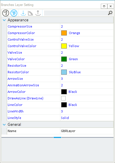

Branches Layer Setting: for each network in the map window, the user can modify the appearance of the network’s branches by specifying the size and color of the branch symbol (which depends on the type of network), the line width (
LineWidth) and style (LineStyle) of pipelines and electric lines, and the color and size of the arrow symbol used in the map view or in an animation (ArrowSize,AnimationArrowSize,ArrowColor) (Figure 23). -

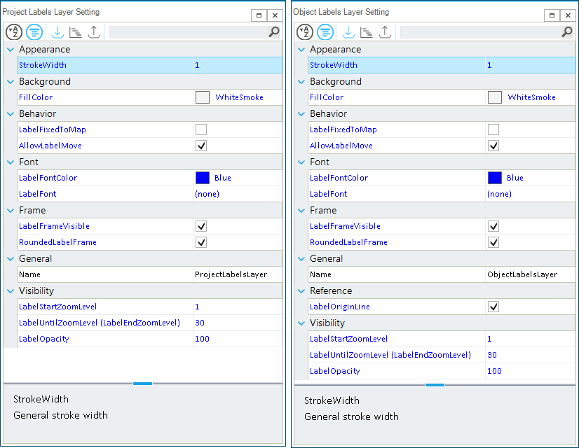

Project Labels Layer Setting: the user can control the graphical properties and placement behavior of project labels by changing border and fill color, transparency, font attributes, framework type, and size, and zoom range (Figure 24, left).
Object Labels Layer Setting: the user has the same level of control for object labels as for project labels. With the exception of the callout (
LabelOriginLine), project and object labels share the same properties (Figure 24, right). For more details refer to the section Labels and label properties. For more details, refer to the section Labels and label properties.
Finally, it is possible to use the layers window to quickly re-center the map view to display the full extent of one of the loaded networks. Just double-click with the right mouse button on the entry "Gas Network", "Electric Network", or "Thermal Network" to center the map view to that network. On the other hand, by clicking with the mouse wheel in the map view, the extent is refresh to show all loaded networks.
User-specified object-level graphical settings have higher priority than user-specified layer-level graphical settings. For example, changing the size of nodes from the layers window affects all nodes, apart from the ones where the size is already specified using the node property editor (i.e., at the object level). |

4.4. Node bar
The node bar displays externals and branches connected to the selected node. The user can choose different display options of the node bar using the Show Id and Cluster located on the bottom right of the node bar window. The first option labels each element in the node bar with its full identifier. The second option groups objects of the same type together and labels them by type if "Show ID" is also active. An example is shown in Figure 25. The Node bar window is generally located on the right side of the map window. By default is docked. The other editable property of the node bar is its background color. Open the context menu by right-clicking on any empty area of the window.
The color of the main horizontal line follows the rule: red if the node has only demand externals linked, green for only supplying externals, and orange for a mixed situation.
Each element connected to a node is also associated with an arrow. The direction of an arrow in the node bar indicates:
- All Networks
- Demand
Outwards directional arrow.
- Branches
Depends on the defined
FromNodeandToNodeof the branch.
- Gas and Electric Networks
- Storages
Bi-directional arrow.
- Gas and Thermal Networks
- Supply
Inwards directional arrow
- Electric Networks
- Generator
Inwards directional arrow.
- Shunt
The user can choose different display options for the node bar using the ShowId and Cluster located on the bottom right of the node bar window. |
4.5. Map selection filter
The map selection filter is shown in Figure 26. It is used for filtering the selection of network objects in the map window using the shift key and holding the left mouse button.
When an entry is unchecked from the selection filter, all the associated objects will not be selectable any more in the map window.

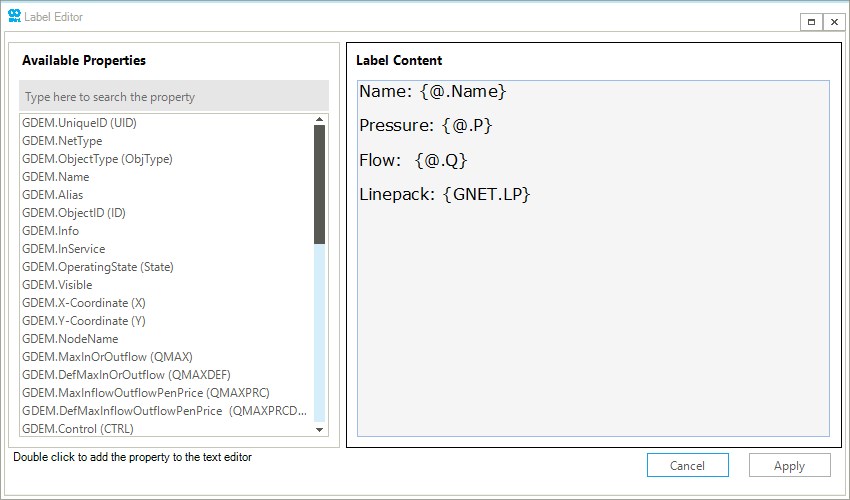

4.6. Labels and label properties
Labels are a flexible tool to display properties or results for a specific object (i.e., an "object label" or a "network label") or to add text and information to a map window (i.e., a "project label"). The user can simply add a label to an object from the context menu with Add New Object Label To after selecting the object. Or add a network or project label to a map view using the context menu after right-clicking in any area of the view away from objects.
A "project label" only accepts free text. Compared to object or network labels, the syntax used for extracting and displaying properties or results is not interpreted but is considered as a normal string. Furthermore, a project label is not linked to any network, so it is displayed even when there is no network at all. For this reason, project labels are great for having informative text describing your project.
For more details, check the How-to guides "Add Labels" and "Edit Labels".
Once a label is added, it is possible to personalize its content and graphical appearance through the property editor. The user can access the property editor for a label either by selecting the label if a property editor was already open or by right-clicking on the label and from the context menu select Open Editor. Figure 27 shows an example of the property editor for a label linked to a GDEM object. The user can modify:
the appearance of the frame around the label by setting the stroke width (
StokeWidthunder Appearance); -
the fill color of the label frame (
FillColorunder Background); -
the color and visibility of the label frame, along with the type of corners (i.e., round or sharpe)(
FrameColor,LabelFrameVisible, andRoundLabelFrameunder Content); -
the size of the frame for height, width, and aspect ratio (
Width,Height, andKeepAspectRatiounder Size); -
if the frame has a callout to the object linked to the label (
LabelOriginLineunder Reference); -
the visibility of the label can be turned off or on, as well as the transparency of the label or the zoom range for which the label is drawn can be changed (
LabelVisible,LabelStartZoomLevel,LabelEndZoomLevel, andLabelOpacityunder Visibility); -
the label position either based on the map view coordinates or relative to the position of the linked object with screen coordinates (
X,Y,XLOFF, andYLOFFunder Position); -
if a label is at a fixed position or can be moved around the map window if the position is based on map coordinates (the
XandYof the section Position) or as offset from the linked object (theXLOFFandYLOFF), and if the label size must be rescaled based on the zoom level or fixed to a specific size (AllowLabelMove,LabelFixedToMap, andScaleLabelunder Behavior).
For a detailed description of the property editor, refer to Section 6.
The visibility of a specific label is controlled by its property |
The transparency of the background is controlled either by |
The LabelInfo property under Content allows the user to modify the default content of any label. By clicking on the three dots next to the string content of the LabelInfo property, the Label Editor opens (Figure 28). In the label editor, the user can mix free text with tags for the object’s properties and results of simulations. On the left side, a filtrable list is available with all properties and results for the object type the label is linked to. On the right side, the user can compose the content of the label using a simple syntax. Properties or results are indicated by {@.PROPERTY} where the object is either explicitly mentioned or implicitly referred to using @ (i.e., the same object linked to the label). A property is indicated using the property symbol in SAInt. It is possible to indicate the unit of measurement for the selected property even if different from the one specified in the general settings of SAInt. The syntax of the tag requires that the fields used are separated by a dot and within curly brackets as in {@.XXX.YYY.[xxx]}. In the example of Figure 28, the label for this GDEM object will show the name of the demand external, its pressure, the outflow, and the network linepack on four different lines. All numeric values use the project settings units of measurement and are valid for the active simulation time step or network state.
For details on how to use the label editor and examples of label syntax, refer to the How-To guide Edit Labels.
Label properties defined in the context menu accessible from the Layers Window have lower priority over the properties defined at single label level. |

5. Script editor
The script editor is accessible from the tab "View" and the menu entry Script. The user can either create a new script using the option Create New IronPython Script or load an existing script using Open Ironpython Script. The script editor allows the user to create and save customized codes using IronPython functionalities. Similar to the command window, it uses the IntelliSense feature to guide the user in entering the commands. Lines are numbered for convenience, and different colors are used to help the user to navigate the code and quickly recognize the type of command used. An example of using the script editor is shown in Figure 29.
nplot commands.In the top section of the script editor window, four customizable buttons are available for a quick access to the following options:
- Execute script
Executes the current script. SAInt objects referred in the code are accessed based on either the active time step or the solved solution for the active scenario.
- Save script
Saves the current script with
*.ipyextension. - Undo changes
Undo the recent changes in the script.
- Redo changes
Redo the recent changes in the script.
Buttons can be customized using the context menu at the right side of the buttons bar.
The user can also change the zoom level of the text of the script editor by pressing CTRL and using the wheel of the mouse.
Errors or exceptions caused by the execution of IronPython scripts are reported by SAInt using a pop-up window.
You can start learning more on expressions and functions by looking at the section "Functions, Expressions and Conditions" of the reference guide. |

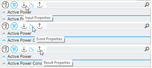

6. Property editor
The property editor is accessible from the window "Property Editor" located on the right-most window of the SAInt-GUI or from the tab "View" and the menu entry Script in the tab "View". The property editor allows the user to edit all types of properties of a network’s object or a scenario’s event. The editor filters the list of properties depending on the type of selected object or loaded scenario.
Figure 30 shows examples of the property editor window when an object (left, center) or a scenario event are selected (right). The figure shows how the property editor window is divided into three areas: the toolbar at the top, the "table" section in the middle, and the "information box" at the bottom.
The toolbar has two buttons (i.e., first two icons on the left), three tabs and a search bar, as shown in Figure 31. By hovering the pointer over the tabs a description is displayed. The available options are:
- Sort alphabetically button
Sorts the properties alphabetically (A-Z or Z-A).
- List button
Sorts the properties by category.
- Input tab
Shows the input properties, which are properties related to the network object.
- Event tab
Shows the event properties, which are properties related to the specified event.
- Results tab
Shows the result properties corresponding to the loaded scenario.
- Search bar
Searches for a specific property.
The "table" section of the property editor has two columns. The left column has the property names, while the right column has the corresponding property values (Figure 32).
The user can modify any property in blue by double-clicking on the property value or using the Edit option from the context menu. The following options are available in the context menu:
- Reset
Resets the property value to default or previous value.
- Edit
Edits the property.
- Expand
This option is only active when a property contains a list.
- Sort
Sorts the properties alphabetically, by category, and alphabetically categorized. Selecting this option changes the entire property editor.
- Show description
Controls the visibility (

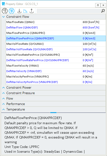

The left side of the value cell shows three different types of symbols, depending on the property type, when the user clicks to modify the cell’s value. One option is to have a triangle-shaped symbol, which indicates the presence of a drop-down menu to select a possible value from a validated list. When a numeric field is selected, a second option is available. Next to the numeric area the user has the indication of the unit of measure, optionally the symbols for plus and minus infinite, and small triangle-shaped buttons to increase or decrease the numerical value. The third option is to have a small triangle-shaped symbol inside a circle next to the name of the property (i.e., on the left side of the cell value field), by clicking on the symbol the cells unfolds revealing a nested hierarchy of child properties. A good example is under "Topology" the entry "Points" for an electric line or a pipeline object.
The user can only edit the properties with blue color. The non-editable properties are in black. |
The property editor for different object types can be accessed in a variety of ways in SAInt-GUI:
Objects: The property editor for each network object (e.g., EDEM, TNET, GNO, EDGCS) is available from the context menu after selection of the object either in the map window, the model explorer, or the node bar. Just choose the entry Open Editor.
Scenarios: The property editor for a scenario event (e.g.,
PSET,VOLSET,FuelPrice, etc.) is accessible from:-
Scenario Tab: by selecting an event in the scenario table under the Scenario tab and button GSCE for a gas scenario, ESCE for an electric scenario, or TSCE for a thermal scenario.
Project Explorer: Selecting the scenario from the entry Scenario Files in the project explorer and using the open editor option from the context menu.
Network editor: The property editor for a network is accessible from the following locations:
Network tab: Clicking on the button GNET, ENET, TNET or HUBS, for a gas, and electric, a thermal or a hub system respectively, under the Network tab in the ribbon bar
Map window: Using the entry , , , or from the context menu of the Map Window. To access these context menu options, no network objects should be selected.
Model explorer: Selecting a network and using the entry Open Editor from the context menu of the network object.
Project explorer: Selecting the network from network files and using the entry Open Editor option from the context menu of the network.

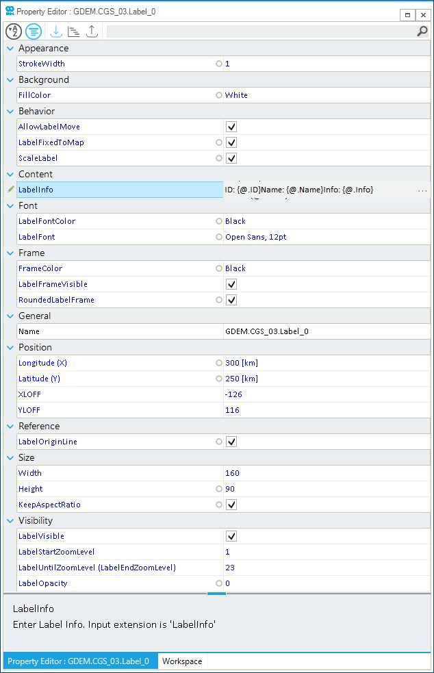

Label editor: The property editor for a label is accessible from the map window, after selecting the label, by choosing the entry Open Editor of the context menu.
If the property editor is open, its content will adapt automatically to the object selected by the user.
The user can interact with multiple objects of the same type in a multi-edit session of the property editor. Simply select the set of objects of the same type either in the map window or the model explorer and from the context menu choose Multi Edit. The title bar of the property editor will report the number of objects selected. The list of properties is filtered so that the editable ones are available. If an entry is empty, the selected objects have different values for the field. When the value is the same among all objects, it is available in the multi-edit window. |
7. Workspace
The workspace is accessible from the tab "Workspace" located on the right-most window of the SAInt-GUI. It is in auto-hide mode by default. It lists the predefined functions used in the command window and script editor of SAInt. The list includes the name, syntax, and the description of the functions. A snapshot of the part of workspace is shown in Figure 33. It consists of three columns:
- First column
Name of the function or command.
- Second column
Type of the command. This column is related to the icon used on the row for the entry. Where, for example, a "function" type uses an icon with "fX", or a Boolean type uses two intersecting circles. Other types are: string, list, or float.
- Third column
Description of the function.
The user can interact with the workspace window by:
- Sorting
The columns can be sorted alphabetically by clicking on the column headers.
- Filtering
The filtering options for the columns can be accessed by clicking the filter icon next to the column name.
- Moving
The columns location can be changed by dragging the column to the desired location.
- Grouping
The columns can be grouped by
Name,Type, andValue/Descriptionby dragging the column header to the top of the workspace table in the row that says ""Drag column here to group by this column. - Search
The search bar is available in the filtering options (filter icon next to the title) for each column.
8. Command window
The command window is located on the bottom-left below the map window by default. It is a platform that uses pre-defined functions in an IronPython environment to perform various tasks such as mark objects, create plots, tables, or evaluate properties. It uses IntelliSense features to guide the user in entering commands. An example of using the command window is shown in Figure 34.
Name of an electric node or to evaluate an expression where the condition VPU>0.99 is satisfied.9. Log window
The log window is by default in the bottom-right area below the map window. It is the primary source of information for SAInt-GUI operations. It shows the log for network and scenario operations including the simulation or optimization logs. Figure 35 and Figure 36 shows the snapshot of the log window showing the operation and simulation logs, respectively. It has two columns with available filtering options such as contains, not contains, starts with, ends with, equal to.
The first column reports the start date and time of the operation/simulation. The time and date is based on the settings of the computer used to run SAInt.
The second column reports the message from the SAInt solver or GUI for the specific action taking place. Colors are used in simulation or optimization logs to indicate warnings (yellow) or errors (red). Other informative messages use shades of green.

SAInt has two types of charts: plots for an object’s properties and plots for events associated with it. From an entity’s context menu, it is possible to clearly choose between "Plot Window" for the first type and "Plot Event" for the second type. See Figure 39 for an example.
In the "Plot Window" class, SAInt provides the user with the option of creating and personalizing a "Default Plot" for the selected object. Default plots can be changed by modifying the linked plotting command from the general "Settings" ("Default chart"). The user can change any default chart with a new one, or modify the colors, the legend and title, or the type of chart for a specific property. The default charts can be saved to an external file and restored from an external file.
The "Event Plot" class is available only for events. Depending on the type of network and the type of event, the event chart has a specific graphical output. In an event plot the user can see all or some of the following elements (Figure 40 and Figure 41):
time annotations with some vertical text, which can be toggled on or off from the chart context menu. There are different types of annotations:
the scenario start time indicated by a vertical annotation stating "ScenarioStartTime" followed by the date and time.
a profile start and end time by vertical annotations stating "ProfileStartTime" and " ProfileEndTime" followed by the date and time. The user can see the actual time span of the original data of a profile.
the event start time is indicated by a vertical annotation stating "EventStartTime" followed by the date and time of the event.
axis:
the horizontal axis is always representing time.
the left vertical axis describes either the control modes of the object associated with the event or the user-specified values for the event. When the control mode is plotted, the state of all events in the scenario for the same object is reported.
the right vertical axis describes the event’s values (or the value multiplied by a profile) if the left vertical axis is describing the control modes.
graphical elements with a color-coded meaning:
when present, a "green" line indicates the user-specified "value" for the event (or the value multiplied by a profile) in the time window defined by the "event start time" up to either the end of the scenario or to the next event for the object. The plotted values are not to be confused with the actual computed values by SAInt, as the two sets may be different because of constraints handling and penalty prices.
a "blue" line indicates either the sequence of events associated to the object in the active scenario or the user-specified "value" for the event (or the value multiplied by a profile). The user-specified values are present only when the event has no control mode associated. Otherwise, the control mode is represented in blue, and the user-specified values in green. It is important to stress that the realized sequence of events or values during a simulation may be different from the planned in the scenario as constraint handling may occur.
for gas events, a "purple" line over the blue line indicates the portion of the chart referring to the selected event. If an object is associated to multiple consecutive events, SAInt indicates the section of the chart for the selected event used for creating the chart with a purple overlapping line to the blue line.
when present, a "pink" line indicates a user-defined default value linked to an object. This is useful for comparison. The default value is, generally, indicated with an axis on the right side of the chart.
for electric events, when present, a "red" line indicates the evolution of the event value before the selected event start time.
graphical elements with a style-coded meaning:
a continuous line indicates a sequence of (active or not) events or values as specified for a certain object in the active scenario. For example, a continuous line is expected to be used for green, blue or red lines.
for gas events, a dashed line indicates the time window in a simulation defined by the start time and the first user-specified event in the active scenario. This line pattern indicates what is inherited from the initialization state. This is equivalent to the use of a red line in charts of electric events. We avoided to add the red color to gas event charts to reduce the total number of colors.
POSET event for a gas control valve GCV.CV_1 object (top) and for a QSET event with a profile for a gas demand GDEM.CGS_08 object (bottom). The graphical elements in the charts demonstrate the set of rules valid for an event chart.
PSET event for an electric generic generator XGEN.COGEN object (top) and for a PHISET event with a profile for a thermal demand HDEM.N05 object (bottom). The graphical elements in the charts demonstrate the set of rules valid for an event chart.
