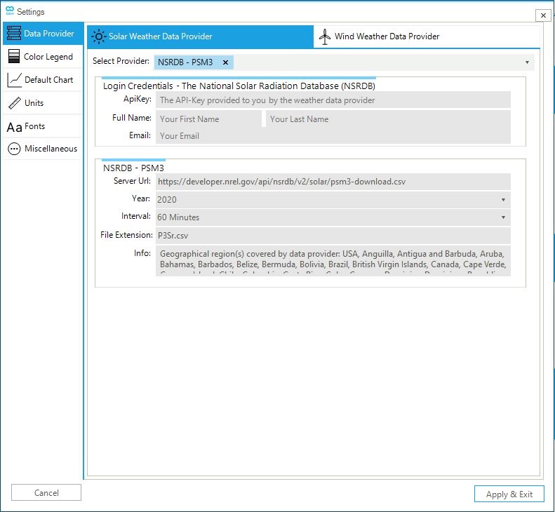

1. Connecting to a data provider
The user can access the entry point to connect SAInt to a data provider by selecting from the button
. Each data provider has a unique server URL pointing to the relevant database as shown in Figure 1.
The data provider tab allows the user to choose between solar or wind databases, and the relevant options are:
- Select provider
The user can select from a list of multiple data providers for different weather resource databases. See Table 1 and Table 2 for more information on solar and wind weather data provider and their coverage area, respectively.
- API key
To access some of the data services, the user must register with the data provider and obtain an API key. The API key must be passed to SAInt provided so that the user is authorized to request and retrieve the data.
- Full name
First and last names of the user used during the registration phase.
Email used during the registration phase.
- Server URL
Links to the data provider’s server URL. Refer to Table 1 and Table 2 for the list of server URLs for solar and wind weather data providers, respectively. The list of server URLs can also be found in the
DataProviderURL.txtfile in theDataImportfolder. - Year
Selection of different weather year(s) available from the corresponding weather resource database. For each database, SAInt shows the available options.
- Interval
Selection of different temporal resolution(s) available for the corresponding weather resource database. For each database, SAInt shows the available options.
- File extension
The option allows the user to define a custom file extension for the downloaded weather data file(s).
- Info
The option provides information about the weather resource database, such as the geographical region(s) covered by the data provider.
The list of the weather data provider(s) selected in the data provider tab will be displayed in the collect weather data wizard. The wizard will not be available to the user if nothing is selected.
The value of the The file SAInt saves the details provided by the user for any data provider in the fodler |

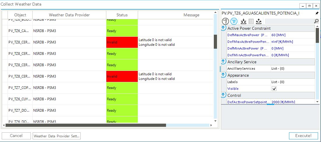

2. Collecting weather data from a data provider
Once a connection between SAInt and a data provider has been defined, as described in Section 1, the user can collect weather data directly within SAInt via the collect weather data wizard, as shown in Figure 4. PV and WIND weather resource data need to be collected separately since one collect weather data wizard (either for PV or WIND) can be accessed at a time. In the same session, different weather data providers can be accessed for each object of the same type.
The main options of the collect weather data wizard are:
- Object
This option provides a list of the solar or wind generators selected to collect the weather resource data.
- Weather data provider
This option shows which data provider will be used to collect the weather resource data.
- Status
The field reports any issues with the object properties defined by the user or connecting and downloading data from the data provider.
- Message
The field provides the user with feedbacks on any issue in the definition of the object properties or while downloading the weather resource data.
- Action
The option allows the user to define whether to consider an object when downloading data.
Continuewill consider the object when downloading the weather resource data, whileSkipwill skip the selected object. - Property editor
The option opens the property editor of the selected object allowing the user to edit the properties of the object.
- Weather data provider setting
The option opens the data provider wizard, allowing the user to edit the configuration of the weather data providers.
- Execute!
The option downloads weather resource data and saves the corresponding files in the project folder.
Before downloading any data, the user should ensure all objects' status is Ready or any action is set to Skip, if needed. Once the weather data file has been created, the status will change to Downloading and Done. If an error occurs, the status changes to ServerError, and a message is provided.
The weather resource data for solar and wind generators are retrieved according to the latitude and longitude properties of the object(s). |

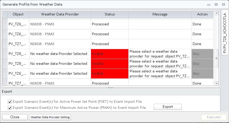

The options for the generator profile from the weather data wizard are:
- Object
The option provides a list of all the solar or wind generators selected to collect the resource weather data.
The option shows which data provider was used to collecting the weather resource data. If no weather data was collected, the user an error message is provided.
- Status
The field diagnoses any issues with the object or weather data file.
- Message
The field gives the user feedback on any issue in the definition of the object properties or while downloading the weather resource data.
- Action
The option allows the user to define whether to consider an object or not when calculating the generation profile.
Continuewill consider the object during calculation, whileSkipwill skip the selected object. - Property editor
the option opens the property editor of the selected object and allows editing of the properties of the object.
- Export
The option allows the user to create import files for the profile and scenario event(s) of the generator(s). If a scenario file is open during this process, the user can directly add the generator profile and scenario event(s) into the scenario file.
- Execute!
The option calculates the generation profile time series that is saved in the profile table.
Before creating the generation profile, the user should ensure all objects' status are Ready or action is set to Skip if needed. Once the profile time series have been calculated, the status and action will change to Processed and Done, respectively. If an error occurs the status changes to Invalid. The profile can be assigned to either a PSET or PMAX scenario event for the solar and wind generators.
When successfully exporting profile and/or scenario event(s) for the selected generator(s), the log file reads "Export of Profile and Scenario Event(s) for the selected Generator(s) completed" if both "export events" are selected, or "Export of Profile for the selected Generator(s) completed" if only one of the two "export events" is selected. |
When missing values are present in the source data, retrieved from the weather data provider, SAInt performs a linear interpolation of the available information. The user is informed by a message in the Log Window stating, for example, "N/A or missing values in "wind speed at 10m (m/s)" column have been linearly interpolated using the existing data".
If the entire record is missing and no interpolation is possible, the user is informed by reporting an error message stating "The given array is too small. It must be at least 2 long. Parameter name: x" in the "Message" box of the weather data window.
