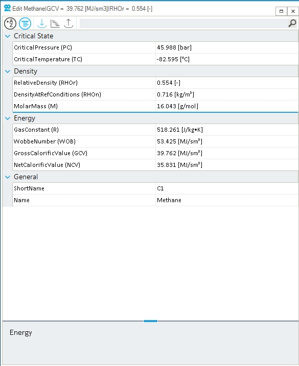

 | Gas Quality | Models the thermo dynamic properties (gross/net calorific value, relative density, etc.) and the mixtures of different gas molecules (gas components) flowing through the network | |
 | Gas Component | Models the thermo dynamic properties (gross/net calorific value, relative density, etc.) of a gas molecule included in the gas mixture | |
 | Gas Component Usage | Models the molar percentage of mixture of a gas component included in a gas quality |

6.1. Gas component (GCMP)
SAInt is not limited to model transportation and distribution of natural gas. It can effortlessly model a wide variety of gas mixtures (i.e., a gas quality) by creating and managing gas components. SAInt offers a built-in library of common gas components to create and adapt a gas quality to the user’s specific needs. It also provides a straightforward and simple capability for defining a new component when not available. Gas components can be mixed to obtain a certain gas quality, whose properties are estimated by SAInt or derived by the user inputs.
A gas component represents a pure chemical species to be used for the creation of gas quality objects. Every gas network has a list of gas component objects that can be used to define gas qualities. The list of gas components contains, by default, only methane and can be expanded by picking more gas components from the built-in library available in SAInt. New custom gas component objects can also be defined.
The library covers the main hydrocarbons and the most common impurities and can be easily extended. The full list of components, and associated SAInt code in brackets, is:
- Hydrocarbons
methane (C1), ethane (C2), propane (C3), iso-butane (IC4), n-butane (NC4), iso-pentane (IC5), n-pentane (NC5), n-hexane (NC6), n-heptane (NC7), n-octane (NC8), n-nonane (NC9), n-decane (NC10);
- Non Hydrocarbons
where we can distinguish inert gases like nitrogen (N2), rare gasses like argon (AR) and helium (HE), impurities like hydrogen sulfide (H2S), water (H2O), oxygen (O2), carbon monoxide (CO), or carbon dioxide (CO2), and other gasses like hydrogen (H2).
| In brackets is reported the string used for the property  |
A gas component has a set of physical and energy related properties. As an example, Figure 2 shows the properties for methane. Please, note that the properties of the components in the built-in library cannot be edited. The user can only modify the properties of user-defined components.
Gas components, as gas qualities, are objects within a network object.
The physical and energy properties (e.g., gross/net calorific value, relative density, molar mass, etc.) of a gas component included in SAInt built-in library cannot be edited. In the case of a custom gas component, specific properties can be described in input.

| GCV | Gross calorific value | |
| Name | Object Name. Permitted characters are letters, numbers, and underscore ("_"). The name should start with a letter. The name should be unique for each object type. | |
| NCV | Net calorific value | |
| RHOr | Relative density | |
| ShortName | Short name of fluid component used as an extension to access mixture fraction |
Refer to the following How-Tos for more details on Add a Gas Component, Create and Edit a Gas Quality in the GUI, or How to Import/Export Gas Qualities.
