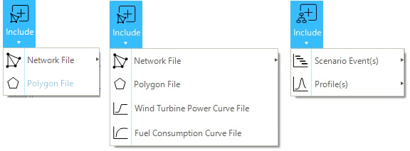

This section provides an overview of the different methods to include, in the active project, data from SAInt native files. SAInt native files are generated during a working session or after using export methods (described in "Exporting Network & Scenario Data"). Different SAInt data files can be included either at the network or scenario levels, but the associated options are - generally - available when a network or a scenario object is active. The option of including is available from or from . Figure 1 shows the two buttons and menus used for including data.

The options presented in this section are available either from an empty project or when a network model is active. The user can choose these options to add data to the network using existing SAInt native files. These options can be accessed using Include in the data panel under the Network tab and cover vertices, labels, polygons, and wind turbine power curve data (Figure 1, left and center).

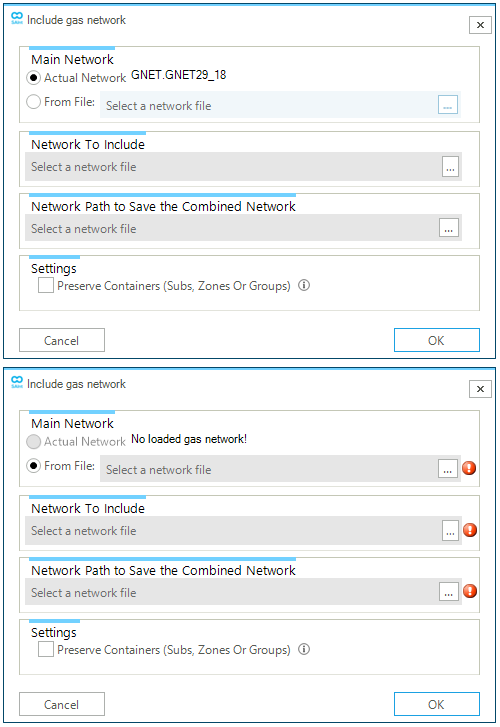

SAInt allows the inclusion of already developed single-energy carrier networks into an existing network of the same type. Hubs cannot be included. Figure 2 shows the interface for including an external network into a network available in an active session of SAInt (top) or for including an external network into another network when an empty project is active in a SAInt session (bottom). The option is available via the menu .
When including an external network to a network available in the active session (Figure 2, top), the user must specify the name of the "Network To Include" and the "Network Path to Save the Combined Network". The "Main Network" field reports the name of the active network. Finally, there is an option to preserve subs, zones, or groups from the incoming network. SAInt may change the names of duplicate objects by adding "_1" (or "_2" and so on).
When including an external network to a network not available in the active session (Figure 2, bottom), the user must, first, specify the file of the "Main Network" in the "From file" field, and after the "Network To Include" and the "Network Path to Save the Combined Network". Again, the "Preserve Containers" is an option.
It is important to note that the location of the network to be included and the joined network must be different (see exclamation mark symbol in Figure 2, bottom). SAInt performs a check and if paths and names are the same, it prevents the operation.

The options presented in this section are only available when a scenario is active. The user can choose these options to add data to an active scenario using existing SAInt native files. These options can be accessed using Include in the data panel under the Scenario tab and cover scenario events and profiles (Figure 1 right).
