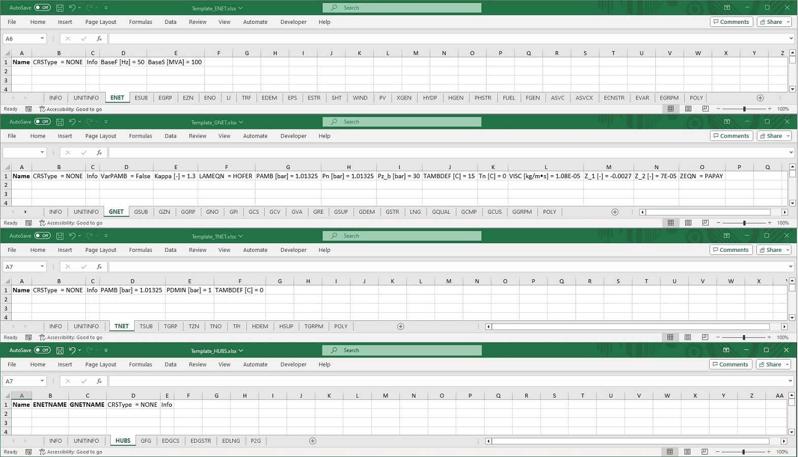

1. Network template file
A network template file is a multi-sheet Excel spreadsheet file. It allows designing a network by specifying all its characteristics, the full list of objects to include, and their properties. A network is independent of the scenario type implemented in a simulation, and therefore there is no scenario-related information in the template. Figure 1 shows the four templates available in the directory Network of the folder DataImport. They are the template for an electric network (*.ENET, middle-top), the template for a gas network (*.GNET, middle), the template for a thermal network (*.TNET, middle-bottom), and the template for a hub system (*.HUBS, bottom).
The structure of a template is the same for all types of networks. The first two sheets report the list of extensions with displayed names and descriptions (the INFO sheet) and the list of units of measurement with descriptions and aliases used in all other sheets (the UNITINFO). Then, there is a set of sheets for the containers. The sheet name depends on the type of system and its content on the type of object. There are four sheets: a network sheet, a subset sheet, a zone sheet, and a group sheet. The remaining template sheets cover the objects of the specific network type. There is a sheet for nodes and another for each type of supported branch. Finally, there could be sheets covering other aspects of a network like gas quality in gas systems or ancillary services in electric systems. The POLY sheet at the end represents vertices in branches describing bending lines and turns.
Except for the first two information sheets, all the remaining ones share a common structure: a header row and data rows. The data rows are empty as the user is supposed to fill in the data. The header row reports the column’s name based on a predefined format: object "extension", the unit of measurement, the symbol =, and a numerical/Boolean value to be used as reference. Default units and values are used if only the extension is reported. When it comes to the extension Name only the name of the object is required.
SAInt automatically checks the header. If the header format is not respected, it returns an error for the import process. The user is informed to take action.
Custom column headers and sheets are allowed in the network import template. SAInt will not take them into account during the import procedure. The details of what has been taken into consideration and what not is logged for the user.
The file Template_ENET.xlsx allows the creation of a network import file of an electric network. The file Template_GNET.xlsx allows allows the creation of a network import file of a gas network. The file Template_TNET.xlsx allows allows the creation of a network import file of a thermal network. The file Template_HUBS.xlsx allows allows the creation of a network import file representing an HUB system. An HUB system combines different types of networks, and it defines which objects are coupled (i.e., using HUB objects) between the network types. A HUB system requires to create — at least — two separate networks (e.g., an *.ENET and a *.GNET), and after specifying the HUB objects.
For a detailed description of the network’s objects and their properties, please check the section "Electric Objects", the section "Gas Objects", the section "Thermal Objects", and the section "Hub Objects".
Even if an *.ENET file is applicable for different scenario types, objects and properties are different per scenario type. For example, a transformer object (TRF) is treated as an electric line (LI) in a DCUCOPF scenario, while it is treated as a transformer in an ACPF scenario. Reactive power is not considered in a DCUCOPF scenario, but it is for an ACPF scenario. |

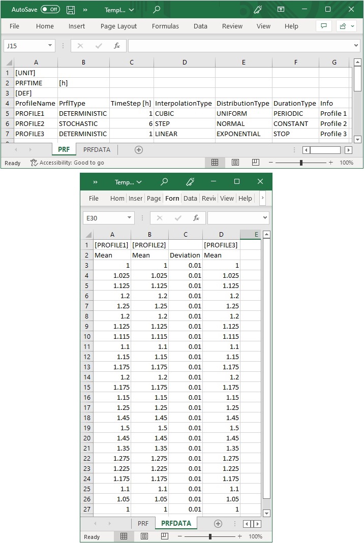

2. Profile Template
Profiles can be imported into SAInt by single-sheet format files either in Excel or in text format. The Excel file Template_Profile_Import.xlsx is, probably, the easiest options, because it constraints the user to follow a clear predefined layout, and quickly organize the data in a spreadsheet. Figure 1 describes how the data for three different types of profiles must be organized in two sheets named PRF and PRFDATA.
The example shows three hourly profiles (see the PRFTIME parameter set to [h]), called PROFILE1, PROFILE2, and PROFILE3 (see the ProfileName property). All general properties of a profile are reported in PRF. PROFILE1 is a deterministic profile, with a timestep of one hour, a cubic interpolation between steps, and its duration is set to periodic. The Info property can hold any additional piece of information deemed useful by the user. For this profile, the property DistributionType is not relevant and set to UNIFORM to showcase the three most common distribution types in SAInt (i.e., uniform, normal, and exponential distribution). The actual values of a profile are reported in PRFDATA. There profiles are organized in columns, starting with the name in square brackets in the first cell, followed by the label Mean or Deviation, and the numeric values of the profile steps. The label Mean is used for all types of profiles, while Deviation must be specified only for stochastic profile types.
Alternatively, a text file template can be used. The structure of the template mimics the one in an Excel file. The file starts with the information of the PRF sheet, and it reports sequentially the values of each profile. See the following example. Please, remember that cells with any value are separated by a tab.
Example: Single-sheet format example in text format. The sequence "->" represents a TAB. A line starting with % indicates a comment.
[UNIT] PRFTIME -> [h] [DEF] %ProfileName -> ProfileType -> TimeStep -> Interpolation -> Distribution -> Duration PROFILE1 -> DETERMINISTIC -> 1 -> CUBIC -> UNIFORM -> CONSTANT PROFILE2 -> STOCHASTIC -> 6 -> STEP -> NORMAL -> PERIODIC PROFILE3 -> DETERMINISTIC -> 1 -> LINEAR -> EXPONENTIAL -> STOP [PROFILE1] 1 1.025 ... 1.05 [PROFILE2] %MEAN -> DEVIATION 1.125 -> 0.01 1.115 -> 0.01 ... -> ... 1.05 -> 0.01 [PROFILE3] 1 1.025 ... 1.05
If the user imports a duplicate of an existing profile, SAInt creates a new copy and modifies the name of the imported instance appending |

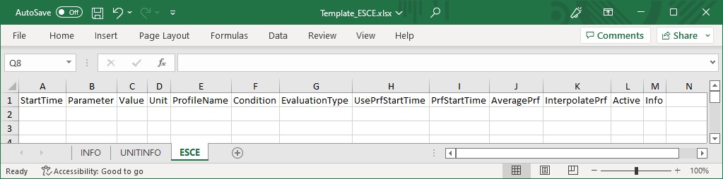

3. Scenario events template
Scenario events can be imported into SAInt by single-sheet format files either in Excel or in text format (e.g., text TAB delimited *.txt files, or text comma separated *.csv files). In the Scenario directory of the DataImport the user can find the Excel templates. Examples of the other formats can be generated by exporting a scenario created in SAInt and checking the structure. The Excel template is the preferred solution as it is very easy to use, adapt, and process.
A scenario events file allows creating a list of events for any object in the active network and defining its relevant properties. The available events depend on the type of network considered.
The Excel file Template_ESCE.xlsx is designed to create an electric scenario. Figure 3 shows an empty template. The same ESCE is used for all the electric scenario types (SteadyState, QuasiDynamic, and Dynamic). The information needed is:
