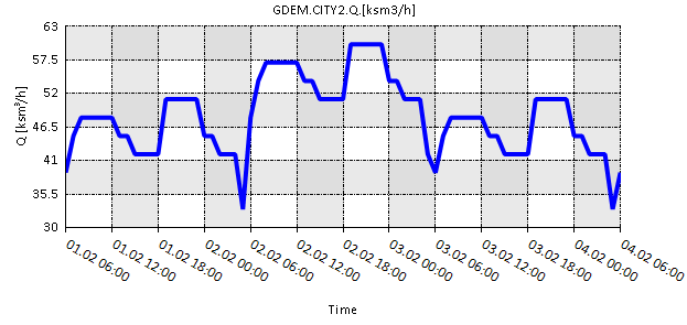

plot('GDEM.CITY2.Q.[ksm3/h];4')-
Plots the satisfied demand, in ksm3/h, of the external CITY2 as lines with a line width of 4.

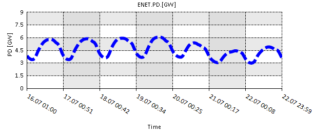

1.2. Line style
The user can specify the style of the line plot from five available line styles in SAInt. The available styles are: dash, dashdot, dot, dashdotdot, and solid. If not specified, solid line style is used as default.
Examples:

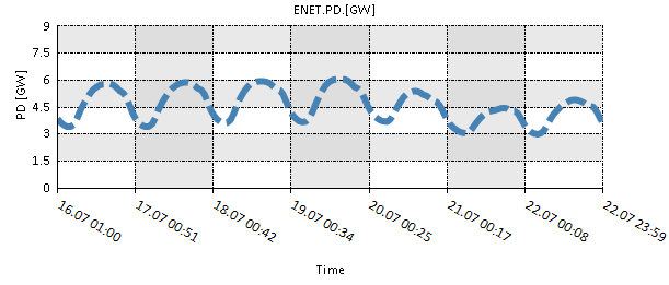

plot('ENET.PD.[GW];6;dash')-
Plots the active power demand, in gigawatt, of the electric network as a line with a line width of 6 and a dash style.

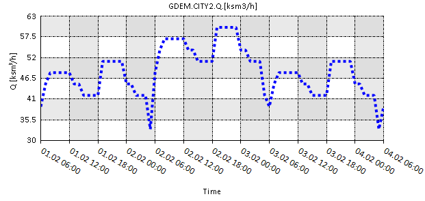

plot('GDEM.CITY2.Q.[ksm3/h];4;dot')-
Plots the satisfied demand, in ksm3/h, of the external CITY2 as lines with a line width of 4 and a dotted style.

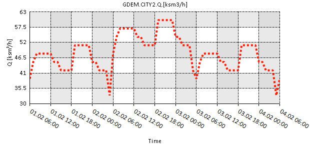

plot('GDEM.CITY2.Q.[ksm3/h];4;dot;R255G25B0')-
Plots the satisfied demand, in ksm3/h, of the external CITY2 as lines with: line width of 4, dotted style, and defining the color using RGB values.

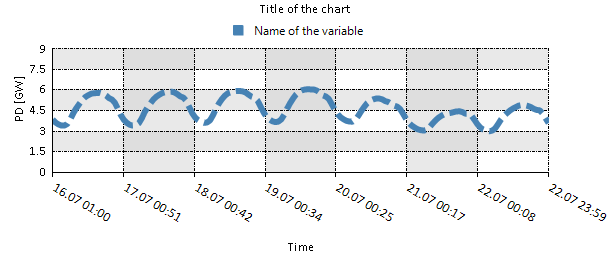

1.4. Chart title and legend
The user can use the title and legend variables in the input expression for all plotting functions to define the title of the plot and the name displayed in the legend box for the parameter, respectively.
The keywords title and legend can start we lower- or upper-case letters. The string passed to the variables cannot be displayed on two lines. Any valid UNICODE character is accepted.
SAInt will automatically order and distribute legend entries.
Examples:
plot('ENET.PD.[GW];6;dash;SteelBlue;title=Title of the chart;legend=Name of the variable')-
Plots the active power demand, in gigawatts, of the electric network with the chart as a line with: line width of 6, dash style, and in steel blue color. A title and a legend are added to the chart.

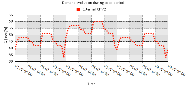

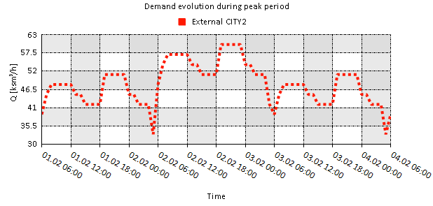

plot('GDEM.CITY2.Q.[ksm3/h];4;dot;R255G25B0;title=Demand evolution during peak period;legend=External CITY2')-
Plots the satisfied demand, in ksm3/h, of the external CITY2 as lines with: line width of 4, dotted style, and color as RGB values. A title and a legend are added to the chart.

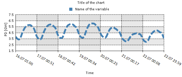

1.5. Maximum, minimum, and number of intervals for y-axis
SAInt allows to customize only the y-axis of any chart. The x-axis is automatically defined based on the simulation length or the selected path in the network.
The user can set the maximum values, the minimum value, and the number of intervals to divide the y-axis. The format of the customization of the axis is: [Max; Min; Number of Intervals].
Examples:
plot('ENET.PD.[GW];6;dash;SteelBlue;title=Title of the chart;legend=Name of the variable;[7.5;1.5;6]')-
Plots the active power demand, in gigawatt, of the electric network with the chart as a line with: line width of 6, dash style, and in steel blue color. A title and a legend are added to the chart. The y-axis is set between 7.5 GW and 1.5 GW with 6 equal intervals of 1 GW each.

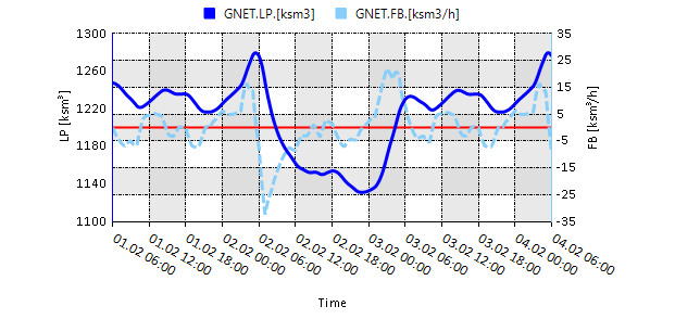

1.6. Reference axis

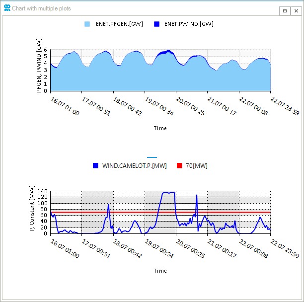

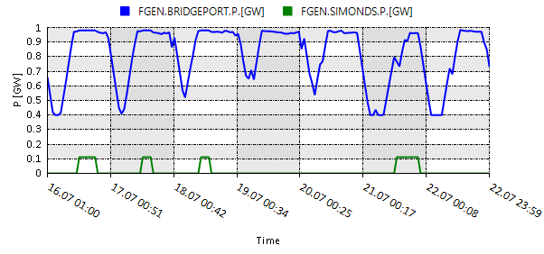

In charts where more than one property is displayed, the user can specify on which y-axis a certain property should be plotted. The left or right y-axis can be selected by using the variable axis in the input expression of the plot functions. This option is helpful to group properties that share the same unit of measure or to programmatically separate properties to make the chart easier to understand.
Note that the option is available only when multiple properties are plotted, so it does not affect the behavior of the plot command.
Valid values for the axis variable are "left" for the left y-axis or "right" for the right y-axis. The keyword axis is optional.
Examples:

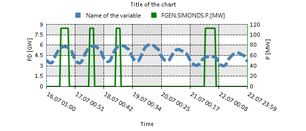

nplot('ENET.PD.[GW];6;dash;SteelBlue;title=Title of the chart;legend=Name of the variable;axis=left','FGEN.SIMONDS.P.[MW];Green;3;[120,0,6];right')-
Plots, on the left y-axis, the active power demand, in gigawatt, of the electric network with the chart as a line with: line width of 6, dash style, and in steel blue color. The y-axis is set between 7.5 GW and 1.5 GW with 6 equal intervals of 1 GW each. The function also plots, on the right y-axis, the active power produced by the object FGEN.SIMONDS in megawatt, with a line in green and a line width of 3. The right y-axis is defined between a maximum of 120 MW and 0 MW, and divided in 6 equal parts.
nplot('GDEM.CITY2.Q.[ksm3/h];4;dot;R255G25B0;title=Demand evolution during peak period;legend=External CITY2;[65;30;7];left','GDEM.CITY2.CTRL;black;right;legend=Control Mode of the External')-
Plots, on the left y-axis, the satisfied demand, in ksm3/h, of the external CITY2 as lines with: line width of 4, dotted style, and color as RGB values. A title and a legend are added to the chart. The y-axis is set between the maximum value of 210 ksm3/h and the minimum value of 90 ksm3/h, and divided into 12 equal intervals. The function also plots, on the right y-axis, the control mode of the external CITY2 during the simulation. A black line with default line-with is used. The legend item for the object is customized.

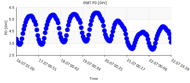

Furthermore, in chart types where two properties are necessary but only one is provided, SAInt uses the time steps.
Examples:
plot('ENET.PD.[GW];scatter;[6.5;2.5;4]')-
Plots the scattered points of the active power served by the electric network against the time steps. The y-axis is defined between 6.5 GW and 2.5 GW, and 4 intervals of 1 GW.

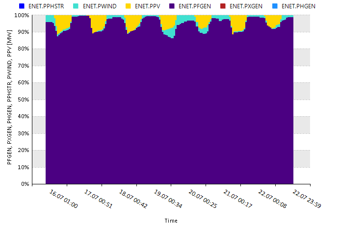

nplot('ENET.PFGEN;stackcolumn100;Indigo','ENET.PXGEN;stackcolumn100;Firebrick','ENET.PHGEN;stackcolumn100;Dodgerblue','ENET.PPHSTR;stackcolumn100;blue','ENET.PWIND;stackcolumn100;Turquoise','ENET.PPV;stackcolumn100;Gold')-
Plots the power generated by the fuel, generic, hydro, pumped hydro storage, wind, and pv generators as relative stack columns plot.
The last example is meant to demonstrate a general form of a s stack column 100 % plot and uses also technologies not available in the model. |

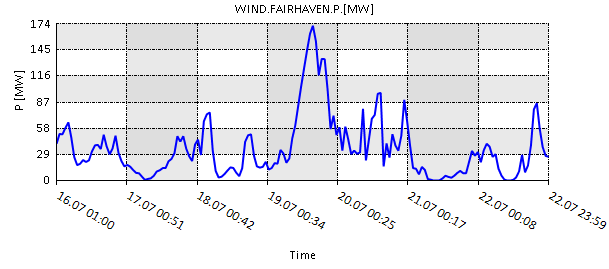

plot('WIND.FAIRHAVEN.P.[MW]')-
Plots the power generated by the wind generator WINDFARM within the

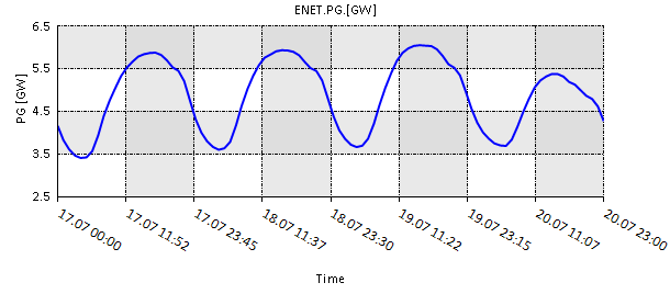

plot('ENET.PG.[GW];[6.5;2.5;4];2','17/07/2023 00:00','20/07/2023 23:00')-
Plots the active power generated by the electric network within the specified start and end time.

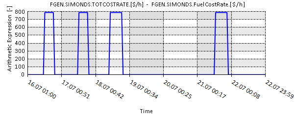

plot('FGEN.SIMONDS.TOTCOSTRATE.[$/h] - FGEN.SIMONDS.FuelCostRate.[$/h];[800;0;8]')-
Plots the difference between the total cost of operating the fuel generator SIMONDS and its fuel cost.

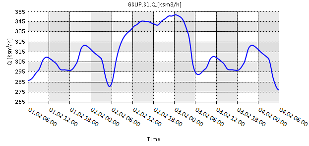

plot('GSUP.S1.Q.[ksm3/h];[355,265,9]')-
Plots the flow from the gas supply S1 within the
ChartStartTimeandChartEndTime. The expression also specifies the y-axis limits and intervals. Refer to Section 1.5 for defining limits and intervals.

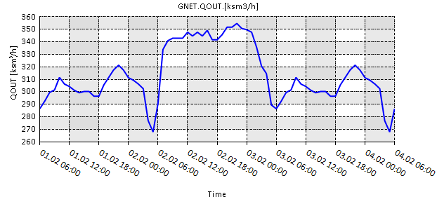

plot('GNET.QOUT.[ksm3/h];[360,260,10]')-
Plots the total outflow of the gas network within the default

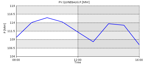

plot('PV.QUINEBAUG.P.[MW]','+8','+16')-
Plots the power generated by the solar generator QUINEBAUG] from the 8th until the 16th hour of the simulation.

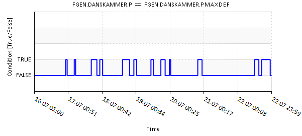

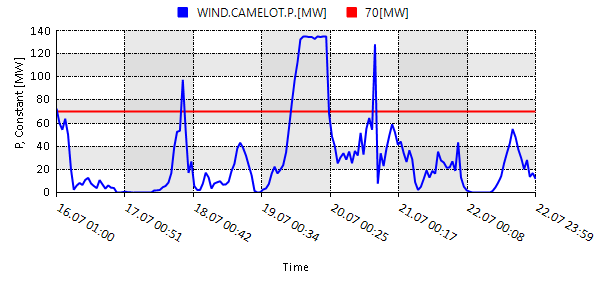

plot('FGEN.DANSKAMMER.P == FGEN.DANSKAMMER.PMAXDEF')-
Plots a Boolean (True/False) graph for the specified input expression.

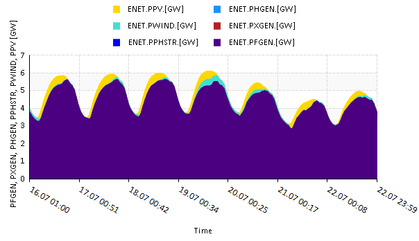

2.2. The function stackplot
stackplot('expr(1)',…,'expr(n)','starttime','endtime')
Creates a single chart with stacked curves specified by the multiple input expressions. If no start and end times are defined, it uses the default start time and end time given by the ChartStartTime and ChartEndTime properties in the scenario editor. An expr is the only mandatory argument.
Example:
stackplot('ENET.PFGEN.[GW];indigo;[7;0;7]','ENET.PXGEN.[GW];firebrick','ENET.PHGEN.[GW];dodgerblue','ENET.PPHSTR.[GW];blue','ENET.PWIND.[GW];turquoise','ENET.PPV.[GW];gold')-
Creates a stack plot of the power generated by all the fuel, generic, hydro, pumped hydro storage, wind, and pv generators. The y-axis boundaries set as 0 and 7 GW with 7 increments. Each generator type has specific color and the position of each stacked curve is defined by the their position in the input expression.

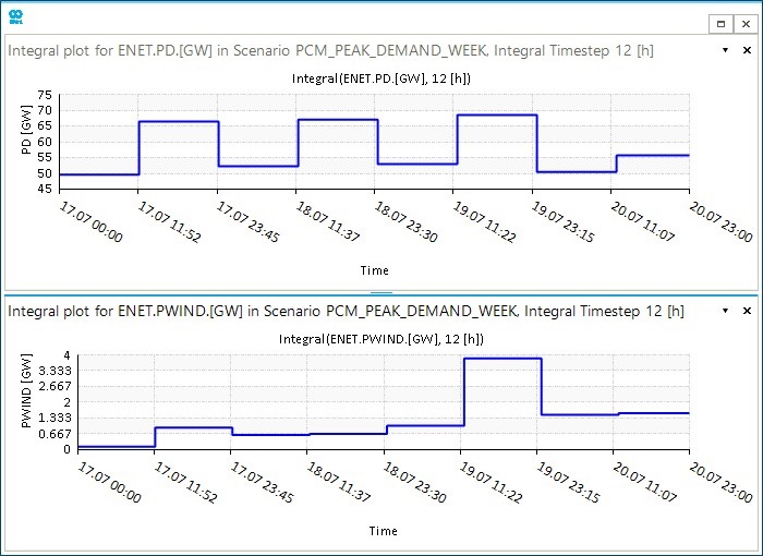

2.3. The function intplot
intplot('expr(1)',…,'expr(n)','integraltimestep','starttime','endtime')
Creates a separate plot with integral values for each of the input expressions. If no start time and end time are defined, it uses the default values specified by the ChartStartTime, and ChartEndTime properties in the scenario editor. The parameter integraltimestep and expr(1) are mandatory.
Examples:

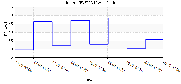

intplot('ENET.PD.[GW];[75;45;6]','12[h]','17/07/2023 00:00','20/07/2023 23:00')-
Plots the integral of the electric network demand using the integral time step, start time and end time specified in the input expression. The integral time step defines a horizon of 12 hours.
intplot('ENET.PD.[GW];[75;45;6]','ENET.PWIND.[GW]','12[h]','17/07/2023 00:00','20/07/2023 23:00')-
Plots the integral of the electric network demand and wind power generation using the integral time step, start time, and end time specified in the input expression.

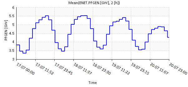

meanplot('expr(1)',…,'expr(n)','meantimestep','starttime','endtime')
Creates a separate plot with mean values for each of the input expression. If no start time and end time are defined, it uses the default values specified by the ChartStartTime, and ChartEndTime properties in the scenario editor. The parameter meantimestep and expr(1) are mandatory.
Example:
meanplot('ENET.PFGEN.[GW];[6;3;6]','2[h]','17/07/2023 00:00','20/07/2023 23:00')-
Plots the mean power generated by all the fuel generators using the mean time step, start time, and end time specified in the input expression.

nplot('WIND.CAMELOT.P.[MW];[140;0;7];Blue','70[MW];Red')-
Plots the power generated by the wind generator CAMELOT and a constant line at 45 [MW].
nplot('FGEN.BRIDGEPORT.P.[GW];axis=left;Blue;[1;0,10]','FGEN.SIMONDS.P.[GW];Green;axis=left')-
Plots the power generated by the fuel generators BRIDGEPORT and SIMONDS on the same axis.
nplot('GNET.LP.[ksm3];axis=left;3;Blue;[1300;1100;5]','GNET.FB.[ksm3/h];axis=right;3;Lightskyblue;dash;[35;-35;7]')-
Plots the line pack and flow balance of the gas network based on a set of plot specifications.
2.6. The function subplot
subplot(nplot(),plot(),stackplot(),…)
Creates a chart window combining multiple plots from other plot functions.
Example:
subplot(stackplot('ENET.PFGEN.[GW];Lightskyblue;[6;0;6]','ENET.PWIND.[GW];Blue'),nplot('WIND.CAMELOT.P.[MW];[140;0;7];Blue','70[MW];Red'))-
Plots the stackplot and nplot as subplots in a single chart window.

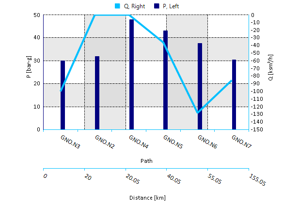

2.7. The function pathplot
pathplot('startnode','node(1)',…,'node(n)','endnode','property(1)',…,'property(n)','time')
Creates a chart with the change in property values along the path (nodes). By default, the shortest path from start to end node is drawn. Intermediate nodes can also be defined. The default time of the pathplot is the display time of the map window.
Example:
pathplot('GNO.N3','GNO.N7','Q;[ksm3/h];deepskyblue;Solid;4;[0,-150,15];Right','P;[bar-g];navy;column;10;[50;0;5];Left','03/02/20 00:00')-
Creates a pathplot from gas node N3 to node N7 showing the change in pressure and flow based on a set of plot specifications and the specified time.
