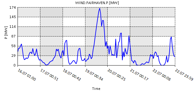

plot('WIND.FAIRHAVEN.P.[MW]')-
The plot function uses an expression to chart the power generated by the wind generator FAIRHAVEN within the time properties defined

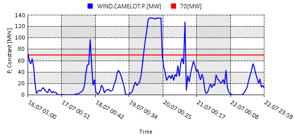

nplot('WIND.CAMELOT.P.[MW];[140;0;7];Blue','70[MW];Red')-
Plots the power generated by the wind generator CAMELOT and a control value of 70 MW.

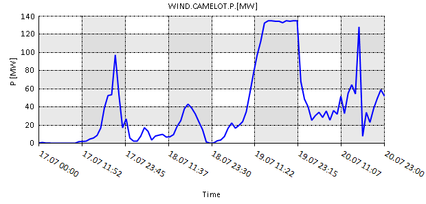

plot('WIND.CAMELOT.P.[MW];[140;0;7];Blue','17/07/2023 00:00','20/07/2023 23:00')-
Plots the power generated by the wind generator CAMELOT for the defined time window (17-July-2023 00:00 until 20-July-2023 23:00).
