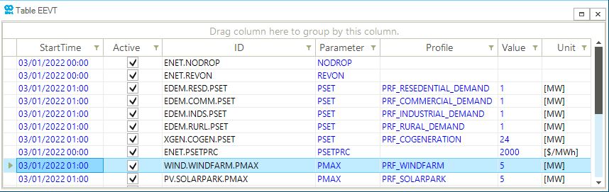

The list of all scenario events can be visualized from the event table, accessible using the EEVT, GEVT or TEVT under the scenario tab. An example of an instance of the "collection editor" and of an "event table" is shown in Figure 1 and Figure 2.

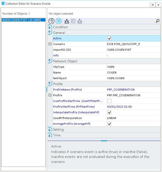

There are four scenario events categories common to all types of networks: set point, constant-updating, state, and constraint events. For electric networks, SAInt has a fifth category of events the average event. All scenario events are characterized by a common set of properties described in Table 4.
| Property | Description |
Start time of the scenario event. For steady state scenarios, the value is set to the start time of the scenario. For dynamic scenarios, the value can be expressed either by a specific time (e.g., dd/MM/yyy hh:mm) or by indicating the number of hours and minutes to add to the starting time (e.g., +hh:mm). |
Scenario event parameter (e.g., |
The scenario event value can be either a numeric value or an arithmetic expression. If a profile is assigned to the event, the value is used to scale the profile value at a specific time (e.g., 5, -3.2, |
The unit of measure to be used for the value of the event. This unit can be different from the default units of measure for the project. A drop-down menu allows selecting a different unit within the same unit type. |
Indicates if a scenario event is active (i.e., true) or inactive (i.e., false). Inactive events are not evaluated during the execution of the scenario. |
Name of the profile assigned to the scenario event |
Indicates if the profile start time defined for the event should be used instead of the global profile start time defined for the scenario |
Start time of the first data point of the assigned profile. The default is to have the same global start time for all events in the active scenario. It could be modified on an event base by the user. |
The user can specify if an event value is modified by a profile only at the exact moment specified by the profile or for any time point where the profile is not defined. In this case, the profile is interpolated. It is a Boolean value with a default set to true. |
Indicates if profile values should be averaged over a scenario time step. The default is set to false. The option is considered only if |
Defines which profile interpolation type is used for interpolating the data points included in the profile. If no profile is assigned to the event, the value is "NOPRF". Other accepted values are: "POINT" for no interpolation between two data points, "STEP" for step interpolation, "LINEAR" for linear interpolation, and "CUBIC" for cubic splines interpolation. The interpolation allows to have a different time granularity between profiles and simulation. |
Logical expression returning a true or false value. A script editor can be accessed to evaluate the expression. |
Evaluation type for the logical expression defined for the condition property. Default value is "NONE". Accepted values are: DoIFTrue, DoIFFalse, DoUtilTrue, and DOUntilFalse. The expression is evaluated if it is true or false, or until the condition is true or false. |
Name of the object to which the event is associated |
Unique identification code for the object to which the event is associated |
Optional information defined by the user for the event |
Code of the type of object to which the event is associated |

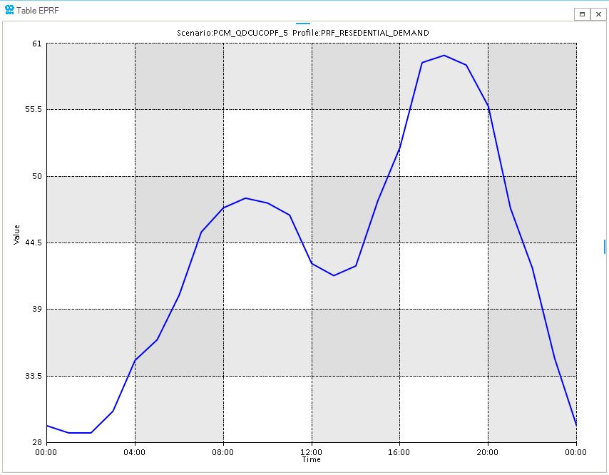

3. Scenario profiles

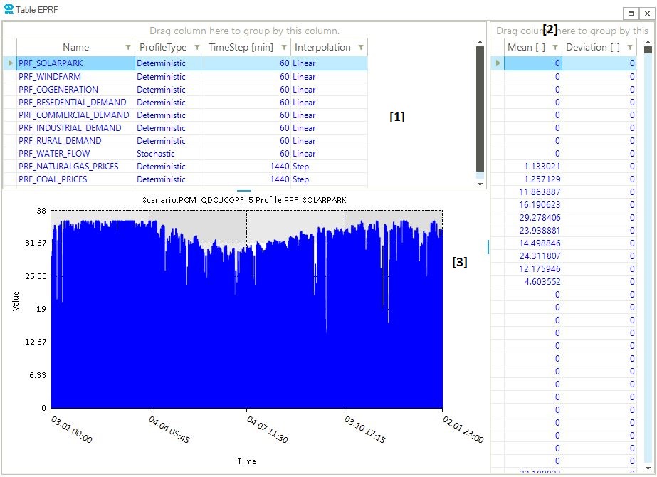

A profile is a collection of temporally equidistant data points. Profiles are assigned to object properties through events. The processing of profile data points is based on the specified profile settings. A profile can be applied to multiple events. In Figure 12, the profile "PRF_AT_DEMAND" is applied to the active power set point (PSET) of an electric demand (EDEM) and to the minimum value (MinVal) required by an ancillary service (ASVC).
The list of all profiles associated with the scenario can be visualized by the "profile table", accessible using the EPRF or GPRF under the scenario tab. As shown in Figure 13, the "profile table" is separated into three sections:
[1] "profile description table" displays the list of all the profiles and their properties.
[2] "profile data table" provides the selected profile’s mean and deviation data points list. Deviation data is only used for stochastic profiles.
[3] "profile chart window" visualizes the selected profile’s data points against the scenario time window.
Table 5 provides an overview of all relevant properties of profiles.

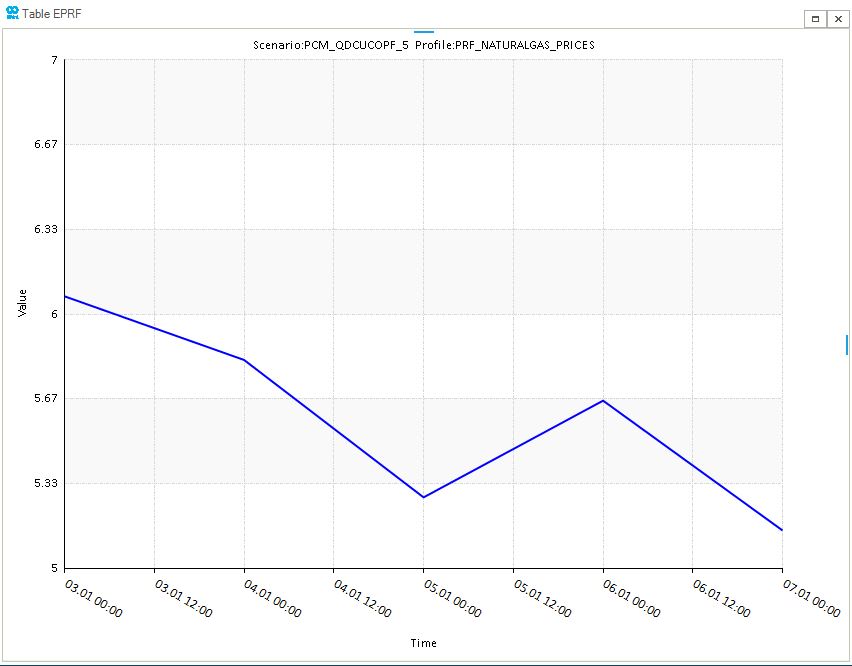

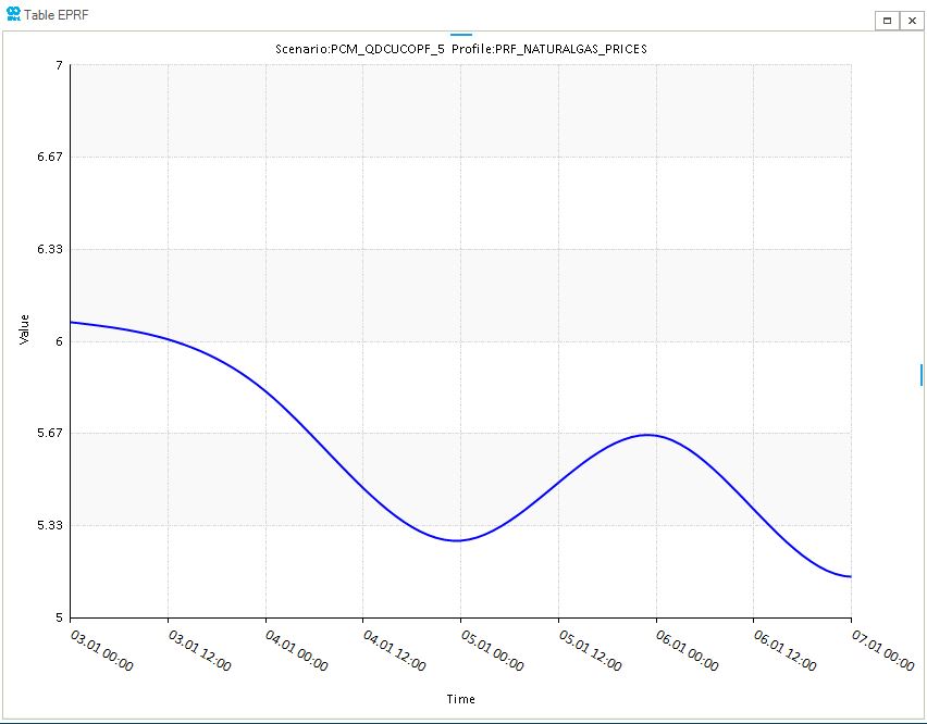

3.3. Profile interpolation
The time granularity of a profile and of a scenario may differ. When a profile has a coarser granularity, the user can specify if and how to interpolate for any time step not present in the profile. All interpolation options generate profile values between two data points. Available options are:
- Linear interpolation
It applies linear interpolation between data points. In Figure 16, daily fuel prices of natural gas are linearly interpolated to hourly scenario time steps.
- Cubic interpolation
It applies cubic interpolation between data points. In Figure 17, daily fuel prices of natural gas are interpolated using a cubic model to hourly scenario time steps.

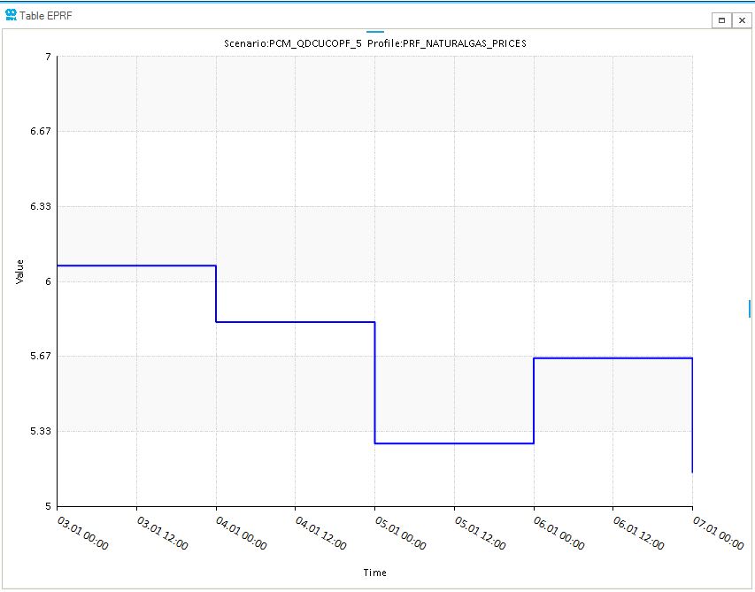

- Step interpolation
It applies step interpolation between data points. In Figure 18, daily fuel prices of natural gas are interpolated using a step model to hourly scenario time steps.

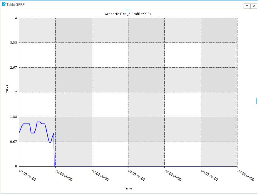

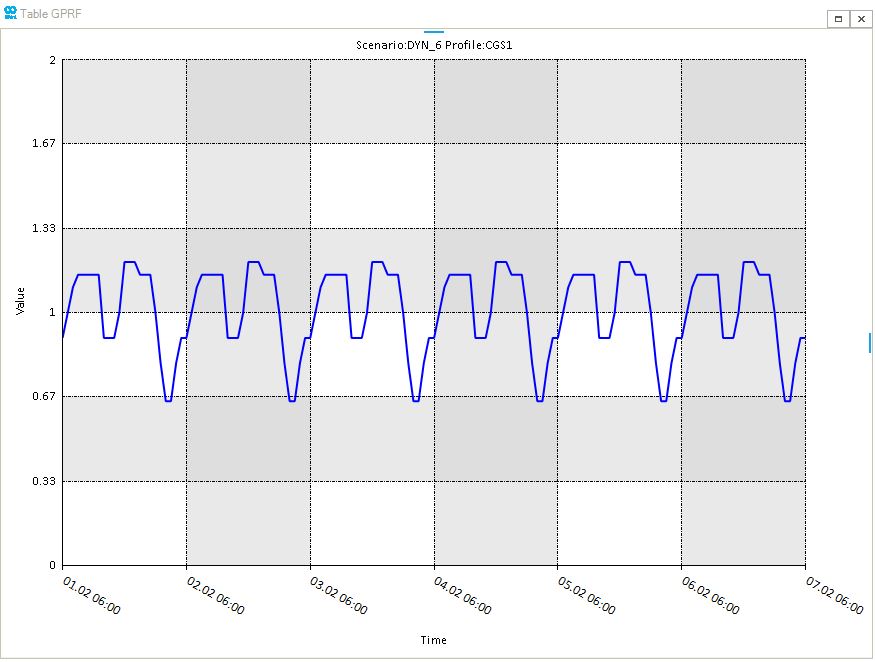

3.4. Profile duration
The length of a profile is defined by the number of data points multiplied by the time step. When a scenario has a length greater than the one of a profile, it is necessary to extend a profile so as to cover the entire simulation or optimization problem. Available options for the Duration property are:
- Periodic
It repeats periodically the profile. In Figure 19, the profile is only defined for 24 hours. After the defined values, the profile is periodically repeated based on the length of the profile or fractions (i.e., 24 data points).

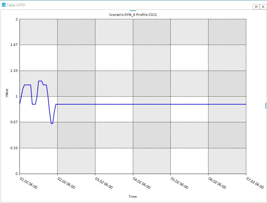

- Constant
It creates a constant profile equal to the last data point value. In Figure 20, the profile is only defined for 24 hours. After the defined values, the profile is extended with a constant value.
