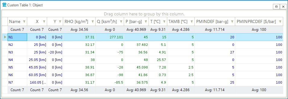

table('GNO.%')-
Creates a table with gas node properties as columns and gas nodes as rows. In the following picture, some of the columns automatically displayed have been hidden.

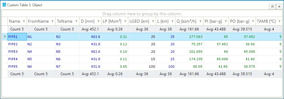

table('GNO.%','GPI.%')-
Creates separate tables for all gas nodes and pipelines with their respective properties. The node table is the same as in the previous example. The pipeline table is displayed in the following picture. The node table is the same as in the previous example.

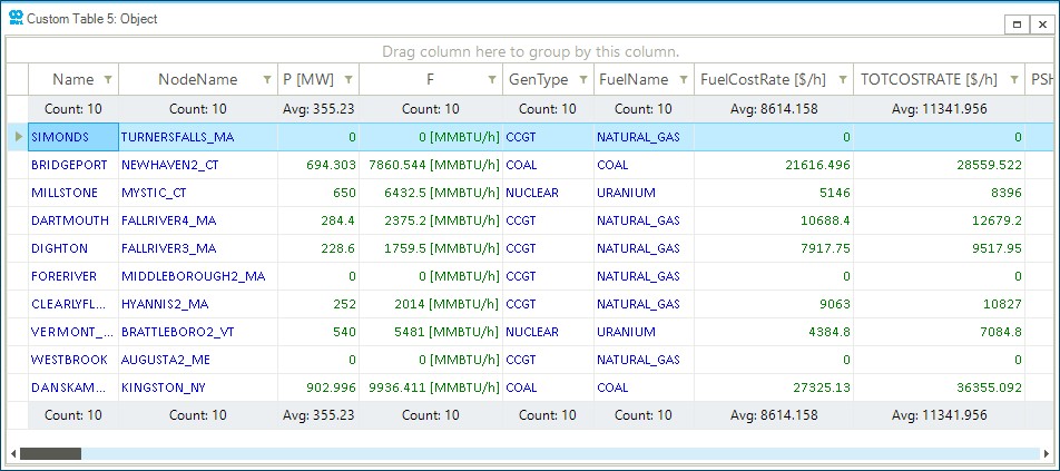

table('EZN.IEEE39.!FGEN.%')-
Creates a table with all fuel generators and their properties in the electric zone IEEE39.

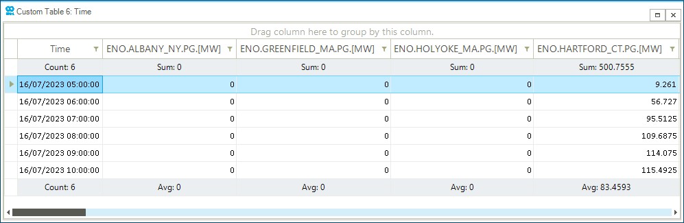

table('ENO.%.PG','+5','+10')-
Creates a time-series table with columns equal to the number of electric nodes. Each column contains rows with values of the active power generated at the specific node from 5th to 10th hour of the simulation.

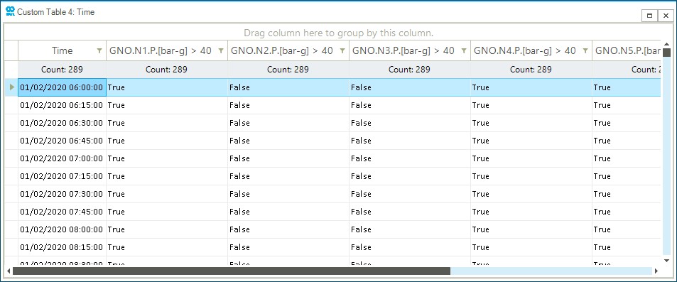

table('GNO.%.P.[bar-g] > 40')-
Creates a Boolean table with columns equal to the number of gas nodes. Each column contains rows with True/False values indicating if the pressure at a specific gas node is greater than 40 bar-g. The number of rows is equal to the time steps within the
ChartStartTime, andChartEndTime.

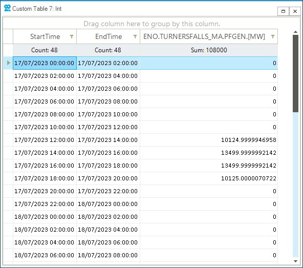

inttable('ENO.TURNERSFALLS_MA.PFGEN.[MW]','120[min]','17/07/2023 00:00','20/07/2023 23:00')-
Creates a table with the integral of the power generated by all fuel generators connected to the electric node TURNERSFALLS_MA using the integral time step, start time, and end time specified in the input expression.

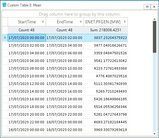

meantable('ENET.PFGEN.[MW]','2[h]','17/07/2023 00:00','20/07/2023 23:00')-
Creates a table with the mean power generated by all fuel generators using the mean time step, start time, and end time specified in the input expression.

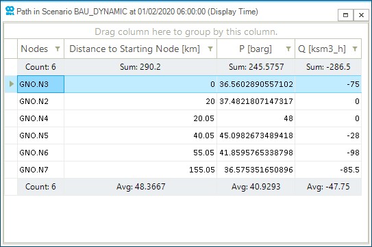

pathtable('GNO.N3','GNO.N7','P;[bar-g]','Q;[ksm3/h]')-
Creates a pathtable from gas nodes GNO.N3 to GNO.N7 showing the change in pressure and flow values along the path at the nodes, at the display time of the map window.
