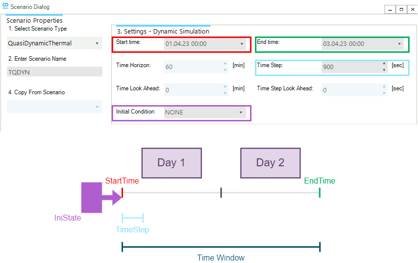

Figure 2 shows an example of the time settings and the associated graphical description of a quasi-dynamic thermal scenario as available in the Scenario Dialog window. The settings are for a scenario named "TQDYN" covering a 48-hour time window and using a time step of 15 minutes from April 4 at 00:00 to April 3 at 00:00. No initialization state is specified.
Any (quasi-)dynamic scenario can not last longer than 68 years. SAInt will inform the user of this violation and prevent the scenario from being created. |
