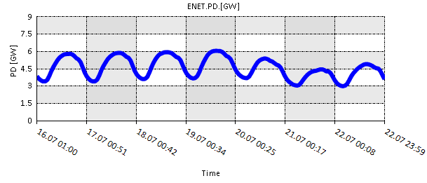

plot('ENET.PD.[GW];6')
Plots the active power demand, in gigawatt, of the electric network as a line with a line width of 6.
plots 01

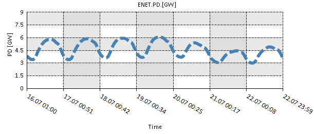

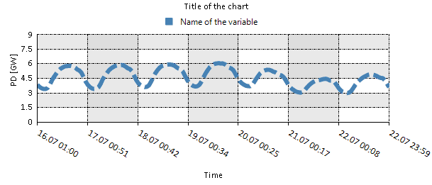

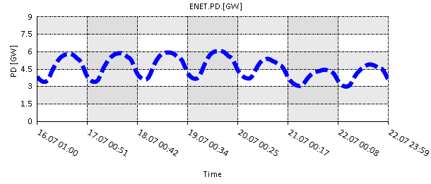

plot('ENET.PD.[GW];6;dash')
Plots the active power demand, in gigawatt, of the electric network as a line with a line width of 6 and a dash style.
plots 03

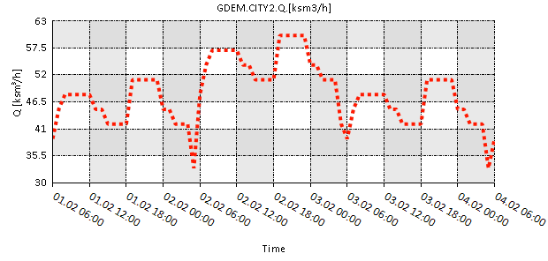

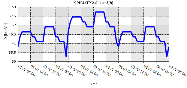

plot('GDEM.CITY2.Q.[ksm3/h];4;dot')
Plots the satisfied demand, in ksm3/h, of the external CITY2 as lines with a line width of 4 and a dotted style.
plots 04

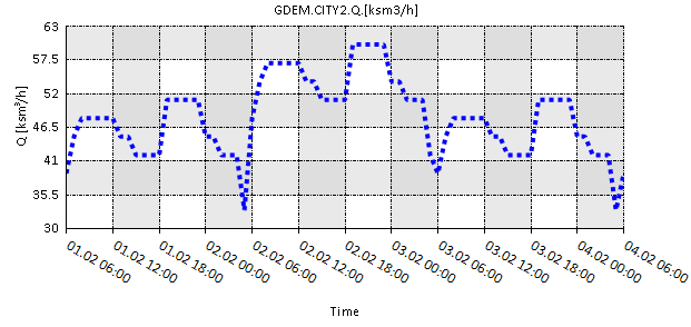

plot('GDEM.CITY2.Q.[ksm3/h];4;dot;R255G25B0')
Plots the satisfied demand, in ksm3/h, of the external CITY2 as lines with: line width of 4, dotted style, and defining the color using RGB values.
plots 06

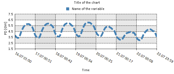

plot('ENET.PD.[GW];6;dash;SteelBlue;title=Title of the chart;legend=Name of the variable')
Plots the active power demand, in gigawatts, of the electric network with the chart as a line with: line width of 6, dash style, and in steel blue color. A title and a legend are added to the chart.
plots 07

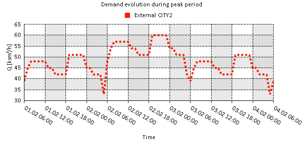

plot('GDEM.CITY2.Q.[ksm3/h];4;dot;R255G25B0;title=Demand evolution during peak period;legend=External CITY2')
Plots the satisfied demand, in ksm3/h, of the external CITY2 as lines with: line width of 4, dotted style, and color as RGB values. A title and a legend are added to the chart.
plots 08

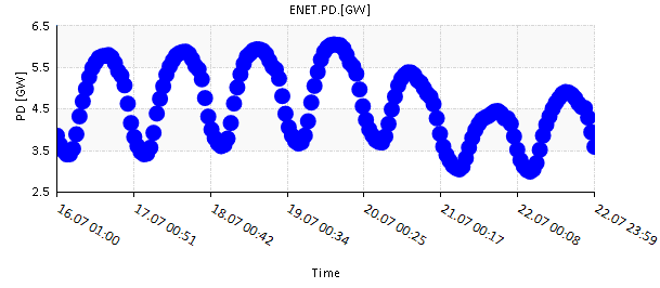

plot('ENET.PD.[GW];scatter;[6.5;2.5;4]')
Plots the scattered points of the active power served by the electric network against the time steps. The y-axis is defined between 6.5 GW and 2.5 GW, and 4 intervals of 1 GW.
plots 13

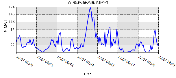

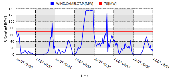

plot('WIND.FAIRHAVEN.P.[MW]')
Plots the power generated by the wind generator WINDFARM within the ChartStartTime and ChartEndTime.
plots 15

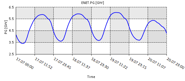

plot('ENET.PG.[GW];[6.5;2.5;4];2','17/07/2023 00:00','20/07/2023 23:00')
Plots the active power generated by the electric network within the specified start and end time.
plots 16

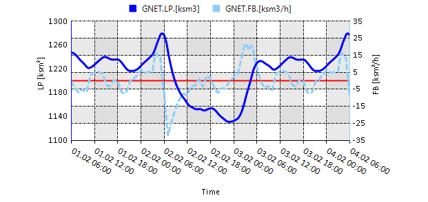

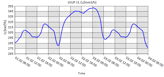

plot('GSUP.S1.Q.[ksm3/h];[355,265,9]')
Plots the flow from the gas supply S1 within the ChartStartTime and ChartEndTime. The expression also specifies the y-axis limits and intervals. Refer to Section 1.5 for defining limits and intervals.
plots 18

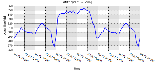

plot('GNET.QOUT.[ksm3/h];[360,260,10]')
Plots the total outflow of the gas network within the default ChartStartTime and ChartEndTime.
plots 19

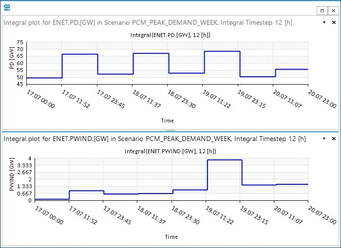

intplot('ENET.PD.[GW];[75;45;6]','12[h]','17/07/2023 00:00','20/07/2023 23:00')
Plots the integral of the electric network demand using the integral time step, start time and end time specified in the input expression. The integral time step defines a horizon of 12 hours.
plots 23

nplot('WIND.CAMELOT.P.[MW];[140;0;7];Blue','70[MW];Red')
Plots the power generated by the wind generator CAMELOT and a constant line at 45 [MW].
plots 26

nplot('GNET.LP.[ksm3];axis=left;3;Blue;[1300;1100;5]','GNET.FB.[ksm3/h];axis=right;3;Lightskyblue;dash;[35;-35;7]')
Plots the line pack and flow balance of the gas network based on a set of plot specifications.
plots 28
