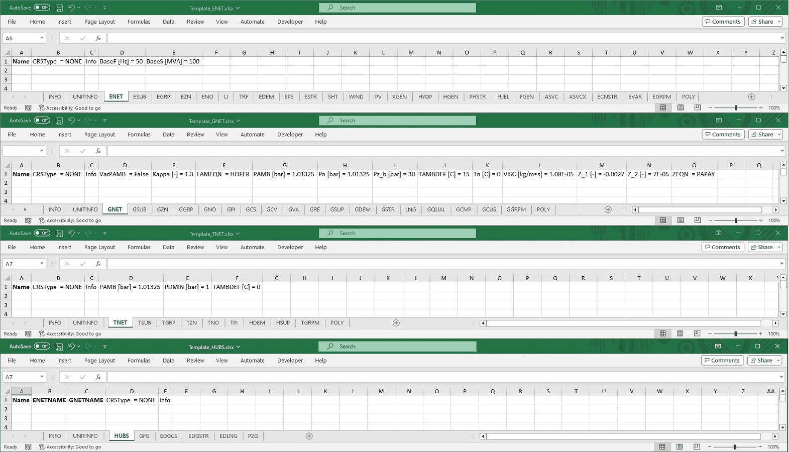

Figure 1. Excel network template files for an electric network (top), a gas network (middle-top), a thermal network (middle-bottom), and a hub system (bottom). All are open on the sheet for the network object (i.e., *.ENET, *.GNET, *.HUBS, and *.TNET). The picture shows the full list of objects that the template can handle. The sheet INFO and UNITINFO report the list of extensions, with displayed names and descriptions, and the list of units of measure, with description and aliases, used in all other sheets. Not all available sheets are reported in the examples of the image.
The file Template_ENET.xlsx allows the creation of a network import file of an electric network. The file Template_GNET.xlsx allows allows the creation of a network import file of a gas network. The file Template_TNET.xlsx allows allows the creation of a network import file of a thermal network. The file Template_HUBS.xlsx allows allows the creation of a network import file representing an HUB system. An HUB system combines different types of networks, and it defines which objects are coupled (i.e., using HUB objects) between the network types. A HUB system requires to create — at least — two separate networks (e.g., an *.ENET and a *.GNET), and after specifying the HUB objects.
For a detailed description of the network’s objects and their properties, please check the section "Electric Objects", the section "Gas Objects", the section "Thermal Objects", and the section "Hub Objects".
Even if an *.ENET file is applicable for different scenario types, objects and properties are different per scenario type. For example, a transformer object (TRF) is treated as an electric line (LI) in a DCUCOPF scenario, while it is treated as a transformer in an ACPF scenario. Reactive power is not considered in a DCUCOPF scenario, but it is for an ACPF scenario.

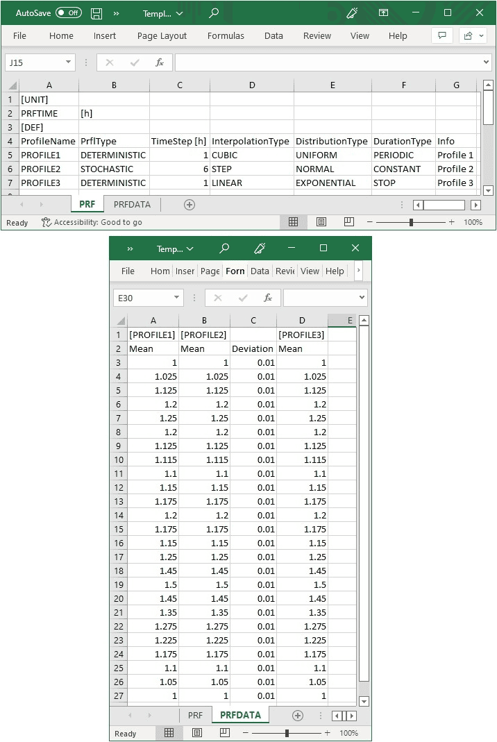

Profiles can be imported into SAInt by single-sheet format files either in Excel or in text format. The Excel file Template_Profile_Import.xlsx is, probably, the easiest options, because it constraints the user to follow a clear predefined layout, and quickly organize the data in a spreadsheet. Figure 1 describes how the data for three different types of profiles must be organized in two sheets named PRF and PRFDATA.
The example shows three hourly profiles (see the PRFTIME parameter set to [h]), called PROFILE1, PROFILE2, and PROFILE3 (see the ProfileName property). All general properties of a profile are reported in PRF. PROFILE1 is a deterministic profile, with a timestep of one hour, a cubic interpolation between steps, and its duration is set to periodic. The Info property can hold any additional piece of information deemed useful by the user. For this profile, the property DistributionType is not relevant and set to UNIFORM to showcase the three most common distribution types in SAInt (i.e., uniform, normal, and exponential distribution). The actual values of a profile are reported in PRFDATA. There profiles are organized in columns, starting with the name in square brackets in the first cell, followed by the label Mean or Deviation, and the numeric values of the profile steps. The label Mean is used for all types of profiles, while Deviation must be specified only for stochastic profile types.
profiles 00
Figure 2. Example of an Excel file template for a profile. Three different hourly profiles are reported showcasing all aspects of stochastic and deterministic profiles.

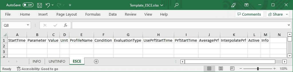

The Excel file Template_ESCE.xlsx is designed to create an electric scenario. Figure 3 shows an empty template. The same ESCE is used for all the electric scenario types (SteadyState, QuasiDynamic, and Dynamic). The information needed is:
Details
StartTime
It indicates the start time of the event expressed using either the format +H:mm or the format dd/MM/yyyy hh:mm (or the one selected in the general settings).
For the format H:mm`, `H` is a positive real number indicating the time to add to the start time of the scenario in hours and `mm` indicates the minutes to add. `H` is strictly a positive integer, and `mm` is an integer in the range from zero to 60. The ` is mandatory. For example, by indicating +2:25 the event will take place after 2 hours and 25 minutes from the starting time of the scenario.
For the format dd/MM/yyyy hh:mm (or the date format specified by the user in the general settings), SAInt accepts a positive integer between 1 and 31 for the day dd, a positive integer between 1 and 12 for the month MM, a positive integer bigger than 1970 for the year yyyy, a positive integer between 0 and 24 for the hours hh, and a positive integer between 0 and 60 for the minutes mm. The separator could either be a "/", or a "-" or a ".".
To be properly interpreted, the date and time format must comply with the rule dd/MM/yyyy hh:mm, expressed as a string of characters in an Excel file.
Finally, it is also possible to use two keywords, start and end, to indicate explicitly the start time and end time of the scenario as defined when the scenario was created.
Parameter
It is the parameter name expressed in the form "object type.object name.property" (e.g., GDEM.CGS_01.QSET for a gas external).
Value
It is a numeric value to be used. This has to be empty for certain events.
Unit
It is the unit of measure in square brackets. This has to be empty for certain events. Accepted values are limited to the ones reported in the sheet UNITINFO of the template or of the Lexicon (see file Lexicon.xlsx under the Documentation folder in the SAInt directory).
ProfileName
The name of the profile to be used for the event. When no profile is used, leave the field empty. If the profile is not available in the scenario, the event is dropped.
Condition
The condition for the event. When no condition is used, leave the field empty. If a condition has a wrong syntax the event is dropped.
EvaluationType
The evaluation criterion, if a condition is present. If the criterion has a wrong syntax, the event is dropped.
UsePrfStartTime
A Boolean value to indicate if the profile time defined for the event should be used instead of the global profile start time defined for the scenario.
PrfStartTime
Define the start time and date of the profile. If the user does not specify in the column’s header the desired "date and time format", SAInt assume the default dd/MM/yyyy HH:mm. Otherwise, it is possible to indicate the format by picking from one of the supported as described in the section "Miscellaneous" of the general settings for the property DateTimeFormat. For example, by indicating in the header of the column the format like in the example "PrfStartTime [MM/dd/yyyy HH:mm]", SAint expects date values matching the format MM/dd/yyyy HH:mm.
AveragePrf
A Boolean value to specify if profile values should be averaged over the scenario time step.
InterpolatePrf
A Boolean value to indicate if interpolation should be performed between two steps of a profile.
Active
Boolean value to describe the state of the event.
Info
A text field to add extra user information.
