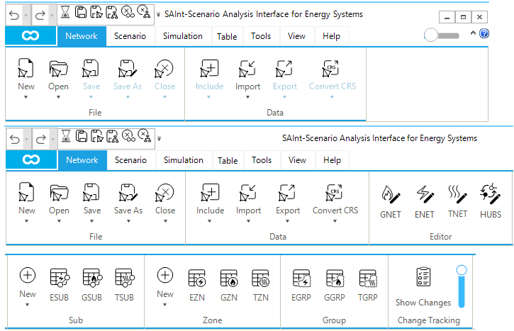

Ribbon Bar
The ribbon bar is the main starting point to carry out many actions and tasks in SAInt. The ribbon bar is organized around three components: the "quick access" bar at the left of the title bar of the GUI, the "application menu" which can be opened from the button located in the left corner below the title bar of the GUI, and the "ribbon tabs" stretching along the main section of the window (Figure 1). From the different parts of the ribbon bar, the user can quickly execute simulations and save results and scenarios, customize all settings, or access all main panels and menu items.
ribbon bar 000

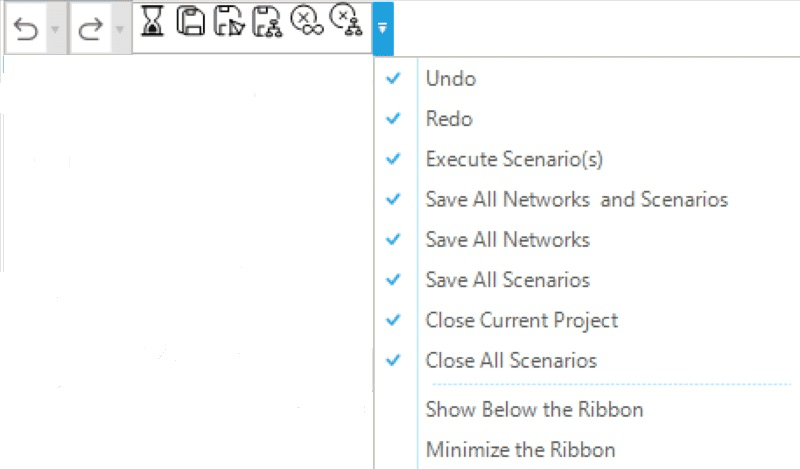

Figure 1. Ribbon bar and its three components with an active empty project: the quick access bar (red frame), the application menu button (green frame), and the ribbon tabs part (gray frame).
1. Quick access bar
The quick access bar is shown in Figure 2. It contains the buttons of frequently used GUI functions. By default, the quick access bar is located in the top left corner of the GUI. It can be customized by selecting and deselecting the different functions from the context menu. Table 1 describes the quick access bar functions.
ribbon bar 00
Figure 2. The quick access bar with the customization context menu open.

Customization
Shows the list of available options. Checked options are displayed in the quick access bar. The position of the quick bar can be customized by selecting above or below the ribbon bar.
Multiple changes can be modified at once from Undo and Redo, by selecting a sequence of consecutive changes with the mouse from the drop-down list. The changes are highlighted in light orange.

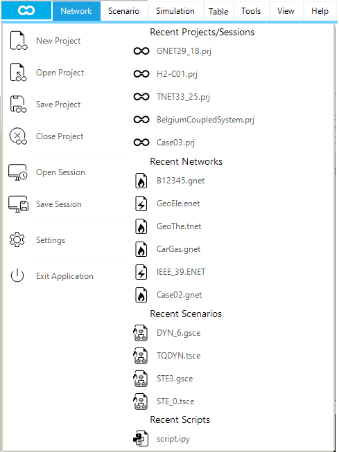

2. Application menu
The application menu is accessible from the button at the top-left corner of the GUI. It is divided into two columns, as shown in Figure 3. The first column contains all the project and session-related options, including access to the GUI settings and file version converter. The second column allows the user to access the recent projects, sessions, networks, scenarios, and IronPython scripts.
application menu 00
Figure 3. Example of the Application menu.
A project file represents a hierarchical collection of models, profile files, sessions, IronPython scripts, and polygons. Profiles, IronPython scripts, and polygons allow to manage specific aspects at the project level. A model is a child object of a project, and it is a collection of a network, scenarios, state files, solution files, profiles, project file, map file, log files, and model-related IronPython scripts. In releases prior to 3.4, SAInt had also vertex files and labels files. These objects have been moved to the map file and the project file. At this level, profiles and scripts allow to manage model-related aspects, compared to project-related aspects. Finally, a session represents a snapshot of a project containing the state of the tabs available in the map window area of the dock panel and the state of the loaded scenarios. A session preserves the opened windows (e.g., chart windows, map view windows, etc.), tables, and scripts active at the time of saving the session. A specific session can be saved and reopened at a later stage. The position and arrangement of the command line window, the log window, the model explorer, and the property editor are not saved in a session.
The application menu options of the first column are described in Table 2.
Table 2. Icons, options, and descriptions of the application menu.
Icon Options Description
application menu 01
New Project
Create a new project and close the currently opened project.
application menu 02
Open Project
Open a previously saved project. A project file has the extension *.prj.
application menu 03
Save Project
Save the currently opened project to a project file ( *.prj).
application menu 05
Close Project
Close the opened project and the associated networks and scenarios.
application menu 06
Open Session
Open a previously saved session file. A session file has the file extension *.ses.
application menu 07
Save Session
Save the current session to a session file (*.ses).
application menu 09
Settings
Open the general settings to be used in the active project. The settings window allows one to select and set up meteorological data provider, legends colors, default charts, units, fonts, and miscellaneous aspects for the GUI and the solver.
application menu 10
Exit Application
Option to exit SAInt. If unsaved changes are pending, the user is asked to save the opened model before closing.
Use a session to save a specific time step of interest.

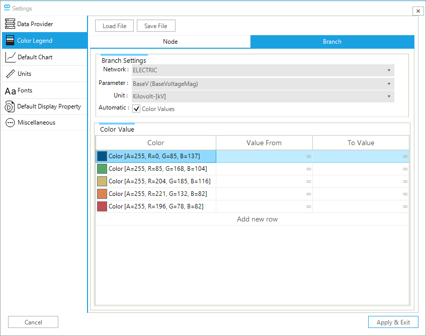

2.1.2. Color legend
The Color legend tab allows the user to edit and customize the legends used to display branches and nodes properties in the map window.
In the case of branches, Figure 5 shows how the legend can be customized per network, parameter, and unit of measure. The options Color, Value From, and To Value allow to obtain a categorized legend, where each class is defined in terms of the range of the values of the parameter, and color. The number of classes can be changed using the option "Add new row". In the example of the figure, the base voltage magnitude, in kilovolts at the branch level, is categorized into 5 classes. Ranges for each class are automatically define as the option Automatic is checked (by default). The blue class starts at minimum value. The red class ends at the maximum value. The remaining breaks are defined by calculating four equally spaced intervals.
The user can customize the following options of the branch legend settings:
Network
Option to specify which type of network to customize (i.e., available values are gas, electric, and hubs, while liquid and heat networks will be available in future releases).
Parameter
Option to select a specific parameter from a drop-down menu based on the selected network type.
Unit
Option to select the unit of measure from the drop-down menu for the specified parameter.
Automatic
Option to let SAInt automatically assigns the color range to the parameter. Untick the option to enforce the user-specified categories.
Color Value
The user can customize color and class range. The Color column defines the RGB of the parameter that applies for the interval Value From — To Value. In addition, new ranges can be added using the Add new row. The color dialog window (Figure 7) is accessible via …​ located on the right side of the Color cell.
color legend 00
Figure 5. Example of a branch legend in the "Color Legend" tab of the settings.

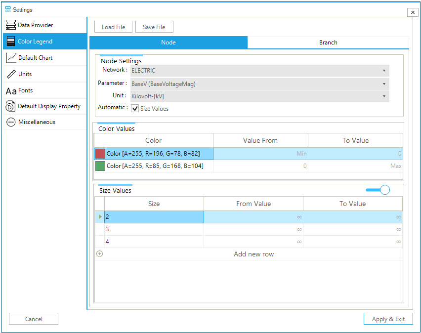

In the case of nodes, Figure 6 shows how the legend can be customized per network, parameter, and unit of measure. The fill color of the nodes can be personalized for results divided into the negative region (i.e., the minimum value and zero excluded), and the positive region (from zero excluded to the maximum). Values equal to zero are represented in a white. If both extreme are in the same region, only one color is visible. The size of the nodes is personalized using a user defined number of classes with their own ranges. The number of classes can be changed. In the example of the figure, only the color is active. No sizing of the nodes is selected as the sliding bar on the right of the "Size Values" entry is not active.
As in the case of the branch legend, the user can customize the following options of the node legend settings:
Network
Parameter
Unit
Automatic
Color Value
Size Values
The user can specify the number of classes for the different sizes and the range of valid values for each class with the interval Value From — To Value.
color legend 01
Figure 6. Example of a node legend in the "Color Legend" tab of the settings.

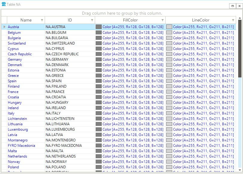

SAInt uses a reference colors palette which can be modified by the user at any time. Reference colors are (in RGB format) black (r0g0b0), white (r255g255b255), and red (r255g0b0), plus a series of custom options: r0g157b209, r204g185b116, r140g140b140, r218g139b195, r147g120b96, r129g114b179,r196g78b82, r85g168b104, r221g132b82, and r0g85b137.

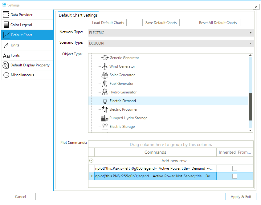

2.1.3. Default chart
The Default Chart tab allows the user to customize the "default charts" produced by SAInt for the different network objects. Figure 8 shows an example of electric externals in a DCUCOPF scenario of an electric network. Please, note that only a parent object can be customized in terms of properties, units, axis, color, and so on in the chart. A child object inherits the graphical properties from its parent object, and so its own chart’s properties cannot be modified. A customized default charts configuration file can be saved for future use or loaded from a previous project. After customization, the user can also reset all specified properties to the installation defaults. The plot commands section displays the function used to generate the default plot.
default chart 00
Figure 8. Example of the default chart for an electric external parent object.
The user can select the following options of the default chart settings:
Load default charts
Option to load a saved default chart file with *.dfc extension.
Save default charts
Option to save the customized default chart configuration to a file with *.dfc extension.
Reset all default charts
Option to reset all plots to the SAINt installation default configuration.
Network type
Option to specify which type of network to customize (i.e., available values are gas, electric, and thermal).
Scenario type
Option to filter the type of objects to customize based on the selected scenario type available from the drop-down menu.
Object type
The option lists, in a hierarchical tree form, the parent and child objects based on the network and scenario selected.
Plot commands
Option to edit the script for the default plot of the specified parent object.
Default charts are displayed when selecting Plot Window  Default Plot from the objects' context menu.

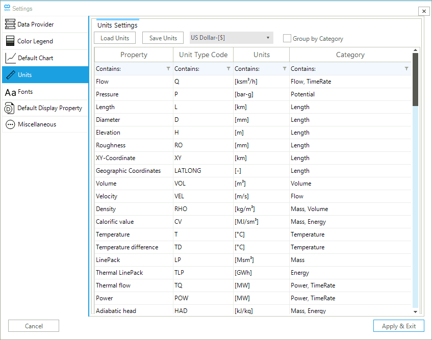

2.1.4. Units
The Units tab allows the user to specify the currency and the units of measure for all properties of parameters and quantities estimated in SAInt. As shown in the example of Figure 9, objects' properties are listed along with their SAInt code, and the unit of measure, which is accessible from a drop-down list ▼. Properties can be grouped to facilitate management operations. The settings can be saved to an external units file, or loaded from an external units file. SAInt centralizes the management of units of measure in the units tab, but it allows to use of alternative units in charts or simulation scenarios, and it takes care of a correct units conversion. For a step-by-step explanation of the use of the unit settings go to the How-To guide "Change Units of Measure and Currency".
Once the units of measure are set, they are valid for all projects, till the next change. Unit settings are a property of the software installation and not of a SAInt project or model. The user should pay attention when moving a project from one computer to another, because the local machine settings for the units may be different, and SAInt will automatically perform all necessary conversions.
units 00
Figure 9. Units settings tab in the general settings window of SAInt.

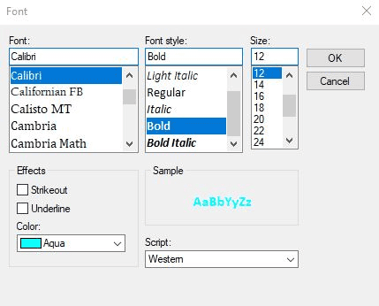

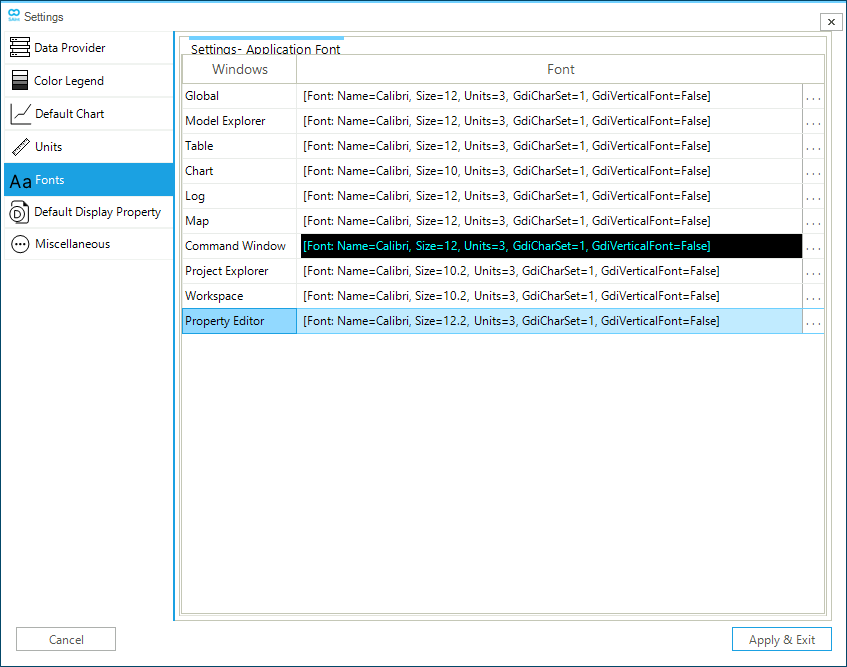

2.1.5. Fonts
The Fonts tab allows to personalize font properties for all parts of the GUI. As showed in Figure 10, the user can change fonts in the Command Window, the Map Window, the Log Window, the Project and Model Explorer, Workspace, tables, charts, and globally.
fonts 00
Figure 10. Fonts tab in the settings of SAInt.
The font dialog box is accessible via …​ on the right side of the font column. The dialog box allows customizing the font family, the font style, the font size, effects, color, and script. A preview is shown in the sample section. The font color is used only to modify the Command Window.
fonts 01
Figure 11. Example of the font dialog box for the case of the command window.

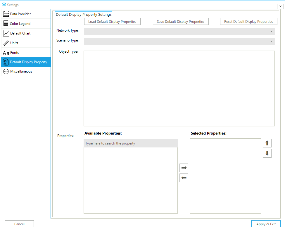

2.1.6. Default Display Property
The default display property tab allows selecting which properties should be displayed in the node bar (Figure 12) which facilitates navigation of your model and results by exploring nodes.
display property tab 00
Figure 12. Default display property dialog box.
The default display property tab is like the default chart tab as they share the same object selection method as well as load, save, or reset options. The user can modify the following options of the display property tab:
Load default display property
Option to load a saved default property file with a *.ddp extension.
Save default display property
Option to save the customized default display property configuration to a file with a *.ddp extension.
Reset default display property
Option to reset the list of the displayed properties to the SAInt installation default configuration.
Network type
Scenario type
Object type
Available property
The option lists all the available properties for the selected object. The list may change depending on whether an active scenario or a valid loaded solution is available.
Selected property
List of the user-selected properties to be displayed in the node bar. The entries are selected from the "Available Properties" lists. The list can be expanded or reduced by moving entries between the "Selected Properties" box and the "Available Properties" box using the two buttons with left- and right-pointing arrows.

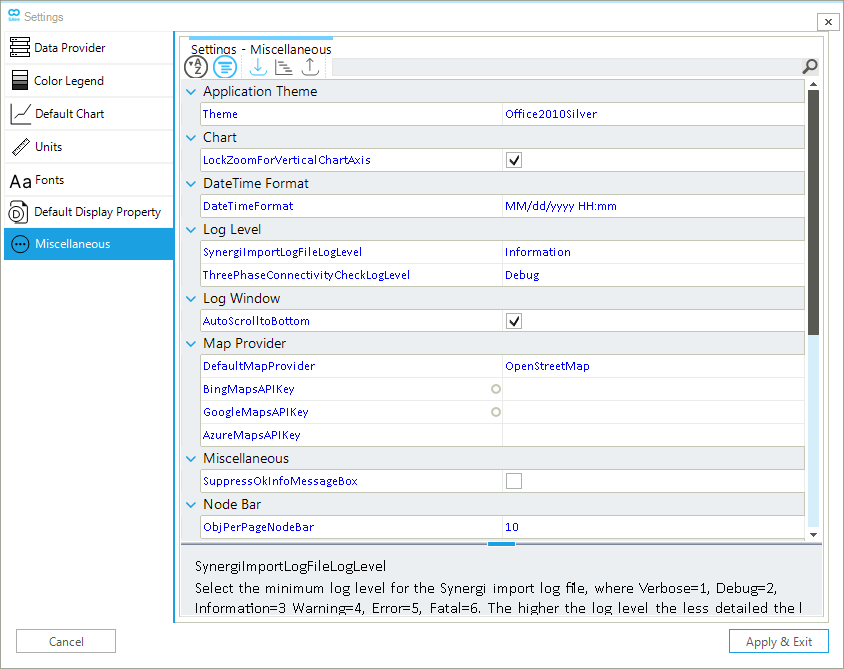

2.1.7. Miscellaneous
The miscellaneous tab allows editing the properties related to the node bar, imported polylines from a shapefile, solver iterations, solver residual tolerance, and other properties, as shown in Figure 13.
miscellaneous tab 00
Figure 13. Miscellaneous dialog box.
The user can modify the following options of the miscellaneous tab:
Theme
Change the look and feel of the GUI by applying different application themes.
LockZoomForVerticalChartAxis
Lock the zoom on the vertical axis in newly created charts.
DateTimeFormat
Option to select the format of date and time used by SAInt in tables, charts and for importing or exporting time-related data. By default, the first time SAInt is installed, it tries to use the operating system’s user-defined format for the region selected under "Settings>Time & Language  Region & language" in Microsoft Windows©. (i.e., SAInt combines the format for "Short date" and for "Short time" used in your machine). The user can change this format in SAInt-GUI and in SAInt-API, and select among one of the accepted variants. Valid options are: yyyy-MM-dd HH:mm, yyyy/MM/dd HH:mm, dd-MM-yyyy HH:mm, dd/MM/yyyy HH:mm, MM-dd-yyyy HH:mm, MM/dd/yyyy HH:mm, or the reserved word system which bring the short date and time of the system (in the API). The symbols indicate: MM is the month, dd is the day, yyyy is the year, HH is the hour, and mm are the minutes.
Note that the selected format is valid only for work sessions in SAInt-GUI and have no impact on the SAInt-API side, or the other way round, a change via the API does not affect the GUI.
SynergiImportLogFileLogLevel
Option to set the minimum log level for the Synergi import log file by using the ▼ button. Possible log levels, from the more to the less detailed, are verbose, debug, information, warning, error, and fatal. The default value is "Information".
ThreePhaseConnectivityCheckLogLevel
Option to set the minimum log level for the three-phase connectivity check log file by using the ▼ button. Possible log levels, from the more to the less detailed, are "debug", "information", and "warning". The default value is "Debug".
Warning: Only critical connectivity issues that may cause an error when running the simulation are logged.
Information: Additional information about the connectivity checking process and critical connectivity issues is logged.
Debug: Information about the connectivity checking process and details of critical and non-critical connectivity issues are logged.
AutoScrolltoBottom
Option to activate or deactivate the auto-scroll to the bottom of the log window when a new row is added.
DefaultMapProvider
Option to select the default map provider to use in the Map Window for the base map. A drop-down list provides the valid options. The user can specify a different provider for each map view using the Base Map Layer Settings" of the layer window, and must save a session to be able to restore the choice.
BingMapsAPIKey: Insert the user’s API key for the Bing Maps provider. Provided for legacy user of the "Bing Maps for Enterprise service", which will be retired by Microsoft by June 30th, 2028.
GoogleMapsAPIKey: Insert the user’s API key for the Google Maps provider.
AzureMapsAPIKey: Insert the user’s API key for the Azure Maps provider by Microsoft.
SuppressOkInfoMessageBox
Option to show or not informative boxes that require the user to only press Ok.
ObjPerPageNodeBar
Option to set the maximum number of objects on each page of the node bar in the map window.
MinPolyLineAngle
Option to set the minimum deflection angle between two neighboring vertices of a segment of a polyline geometry to identify vertices to remove for reducing and simplifying the complexity of a polyline. IF the angle between the first and second vertex is smaller than the threshold and the MinPolyLineLength is smaller, the vertex is removed.
MinPolyLineLength
Option to set the minimum allowed perpendicular distance (in liner units, generally meters) before removing a vertex using the "Ramer-Douglas-Peucker algorithm". The basic algorithm is extended by incorporating also an angular criterion (defined by the parameter MinPolyLineAngle) and and hard-coded static length-excess threshold for keeping vertices in shallow curves (i.e., a fixed value of 1000 meters for geographic data or 10 meters for Cartesian data).
MaxResidualIterationsSteadyStateFluid
Option to set the default maximum number of iteration steps used for new steady state scenarios for fluid networks.
MaxResidualIterationsDynamicFluid
Option to set the default maximum number of iteration steps used for new dynamic scenarios for fluid networks.
MaxResidualIterations(U)ACPF
Option to set the default maximum number of iteration steps used for new (unbalanced) AC-power flow scenarios.
MaxResidualIterationsACOPF
Option to set the default maximum number of iteration steps used for new AC-optimal power flow scenarios.
MaxControlIterations
Option to set the default maximum number of constraint and control handling iterations steps used for new steady state and (quasi-)dynamic scenarios
MaxResidualIterationsThermal
Option to set the default maximum number of iteration steps used for new thermal scenarios.
ResidualToleranceSteadyStateFluid
Option to set the default residual tolerance used for new steady state scenarios for fluid networks.
ResidualToleranceDynamicFluid
Option to set the default residual tolerance used for new dynamic scenarios for fluid networks.
ResidualToleranceACPF
Option to set the default residual tolerance used for new AC-power flow scenarios.
ResidualToleranceACOPF
Option to set the default residual tolerance used for new AC-optimal power flow scenarios.
ResidualToleranceThermal
Option to set the default residual tolerance used for new thermal scenarios.
SAInt’s default date and time format is dd/MM/yyyy HH:mm, with the time using the 24-hour convention. If the user does not specify the format in any of the import files, SAInt assumes this default format; otherwise, it will use the one indicated in the header row for the specific property.
In an Excel™ scenario import file, the property StartTime must be set as type "Text" and not "Date". SAInt accepts values specified as "+H:mm" or dd/MM/yyyy HH:mm (with the time using the 24-hour convention), but not as Excel’s "Date" format.

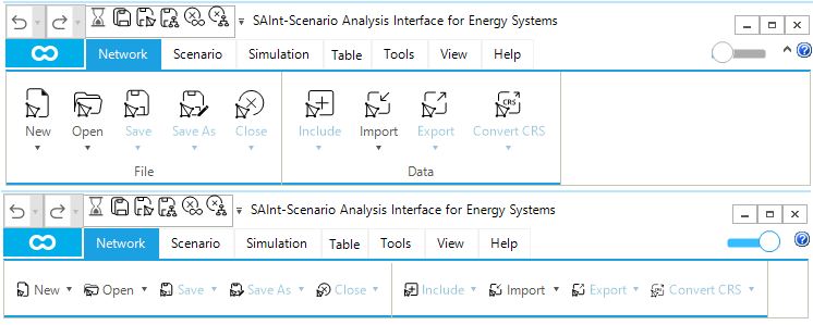

The Ribbon tabs part of the ribbon bar consists of six tabs (Figure 14 top): network, scenario, simulation, table, view, and help. Each tab is composed of several panels (e.g., for the Network tab we have the panel File and Data). Each panel contains different menu items or options (e.g., the Data panel of the Network tab has the following options: New, Open, Save, Save As, and Close). By using the button ▼ in each option, the user can open a drop-down containing different specific functions. The ribbon tab can be minimized by using the network tab 01 option.
network tab 02
Figure 14. Expanded (top) and minimized (bottom) version of the ribbon tabs for the Network tab for an empty project. Note the different value of the option network tab 01 for changing the ribbon tabs part from and to the expanded and minimized version. The ribbon tabs part has six tabs, with multiple panels and options.
3.1. Network tab
The Network tab of the ribbon bar allows the user to access an extended set of network-related functions. It is composed of up to six panels, depending on the number and type of networks loaded. (Figure 15) shows the case of a project where there is no loaded network (the top part with the two panels File and Data), and the case of a project where a hub, an electric, and a gas network are loaded (the bottom part with six panels: File, Data, Editor, Sub, Zone, and Group). A detailed description of the panels and the available options is provided in the following sections of the reference guide.
network tab 00
Figure 15. Network tab with a project where there is no active network (top), and a project with a hub, an electric, a gas, and a thermal network (bottom, two rows). The number and type of panels available is different based on the number and type of networks available.

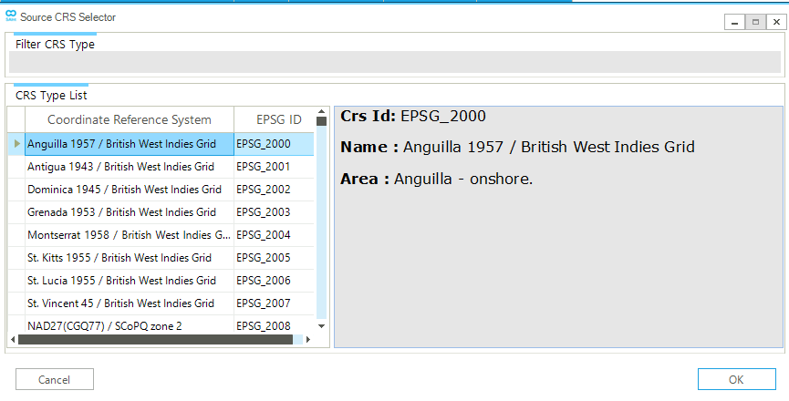

Figure 16. Coordinate reference system conversion window for the export network option of the "Data" panel of the "Network" tab of SAInt.
The "convert" option is designed so that the user can convert the coordinate reference system (CRS) of the active network in a Cartesian map view to SAInt’s default CRS. The conversion procedure opens the network on a new geographic map view and closes the Cartesian one.
By selecting Convert CRS the user can choose among the available active networks. Figure 17 shows the window where the user can choose the CRS of the active network (i.e., the CRS of the displayed network in the Cartesian map view). The coordinates will be transformed to the CRS EPSG:4326 (i.e., WGS84). The user can select the desired CRS from the available list or filter and select by entering a string or the EPSG code in the "Filter CRS Type" field.
network tab 04
Figure 17. Convert coordinate reference system option of the "Data" panel of the "Network" tab of SAInt.
Sections "Coordinate Reference Systems" and "Map view" provide more details on how SAInt handles coordinates and coordinate reference systems.

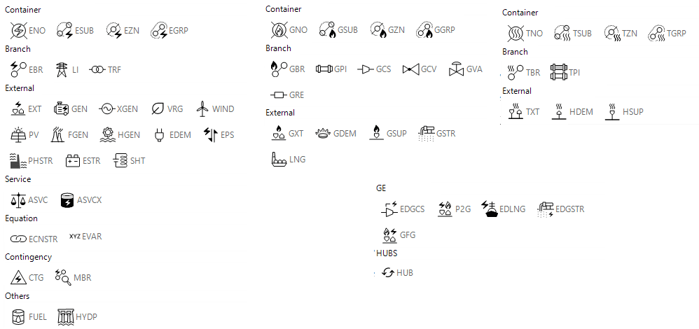

The "editor panel" of the Network tab gives access to the property editor for the networks available in a project in the GUI. The network property editor contains input and output properties such as the number of nodes, type of network, etc. The available items in the editor panel depend on the type of networks in the active project (e.g., the *.gnet editor is not visible if no gas network is loaded). Table 6 describes in detail the options available in the editor panel.
Table 6. Icons, options, and descriptions of the Editor panel of the Network tab.
network editor panel 01
ENET
Option to open an electric network editor.
network editor panel 02
GNET
Option to open a gas network editor.
network editor panel 04
TNET
Option to open a thermal network editor.
network editor panel 03
HUBS
Option to open a hub system editor.

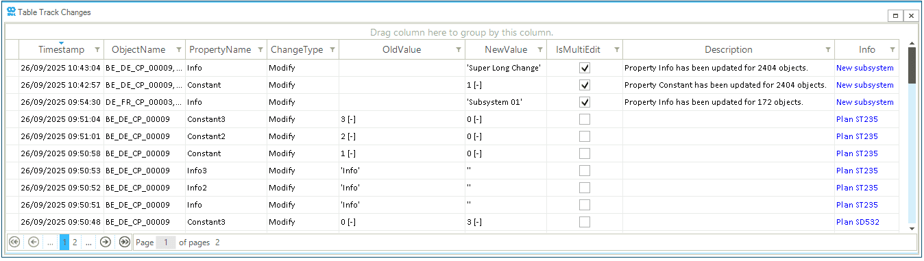

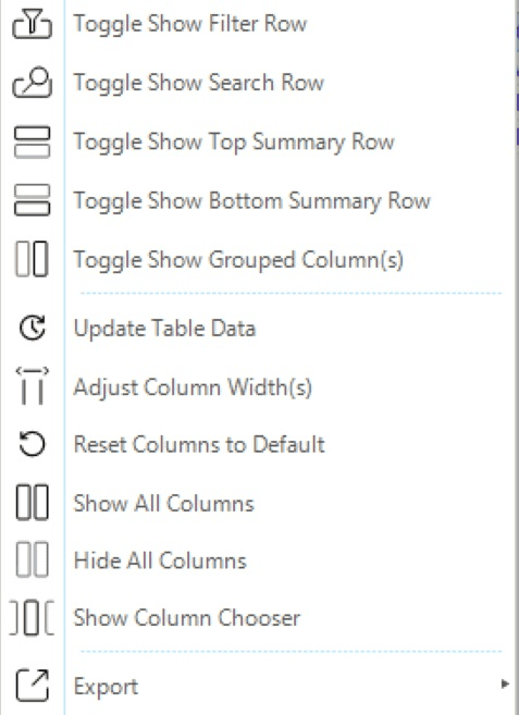

As with any other table in SAInt, the table of Track Changes can be filtered, searched, sorted, and exported outside SAInt. Check the context menu of the table for available options. The user can adjust which attributes to list in the table, modify the columns' width, and group rows based on column’s values. Cell or row content can be copied and pasted (using CTRL+C and CTRL+V) once selected (i.e., highlighted in blue). The table shows a maximum of 50 rows per page. The user can find the table navigation options at the bottom of the window. The options cover back and forth arrows, page selection and page number selection.
Multi-edit changes are recorded as an aggregated change. They are reported as a single row in the table of Track Changes, and are clearly identified by the property of the attribute "IsMultiEdit" and the presence of a value in the "Description" attribute. It is not possible to explore any change for a single object or a subset of the initial group of objects.
The table can be exported to an external file in Excel, CSV, PDF, or HTML format. When using the Excel format, a multi-edit change can record a string of text longer than Excel’s supported maximum length. This will not prevent the file from being created, but Excel will require the user to perform a "recovery" operation to open the file. The CSV or HTML formats are better options when complex multi-edit changes are present.
track changes 00
Figure 19. Example of the table of Track Changes showing all default attribute columns, three multi-edit changes, and the use of the " Info" field to add user-specified values to the recorded changes. The table has two pages, and only the first few records of page one are shown.

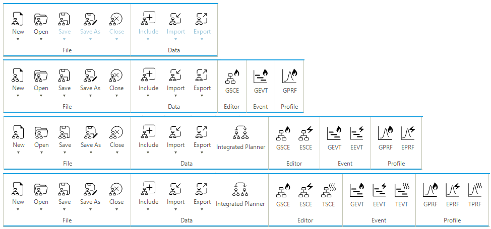

3.2. Scenario tab
The Scenario tab of the ribbon bar allows the user to access an extended set of scenario-related functions. It is composed of up to five panels, depending on if a scenario is active and on the type of scenario in the project. (Figure 20) shows the case of a project where there is no scenario active (the top part with the two panels File and Data), a case of a scenario for a dynamic gas model (second from top with the five panels File, Data, Editor, Event, and Profile), a case of a scenario for a dynamic gas and quasi-dynamic electric coupled models (third from top), and a case with (quasi-)dynamic gas, electric and thermal models. A detailed description of the panels and the available options is provided in the following sections of the reference guide.
scenario tab 00
Figure 20. Scenario tab for the case of no active scenario in the project (first from top), a scenario for a dynamic gas model (second from top), a scenario for a dynamic gas and quasi-dynamic electric model (third from top), and a scenario for (quasi-)dynamic gas, electric and thermal model (bottom). The number of panels and the type of items are different based on the type of scenarios.
3.2.1. File panel
The File panel of the Scenario tab, similarly to the File panel of the Network tab, allows the user to create, open, save, copy, and close any scenario file available in the active project. Table 11 describes in detail the options available in the File panel.
Table 11. Icons, options, and descriptions of the File panel of the Scenario tab.
scenario file panel 01

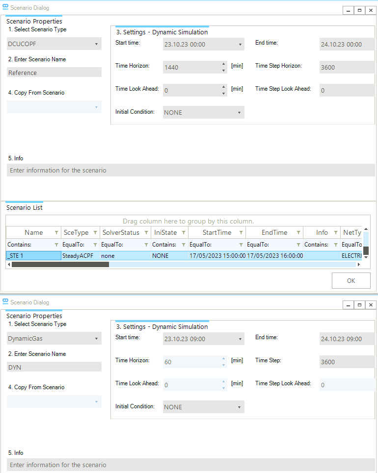

New
Option to create a new scenario for the active network using a dedicated Scenario Dialog window.

3.2.4. Editor panel
The Editor panel of the Scenario tab allows the user to access the property editor for the active scenario in the GUI. The user can use the property editor to modify all aspects of a steady state or dynamic scenario such as simulation start and end time, time step, initial state, solver type, look ahead, etc. The type of buttons shown on the panel depends on the type of active network. Table 13 describes in detail the options available in the scenario Editor panel.
Table 13. Icons, options, and descriptions of the scenario Editor panel of the Scenario tab.
scenario editor panel 02
GSCE
Option to open a gas scenario in the property editor.
scenario editor panel 01
ESCE
Option to open an electric scenario in the property editor.
scenario editor panel 03
TSCE
Option to open a thermal scenario in the property editor.
3.2.5. Event panel
The Event panel of the Scenario tab allows the suer to access the scenario events table in the GUI. The user can use the table to manage all events of the active scenario. Table 14 describes in detail the options available in the scenario Event panel.
See the How-To guide Create a scenario event in SAInt-GUI for a step-by-step description on managing events.
Table 14. Icons, options, and descriptions of the Event panel of the Scenario tab.
scenario event panel 02
GEVT
Option to open a table with a list of events for the active gas scenario.
scenario event panel 01
EEVT
Option to open a table with a list of events for the active electric scenario.
scenario event panel 03
TEVT
Option to open a table with a list of events for the active thermal scenario.

The options of the global context menu options are shown in Figure 27.
toggle table 00
Figure 27. Global context menu for a table.
The global context menu allows to:
Toggle show filter row
Option to add or remove a header row to apply filters to select rows based of different criteria like Equal or Contains.
Toggle show top summary row
Option to add a summary row at the top of the table. The summary includes the count for string type entries, while the average for float type entries. For float type entries other mathematical operators (like sum, max, etc.) can be chosen by right-clicking on default summary option.
Toggle show bottom summary row
Option to add a summary row at the bottom of columns. The summary options are the same of the top summary row.
Toggle show grouped column(s)
If the user has grouped table by using a column or multiple column, this options will include add or remove such grouping columns to the table columns. An example is provided in the following figure, which shows how the column BaseV is at the same time available in the table and as a grouping criterion: toggle table 05
Update table data
Option to update and refresh the data of the table based on the current scenario results.
Adjust column width
Option to adjust the width of all the columns to the headers' length.
Reset columns to default
Option to remove all the added toggles.
Show all columns
Option to insert all the possible columns for the current table.
Hide all columns
Option to hide all the columns of the table.
Show column chooser
Option to open a window with all possible column entries for the current table. The user can add columns by double-clicking on the column entry name or by drag and drop in the table. To remove columns, the user can drag them to this window. The list of available columns is organized in alphabetical order to facilitate the user finding, quickly, the item of interest.
Export
Option to export the active table to an external file in different formats like Excel, CSV, html or PDF.
The table exported to Excel has always all possible columns. The hidden columns in the table in the GUI are also hidden in Excel.

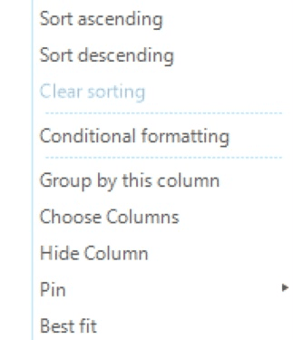

The Column context menu is the same for all column header cells in a table (Figure 28). It provides access to the following set of options:
Sort ascending
Option to sort the selected column in ascending order.
Sort descending
Option to sort the selected column in descending order.
Clear sorting
Option to clear any sorting from the selected column.
Conditional formatting
Option to open a window where the user can set the rules for formatting the content of the columns based on specific rules. See later on for more details.
Group by this column
Option to group the entire table based on a selected column. The table can also be grouped by pressing the left mouse button and dragging the selected column above the table headers. The table can be ungrouped by dragging the grouped column back to the header row. Multiple cascading groups can be created.
Choose columns
Option to open a window with all the possible column entries for the current table. The user can add the column entries by double-clicking on the column entry names.
Hide column
Option to hide the selected column in the table.
Pin
Option to unpin or pin to the left or right side of a table the selected column.
Best fit
Option to adjust all columns width.

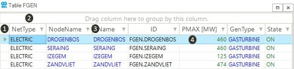

column header table 00
Figure 28. Column context menu for a table.

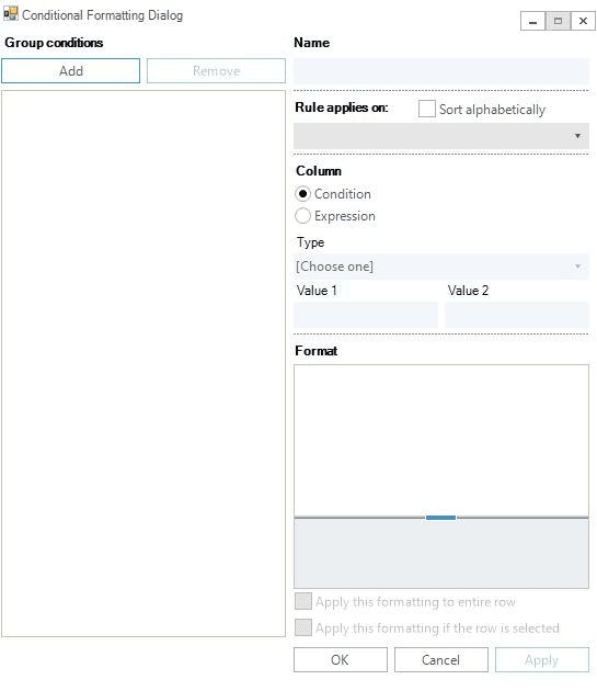

Conditional formatting allows the user to selectively format and style the content of rows and cells based on specific conditions and expressions (Figure 29). Multiple rules can be defined or removed from a table. Each rule must have a unique name, and must apply to a certain column. Rules must be developed based on predefined conditions (e.g., equal, greater, between value one and value two) or user defined expressions and involved up to two reference values. The user can format multiple aspects like the font used in cells and rows, the text alignment, the font color or the background color.
column header table 01
Figure 29. Conditional formatting window.

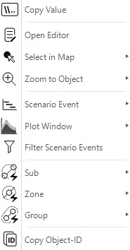

Finally, the Row context menu is accessed by right-clicking on any cell of a table (Figure 30). This context menu might slightly vary according to the cell selected.
cell context menu 00
Figure 30. Example of the cell context menu for an event table.
In general, Row context menu provides the following options, and have other object related entries:
Copy Value
Option to copy the value of the selected cell.
Open Editor
Option to open the property editor for changing properties associated to the object link to the row of the table.
Select in Map
Option to select the object link to the cell in one of the opened map view windows.
Zoom to Object
Option to select the map view window where to zoom to the object linked to the selected cell.
Scenario event
Option to select from a list of possible events an option to add the object in the active simulation scenario.
Plot Window
Option to select the chart to create based on a list associated to the type of object selected.
Filter Scenario Events
Option to create a filter to create subsets of events.

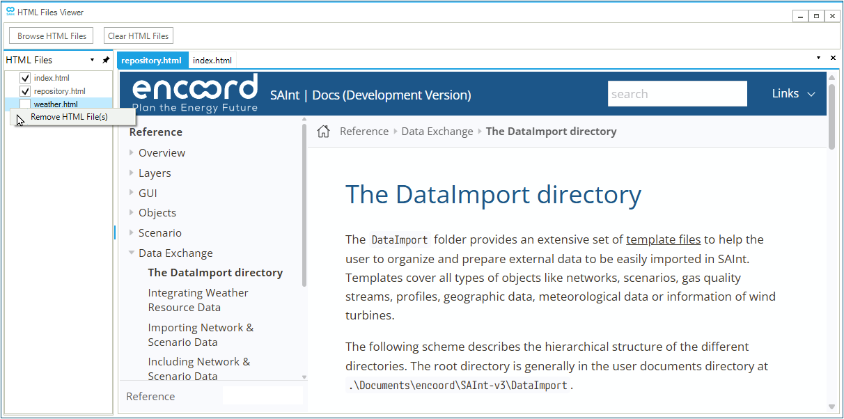

3.5.3. The HTML Viewer
The "HTML viewer" is accessible from the tab "View" and the menu entry HTML Viewer in the panel "Window". It provides the user with a SAInt built-in browser to visualize HTML documents created by running plugins, by exporting tables or pages downloaded from the World-Wide Web.
Figure 33 shows an example of the viewer after loading three pages called "index.html", "repository.html", and "weather.html". The user can load locally saved new pages using the button Browse HTML Files, while the button Clear HTML Files removes all loaded pages from the viewer. Available pages are listed in the window "HTML Files". All ticked documents are loaded as single pages and displayed using different tabs on the right side of the viewer. An unticked document is a loaded page which is not displayed (e.g., page "weather.html" is loaded in the viewer but not visualized). The active page has its tab in blue, while loaded but not active pages have their tab in gray. The user can switch between loaded documents by clicking on the relevant tab. Pages can be removed from the viewer by using the context menu (i.e., by right-clicking) entry "Remove HTML File(s)". And multiple pages can be selected by left-clicking the mouse while holding the "shift" or "CTRL" key on the keyboard. Finally, the black triangle icon and the "x" icon on the top-right of the area where a HTML page is visualized allow to select the active page from a drop-down list, and to close a page in the viewer (i.e., it is the equivalent of unticking the page from the list on the left).
html viewer
Figure 33. Example of teh "HTML Viewer" with three pages loaded and two visualized. The option "Remove HTML File(s)" is available from the context menu after a right-click on any entry in the "HTML Files" list.

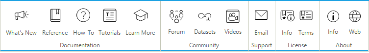

help tab 00
Figure 35. The Help tab of the ribbon bar.
