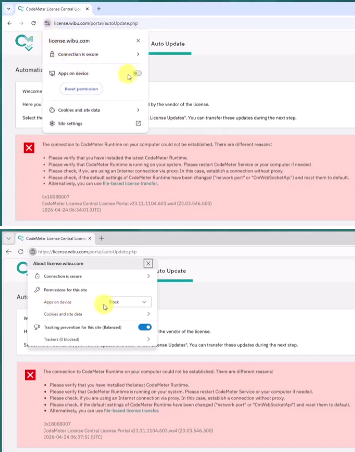

9. Direct License Activation and Browser Security Permissions
Starting with release 147, Google Chrome introduced a new security requirement: users must explicitly allow the browser to connect to locally installed applications and services. This affects the connection between the user’s browser and the locally installed CodeMeter (CM) runtime, which is required for direct license activation into a CodeMeter dongle or CodeMeter act license via "CodeMeter Web Depot" or "CodeMeter License Portal". The same security behavior applies to Chromium-based browsers including Microsoft Edge. Other browsers are expected to introduce similar prompts.
Once you open the "Auto Update" page of "CodeMeter License Central" in Chrome or Microsoft Edge, and you want to (1) activate a license directly or (2) perform an auto update with a connected CodeMeter container, you may get an error stating "The connection to CodeMeter Runtime on your computer could not be established. There are different reasons: …​" and you are redirected to the "File-based license transfer" page (Figure 9).
To address this problem, you can switch manually to the "Direct License Transfer". In the page showing the error, first check whether access to apps on device is blocked in the browser settings. If it is blocked, right-click the icon next to the web page address in your browser, and, in the "View Site Information" window, change the "Apps on device" option to "Allowed". Refresh the page. This enables the browser to establish the required local connection with "CodeMeter Runtime".
If it is still not working, check that the "CodeMeter Runtime" is running and your antivirus does not block the connection.
If this is the first time you open the "CodeMeter License Portal" page after this browser security change has been introduced, Chrome or Microsoft Edge will ask whether the website is allowed to access other apps and services on your device. Select "Allow". This grants the required permission and allows "CodeMeter License Portal" to communicate with the locally installed "CodeMeter Runtime". If the setting was blocked by mistake, you can correct it later in the browser’s site settings.
If the connection still cannot be established, please contact our support team at support@encoord.com for additional guidance.
trouble browser 01
Figure 9. Switch on the option "Allowed" for "Apps on device" in Chrome (top) and Microsoft Edge (bottom) when the error for the connection to "CodeMeter Runtime" appears.
