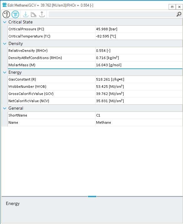

A gas component has a set of physical and energy related properties. As an example, Figure 2 shows the properties for methane. Please, note that the properties of the components in the built-in library cannot be edited. The user can only modify the properties of user-defined components.
create gas component 00
Figure 2. Example of the properties of the gas component methane (C1).
