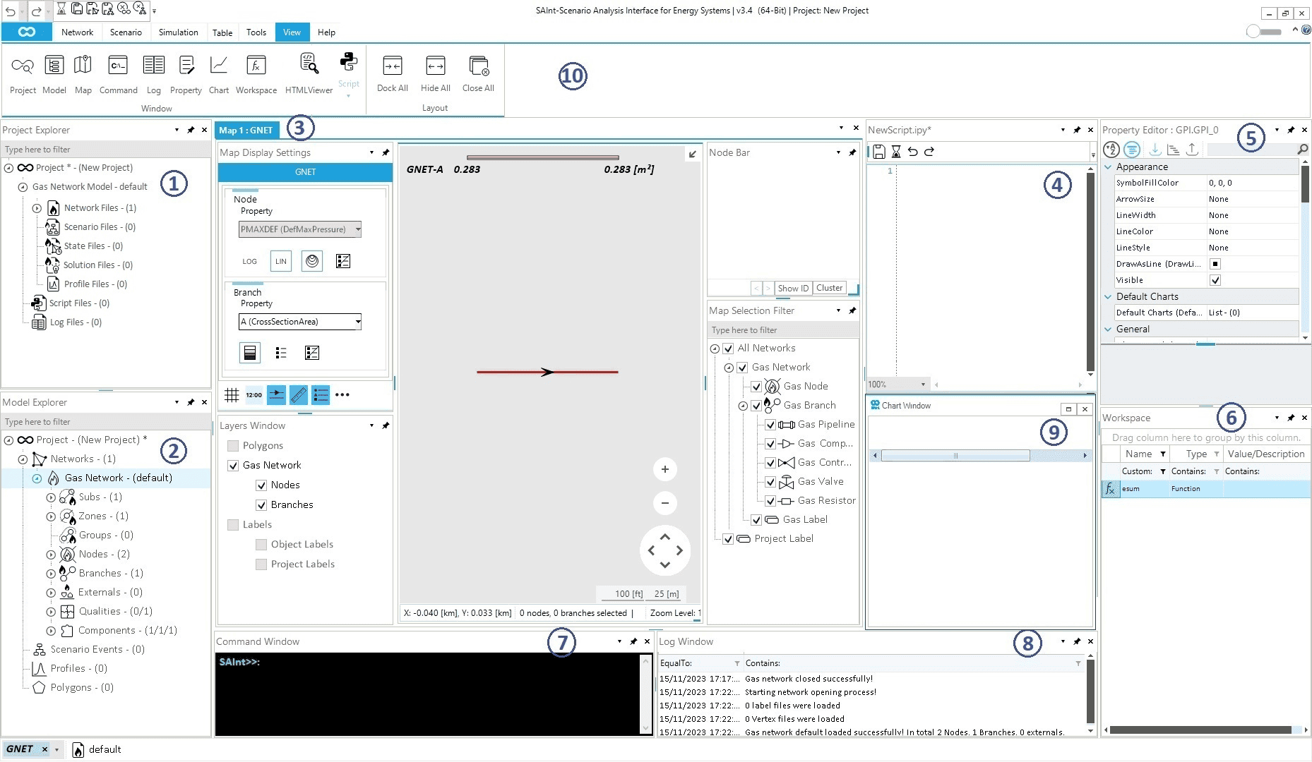

The section describes the controls and options included in the dock panel of SAInt-GUI. The dock panel consists of (Figure 1):
  • the project explorer (1): to manage all the file resources related to the active project.
  • the model explorer (2): to access objects and model-related data of the networks in the project.
  • the map window (3): to display a network, scenarios, and results in tabular form.
  • the script editor (4): to develop scripts in IronPython to interact with the model and the results.
  • the property editor (5): to display the full set of properties of a selected object.
  • the workspace (6): to have a list of functions to be used in the command window or in an IronPython script.

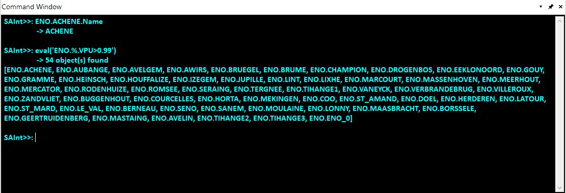

  • the command window (7): to interact with SAInt core using a command line interface.
  • log window (8): to record and log actions performed by SAInt and simulation or optimization messages.
  • the chart window (9): to display charts of properties and results.
The elements of the dock panel can be controlled either at the element level or from the entry View of the ribbon bar (see number 10 in Figure 1).
dock panel overview
Figure 1. Main elements of the dock panel of SAInt-GUI. Numbers indicate: (1) the project explorer, (2) the model explorer, (3) the map window, (4) the script editor, (5) the property editor, (6) the workspace, (7) the command window, (8) log window, and (9) the chart window. Number (10) indicates the entry View in the ribbon bar from where the user can control the previous windows.

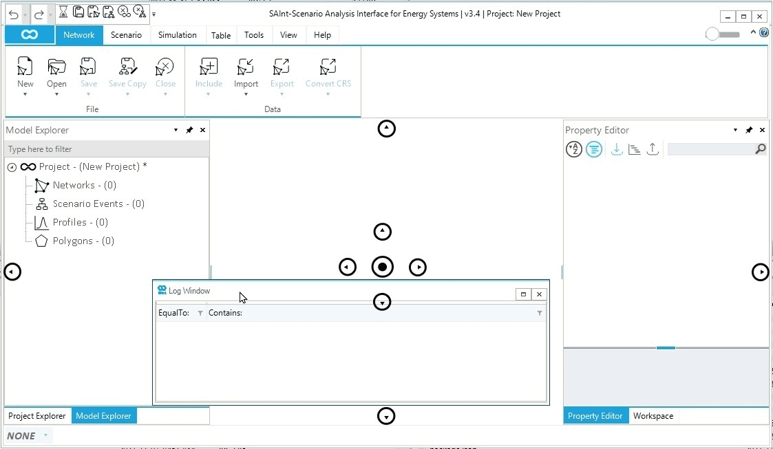

The user can interact with the windows by using the mouse on the title bar and:
by holding the left button pressed
The selected window can be dragged to a new position. SAInt shows marks on the other windows to suggest docking actions and positions, like in Figure 2. The window can also be positioned on a different screen to take advantage of a multi-screen layout.

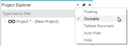

The user can change the docking mode of each window to floating, dockable, hide, auto-hide, or tabbed document, as shown in Figure 3. The docking modes can be selected by using the downward arrow button (located on the right of the title bar) or right-clicking on the title bar. The available options are:
  • Floating: Pops out the selected window in a floating state. The user can then drag the floating window to the desired location.
  • Dockable: Docks the selected window to its default location on the SAInt-GUI.
  • Hide: Hides the selected window from the SAInt-GUI. The user can re-open the hidden window from the view tab.
  • Auto-hide: Auto-hides the selected window in the SAInt-GUI. The user can hover and click on the icon of the hidden window to dock it.
  • Tabbed: Makes a new tab for the selected window.

Figure 3. By left-clicking on the triangle-shape icon of the title bar the user can change the docking mode of the window.

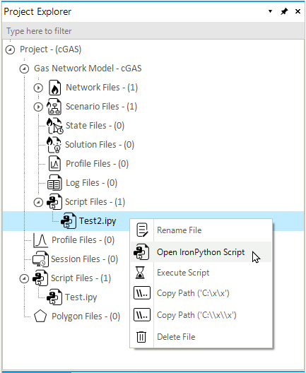

When right-clicking on a child of an entry, a context menu opens with a set of options allowing the user to (1) open the file with the property editor, (2) copy the path using Windows or Unix style, (3) rename the file, (4) delete the file, or (5) open, close or include the file. When a file is deleted, it is not moved to the operating system trash bin but removed from the files system. Please, remember that SAInt does not provide for an undo capability. Be careful with what you delete.
The context menu for IronPython script files allows also to directly open the script in the editor or to execute the script (see example in Figure 4). Scripts have multiple entries in the project explorer tree: one entry lists the scripts in the project folder and another entry lists the scripts in the folder where a certain network is saved.
The entries in the hierarchical list can be expanded or collapsed by clicking on the triangle to the left of the entry name.
The active scenario and networks are indicated by using a bold font.
Below the title bar of the project explorer window, there is a gray text box providing searching and filtering functionalities for the files reported in the hierarchy of items.
The file extension for a project file is *.prj. Only one prj file is possible in a project directory.
project explorer 01
Figure 4. Example of the "Project Explorer" window for a gas network named cGAS, with one scenario, one state file, one log file and two IronPython scripts. The option of the context menu for the selected IronPython script are shown.
The entries in the project explorer have different options accessible from their context menu. Figure 5 shows examples of the context menu for different items. Other possible options are also available when the entry is active and loaded in a session. The most common operation is to copy the path to the file of the entry, load it in the active session, or delete it from the hard drive.
project explorer 02
Figure 5. Example of the context menu for different elements of the project explorer (from top-left to bottom-right): project entry, model entry, network file, any scenario file, any state file, any solution file, the polygon entry, any profile file, any log file, and any IronPython scripts.

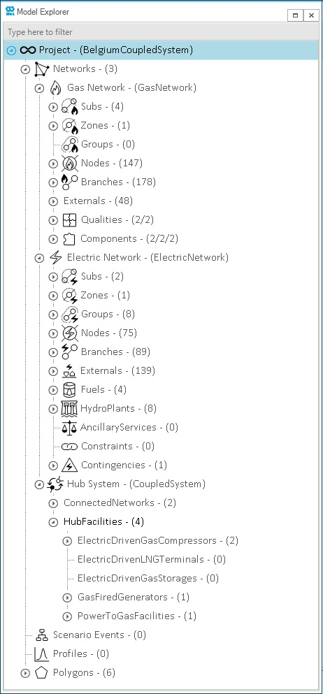

3. Model explorer
The model explorer is accessible from the model explorer tab located on the left-most window of the SAInt-GUI. It allows access to objects and model-related data of the networks in the project. Objects are presented in a hierarchical tree by object type (e.g., subs, zones, groups, nodes, branches, externals) and network type.
The model explorer is structured to show (see the example in Figure 6):
  • Networks: the entry provides a list of networks included in the project, and for each network, a list of subs, zones, groups, nodes, branches, or network specific objects (e.g., qualities for gas systems or fuels for electric systems). When a hub is included in the model, the entry reports the list of networks participating in the hub system and the list of hub facilities.
  • Scenario Events: the entry lists the events of the active scenario for each network.
  • Profiles: the entry lists the profiles used in dynamic simulations or optimizations for each active scenario.
  • Polygons: the polygons loaded with the project are listed.
Clicking on the triangle to the left of a parent object name will expand or collapse the child objects.
The presence of an asterisk next to the entry name indicates that the object has not been saved yet.
The number next to a parent object’s name (e.g., branches (147) under "Gas Network" in Figure 6), indicates the total number of associated child objects. However, the numbers next to the qualities and components for a gas network give the following information:
  • Qualities - (1/1): The first number indicates the number of qualities assigned to gas supplies in the network, while the second indicates the number of assignable qualities.
  • DEFAULT - (1/1): The first number indicates the number of components with %-Mol > 0, while the second number indicates the number of components included in the supply qualities defined in the network (In this example, the defined supply quality is DEFAULT).
  • Components - (1/1/1): The first number indicates the number of components (e.g., methane, hydrogen) with %-Mol > 0 in at least one assignable quality, while the second number indicates the number of components with %-Mol > 0 in at least one quality assigned to a gas supply. The third number indicates the total number of available components.
model explorer
Figure 6. Example of the "Model Explorer" window for a project with a gas system, an electric system, and a combined system.

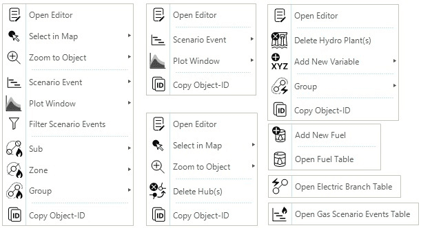

3.1. Context menu in the model explorer
The model explorer allows quick access to object properties or functions by context menus. Right-clicking on an object (parent or child) opens the context menu. The content of the context menu depends on the type of object selected. Figure 7 shows some examples of context menus for network and scenario objects. In some cases, only one option is available, like "Open XXX Table", where XXX is the parent object container of simple objects (see examples at the bottom-right corner of the figure). In other cases, the context menu allows the user to add, remove, and modify the object and its properties. In many cases, it is possible to select the object in the map view, zoom to the object in the map view, open the property editor, or copy the object identification code. Figure 7 displays an example of a context menu for a generic generator (network mode).
context menu
Figure 7. Context menu examples for network and scenario objects.
The context menus are different when scenarios are loaded compared to the ones when only networks are loaded.
The more common context menu options for network objects, except those specific to a single network object type, are described below.

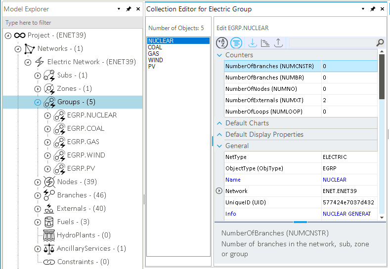

3.2. Collection editor
In the context menu, accessible by right-clicking on any grouping entity in the model explorer (e.g., entry for subs, groups, external, any type of branch, etc.), it is possible to select Open X Collection Editor, where x is the selected grouping level. The collection editor provides an alternative way to edit that is different from the combination map view/property editor, model explorer/property editor, or tables. It combines the property editor with a list of members of the group selected. It combines the property editor with a list of members of the group selected (Figure 8]).
collection editor
Figure 8. Example of the Collection Editor for the groups of an electric model. In the editor window, a list of the members of the collection is provided on the left, while the property editor is available for the selected member of the list on the right.

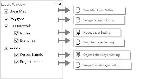

  • the Layers Window (3): the visibility of all graphical objects, like labels or polygons, and of all model objects, like branches and nodes, can be turned on/off or personalized using layers.

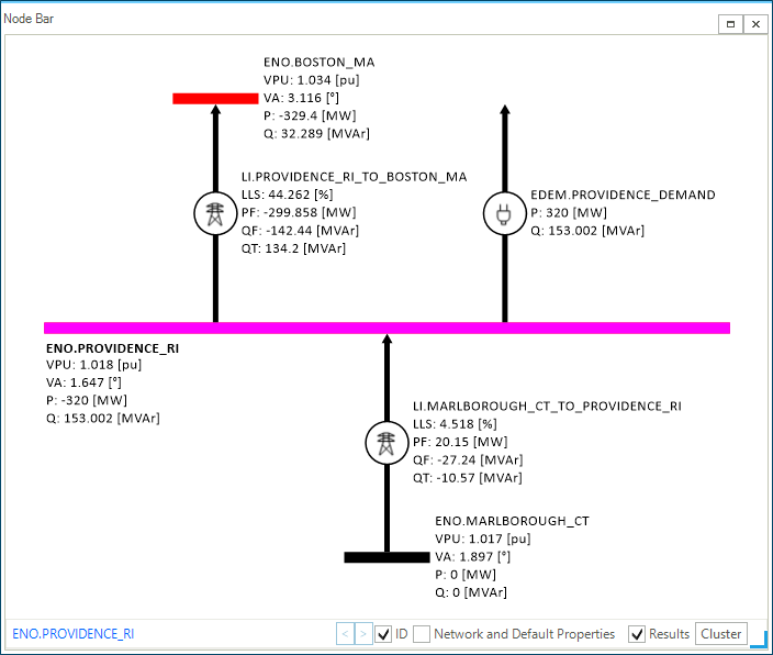

  • the Node Bar (4): it allows to see and access externals and branches connected to a selected node.

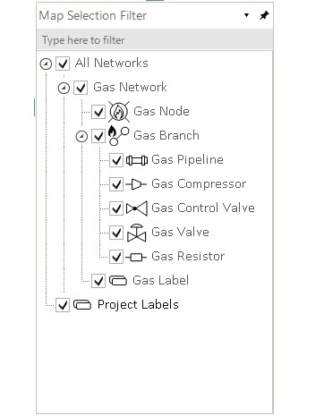

  • the Map Selection Filter (5): you can restrict the selection of model components or labels by turning on or off the associated type in the "Map Selection Filter".

4.3. Layers window
Graphical objects, like labels, or modeling objects, like nodes, are displayed on a map view using layers, similar to raster or vector image editing software. A layer groups objects of the same type and provides a single entry point to common graphical properties.
Layers are accessible from the Layers Window and depend on the type of map window (i.e., Cartesian or geographic), the number of networks loaded, and the availability of polygons and labels. Figure 20 (left) shows an example of a layers window for a geographic map view with one gas network (with its node and branches), a base map, polygons, and both object and background labels.
From the layers window, the user can quickly turn on/off the layer global visibility or, by right-clicking, access the context menu (Figure 20, right) of the layer and modify relevant graphical properties of the set of objects. The available context menus are:
  • Base Map Layer Settings: the user can modify the map provider (MapProvider) used for the base map. A valid key for the map provider’s API must be specified in the "Miscellaneous" section of the general settings of SAInt. The setting specified for each map view can be saved and later restored from a saved session.
  • Polygons Layer Setting: the user can modify the appearance of polygons by specifying the line style (LineStyle), the stroke width (StrokeWidth) and the color (LineColor) of the boundary, as well as the fill color (FillColor) of the polygons (Figure 22).
  • Nodes Layer Setting: for each network in the map window, the user can modify the appearance of the network’s nodes by specifying the size of the node symbol (NodeSize) and its stroke width (StrokeWidth) (Figure 23). The border color of a node is conventionally pre-defined in green (only supply externals at the node), red (only demand externals), and orange (both demand and supply externals). Refer to the section Map display settings for personalizing nodes when a solved scenario is available.
  • Branches Layer Setting: for each network in the map window, the user can modify the appearance of the network’s branches by specifying the size and color of the branch symbol (which depends on the type of network), the line width (LineWidth) and style (LineStyle) of pipelines and electric lines, and the color and size of the arrow symbol used in the map view or in an animation (ArrowSize, AnimationArrowSize, ArrowColor) (Figure 24).
  • Project Labels Layer Setting: the user can control the graphical properties and placement behavior of project labels by changing border and fill color, transparency, font attributes, framework type, and size, and zoom range (Figure 25, left).
  • Object Labels Layer Setting: the user has the same level of control for object labels as for project labels. With the exception of the callout (LabelOriginLine), project and object labels share the same properties (Figure 25, right). For more details refer to the section Labels and label properties. For more details, refer to the section Labels and label properties.
Finally, it is possible to use the layers window to quickly re-center the map view to display the full extent of one of the loaded networks. Just double-click with the right mouse button on the entry "Gas Network", "Electric Network", or "Thermal Network" to center the map view to that network. On the other hand, by clicking with the mouse wheel in the map view, the extent is refresh to show all loaded networks.
layers window 00
Figure 20. Example of the "Layers Window" with one gas network, a base map, polygons, and object and background labels. On the right, the context menu accessible by right-clicking on the entry on the left.

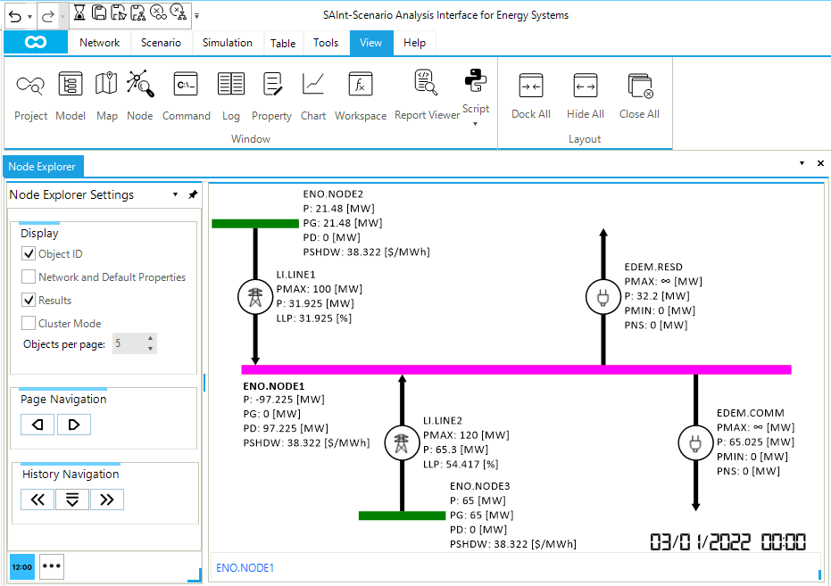

4.4. Node bar
The node bar displays externals and branches connected to a node selected in the map window. The user can choose different display options of the node bar using the Id, Network and Default Properties, Results and Cluster located on the bottom right of the node bar window. The first option labels each element in the node bar with its full identifier. The second option displays a set of default properties for the objects in the network. The option " Results" allows showing a set of results from a successful analysis, after a simulation or optimization is executed. When the option "Cluster" is selected, all results and properties are removed and objects are grouped into classes so that it is possible to identify which type of elements are linked to the node of interest. An example is shown in Figure 26. The node bar window is generally located on the right side of the map window. By default docked.
By right-clicking in the node bar window, when no node is selected, allows the user accessing a context menu where three properties of the window can be changed. The user can (1) select the background color, (2) hide/show all connected branches to the selected node or (3) hide/show the connected externals.
In the bottom-left corner of the node bar window, SAInt reports the name of the selected node in blue (see ENO.PROVIDENCE_RI Figure 26 for an example).
The node bar shows only details of the node selected in the map view and not from the model explorer or the node table.
Horizontal segments represent nodes. The main central line is the selected node. The short segments at the end of the vertical lines are other nodes connected by branches. The color of the horizontal line follows the rule: red if the node has only demand externals linked, green for only supplying externals, orange for a mixed situation, and black when no external is connected. When an element is selected (by clicking on it), it is highlighted in purple. A right-click on a selected element allows to access a context menu with the set of options based on the object (like open the property editor, select it on the map, create plots or add events).
The properties to be shown when Network and Default Properties or Results are selected can be personalized from the "Default Display Property" tab of SAInt general settings.
By double-clicking on any of the horizontal segments indicating a node connected by a branch to the selected node, it is possible to navigate to that node and update the node bar by showing the details of the landing node and its connections. In this way, it is possible to navigate the network without using the map view.
Each element connected to a node is also associated with arrows. For branches, a double-headed arrow indicates the direction from the FromNode to the ToNode. For externals, a double-headed arrow indicates a link with an object that can inject and withdraw energy from the selected node (e.g., a gas storage or a battery). While a single-headed arrow points in the direction of injection (i.e., towards the selected node which is the central horizontal line in the node bar) or of withdrawal (outward compared to the selected node). When a solved scenario is loaded, the direction changes meaning and always indicates the flow of the energy carrier.
map window 02
Figure 26. Example of a "Node Bar" window with "ID" and "Results" active (after loading a successful simulation). In an electric system, the node ENO.PROVIDENCE_RI is selected. The node has one electric demand EDEM.PROVIDENCE_DEMAND and it is connected to the system by two electric lines (one towards a neutral node named ENO.MARLBOROUGH_CT, and one node with demand external named ENO.BOSTON_MA).

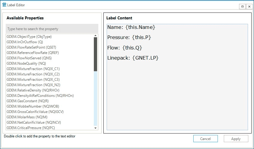

Labels are a flexible tool to display properties or results for a specific object (i.e., an "object label" or a "network label") or to add text and information to a map window (i.e., a "project label"). The user can simply add a label to an object from the context menu with Add New Object Label To after selecting the object. Or add a network or project label to a map view using the context menu after right-clicking in any area of the view away from objects.
A "project label" only accepts free text. Compared to object or network labels, the syntax used for extracting and displaying properties or results is not interpreted but is considered as a normal string. Furthermore, a project label is not linked to any network, so it is displayed even when there is no network at all. For this reason, project labels are great for having informative text describing your project.
For more details, check the How-to guides "Add Labels" and "Edit Labels".
Once a label is added, it is possible to personalize its content and graphical appearance through the property editor. The user can access the property editor for a label either by selecting the label if a property editor was already open or by right-clicking on the label and from the context menu select Open Editor. Figure 28 shows an example of the property editor for a label linked to a GDEM object. The user can modify:
  • the appearance of the frame around the label by setting the stroke width (StokeWidth under Appearance);
  • the fill color of the label frame (FillColor under Background);
  • the color and visibility of the label frame, along with the type of corners (i.e., round or sharpe)(FrameColor, LabelFrameVisible, and RoundLabelFrame under Content);
  • the size of the frame for height, width, and aspect ratio (Width, Height, and KeepAspectRatio under Size);
  • if the frame has a callout to the object linked to the label (LabelOriginLine under Reference). The option to have line connecting the label to the object is only available for labels linked to nodes, externals and branches, but not for project’s or network’s labels;

The LabelInfo property under Content allows the user to modify the default content of any label. By clicking on the three dots next to the string content of the LabelInfo property, the Label Editor opens (Figure 29). In the label editor, the user can mix free text with tags for the object’s properties and results of simulations. On the left side, a filtrable list is available with all properties and results for the object type the label is linked to. On the right side, the user can compose the content of the label using a simple syntax. Properties or results are indicated by {this.PROPERTY} where the object is either explicitly mentioned or implicitly referred to using the pointer this (i.e., it indicates the same object linked to the label). A property is indicated using the property symbol in SAInt. It is possible to indicate the unit of measurement for the selected property even if different from the one specified in the general settings of SAInt. The syntax of the tag requires that the fields used are separated by a dot and within curly brackets as in {this.XXX.YYY.[xxx]}. In the example of Figure 29, the label for this GDEM object will show the name of the demand external, its pressure, the outflow, and the network linepack on four different lines. All numeric values use the project settings units of measurement and are valid for the active simulation time step or network state.
For details on how to use the label editor and examples of label syntax, refer to the How-To guide Edit Labels.
label editor
Figure 28. Example of the personalization properties a user can modify from the property editor for a label linked to a XGEN object.
label content
Figure 29. Example of the label editor for a GDEM object showing the name of the external, the pressure, the outflow, and the network’s linepack for the active time step - or network status - and using the project’s settings units of measurement.

The script editor is accessible from the tab "View" and the menu entry Script. The user can either create a new script using the option Create New IronPython Script or load an existing script using Open Ironpython Script. The script editor allows the user to create and save customized codes using IronPython functionalities. Similar to the command window, it uses the IntelliSense feature to guide the user in entering the commands. Lines are numbered for convenience, and different colors are used to help the user to navigate the code and quickly recognize the type of command used. An example of using the script editor is shown in Figure 30.
script editor
Figure 30. Example of the use of the "Script Editor" with an IronPython script named "PlottingCommands.ipy" for user-defined nplot commands.
In the top section of the script editor window, four customizable buttons are available for a quick access to the following options:
Execute script
Executes the current script. SAInt objects referred in the code are accessed based on either the active time step or the solved solution for the active scenario.
Save script
Saves the current script with *.ipy extension.

The property editor is accessible from the window "Property Editor" located on the right-most window of the SAInt-GUI or from the tab "View" and the menu entry Script in the tab "View". The property editor allows the user to edit all types of properties of a network’s object or a scenario’s event. The editor filters the list of properties depending on the type of selected object or loaded scenario.
Figure 31 shows examples of the property editor window when an object (left, center) or a scenario event are selected (right). The figure shows how the property editor window is divided into three areas: the toolbar at the top, the "table" section in the middle, and the "information box" at the bottom.
property editor
Figure 31. Examples of the "Property Editor" window when the "input property" section for an object is selected (left; in this case is the gas node GNO.CGS_03), or when the "event properties" section is selected (center, a solution is also loaded), or when the "input property" section for a scenario event is active (right). In all cases, the window is dived into toolbar (top part), table section (central part), and information box (bottom part).
The toolbar has two buttons (i.e., first two icons on the left), three tabs and a search bar, as shown in Figure 32. By hovering the pointer over the tabs a description is displayed. The available options are:

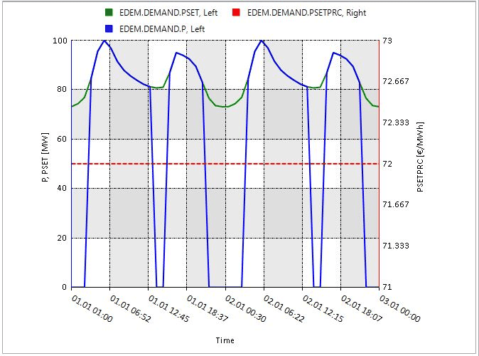

SAInt has two types of charts: plots for an object’s properties and plots for events associated with it. From an entity’s context menu, it is possible to clearly choose between "Plot Window" for the first type and "Plot Event" for the second type. See Figure 40 for an example.
In the "Plot Window" class, SAInt provides the user with the option of creating and personalizing a "Default Plot" for the selected object. Default plots can be changed by modifying the linked plotting command from the general "Settings" ("Default chart"). The user can change any default chart with a new one, or modify the colors, the legend and title, or the type of chart for a specific property. The default charts can be saved to an external file and restored from an external file.
context menu chart
Figure 40. Example of the "Plot Window" entry in the context menu of an object (left) and example of the "Plot Event" and "Plot Window" in the context menu of an event selected in the event table (right).
The "Event Plot" class is available only for events. Depending on the type of network and the type of event, the event chart has a specific graphical output. In an event plot the user can see all or some of the following elements (Figure 41 and Figure 42):
  • time annotations with some vertical text, which can be toggled on or off from the chart context menu. There are different types of annotations:
    • the scenario start time indicated by a vertical annotation stating "ScenarioStartTime" followed by the date and time.
    • a profile start and end time by vertical annotations stating "ProfileStartTime" and " ProfileEndTime" followed by the date and time. The user can see the actual time span of the original data of a profile.
    • the event start time is indicated by a vertical annotation stating "EventStartTime" followed by the date and time of the event.
  • axis:
    • the horizontal axis is always representing time.
    • the left vertical axis describes either the control modes of the object associated with the event or the user-specified values for the event. When the control mode is plotted, the state of all events in the scenario for the same object is reported.
    • the right vertical axis describes the event’s values (or the value multiplied by a profile) if the left vertical axis is describing the control modes.
  • graphical elements with a color-coded meaning:
    • when present, a "green" line indicates the user-specified "value" for the event (or the value multiplied by a profile) in the time window defined by the "event start time" up to either the end of the scenario or to the next event for the object. The plotted values are not to be confused with the actual computed values by SAInt, as the two sets may be different because of constraints handling and penalty prices.
    • a "blue" line indicates either the sequence of events associated to the object in the active scenario or the user-specified "value" for the event (or the value multiplied by a profile). The user-specified values are present only when the event has no control mode associated. Otherwise, the control mode is represented in blue, and the user-specified values in green. It is important to stress that the realized sequence of events or values during a simulation may be different from the planned in the scenario as constraint handling may occur.
    • for gas events, a "purple" line over the blue line indicates the portion of the chart referring to the selected event. If an object is associated to multiple consecutive events, SAInt indicates the section of the chart for the selected event used for creating the chart with a purple overlapping line to the blue line.
    • when present, a "pink" line indicates a user-defined default value linked to an object. This is useful for comparison. The default value is, generally, indicated with an axis on the right side of the chart.
    • for electric events, when present, a "red" line indicates the evolution of the event value before the selected event start time.
  • graphical elements with a style-coded meaning:
    • a continuous line indicates a sequence of (active or not) events or values as specified for a certain object in the active scenario. For example, a continuous line is expected to be used for green, blue or red lines.
    • for gas events, a dashed line indicates the time window in a simulation defined by the start time and the first user-specified event in the active scenario. This line pattern indicates what is inherited from the initialization state. This is equivalent to the use of a red line in charts of electric events. We avoided to add the red color to gas event charts to reduce the total number of colors.
event plots 01
Figure 41. Example of "Plot Event" for a POSET event for a gas control valve GCV.CV_1 object (top) and for a QSET event with a profile for a gas demand GDEM.CGS_08 object (bottom). The graphical elements in the charts demonstrate the set of rules valid for an event chart.
event plots 02
Figure 42. Example of "Plot Event" for a PSET event for an electric generic generator XGEN.COGEN object (top) and for a PHISET event with a profile for a thermal demand HDEM.N05 object (bottom). The graphical elements in the charts demonstrate the set of rules valid for an event chart.
